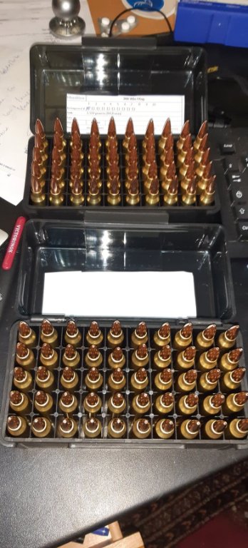

Reloading 100 ammo 300 winmag , low charge to pratice at range ...(218 & 328 yards)
Usage of 300win mag is controled in my club, too much power, can destroy target support :?
it's ok with lowest reload...
So i use Lapua scenar 167grs, with 72.5 grains of Vihtavuori N160 , bottom of scale...

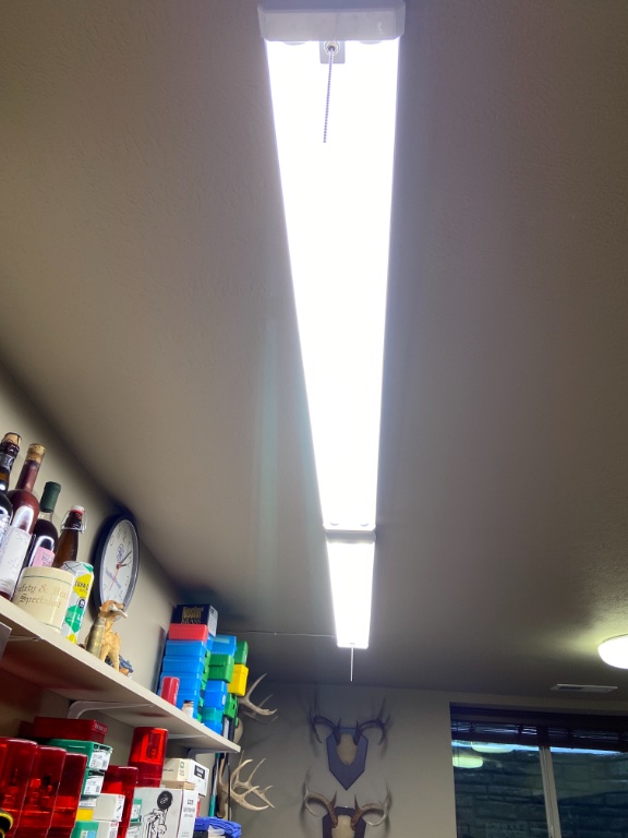

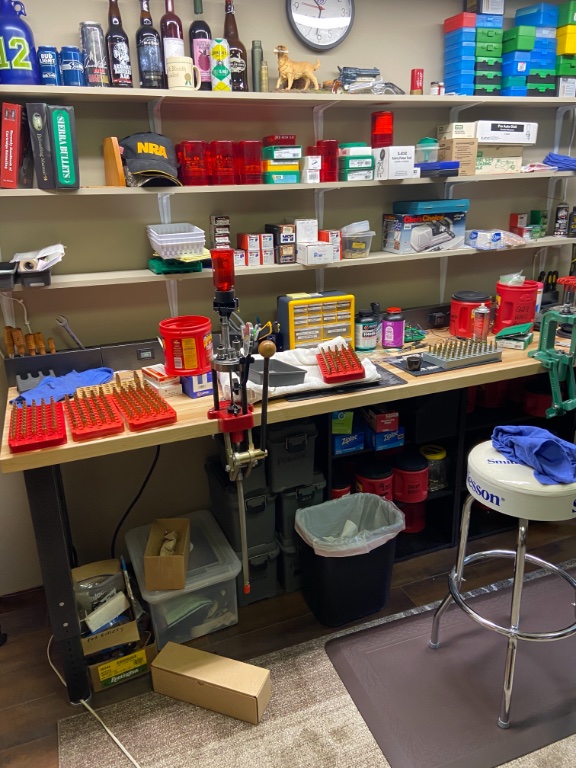

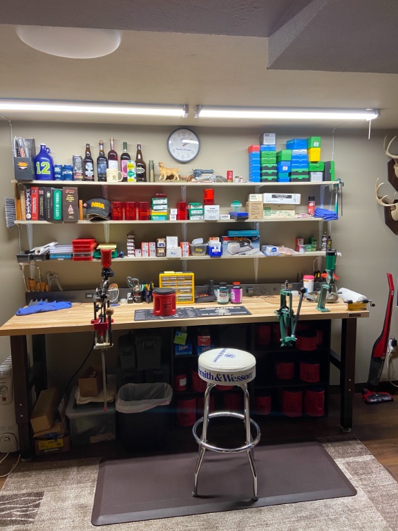

Didn’t do anything at my bench today but I did something above it.
Went downstairs to process some 7.62 brass and remembered I had bought some overhead lights that needed to be mounted. Plus my room was on the messy/un-organized side so I decided to process my room instead of the brass. I have two pretty bright lights in the room but they are on the ceiling behind me which casts a shadow of me when I’m working at my bench. I have been using two desk lamps with one on the bench and one a floor mount but they are always in the way. So I mounted these two LED lights I picked up at Costco and man do they brighten up my work area. No more shadows or portable lights in the way..... :D :D :lol:
Now, where’s that brass that needs to have the primer pockets swaged????????
Posts: 4014
Post by Rifletom » Mon Nov 16, 2020 6:48 pm
Lights be lookin' good there Hatch! Nice move.
Post by BigAl52 » Mon Nov 16, 2020 8:00 pm
Way to organize for a reloading room Hatch. I reloaded some 338 win mag shells at mine just last night

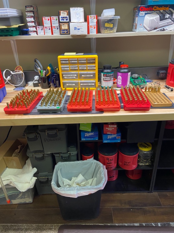

Yesterday and today I de-capped and swaged the primer pockets, wet tumbled and sized 158 7.62x51 pieces of brass and sized 100 .223 pieces of brass that I had swaged earlier. The 7.62 will be for my M1A and the .223 will be some dedicated ammo for my Mini-14. I’m going to work up loads for both so will start some ladder loading tomorrow. The 30 cal bullets are supposed to arrive sometime tomorrow and for the .223 I have everything on hand.

That Gladiator bench is fantastic. My reloading room is in the basement and my stairs have a 90 degree turn. I purchased the bench from Sears and it came un-assembled and packed in a large cardboard box that I was able to take down the stairs on a hand truck. Assembled it in my room which worked out perfectly. I ordered the optional back piece which comes with seven outlets and keeps items from rolling off the back of the bench.
