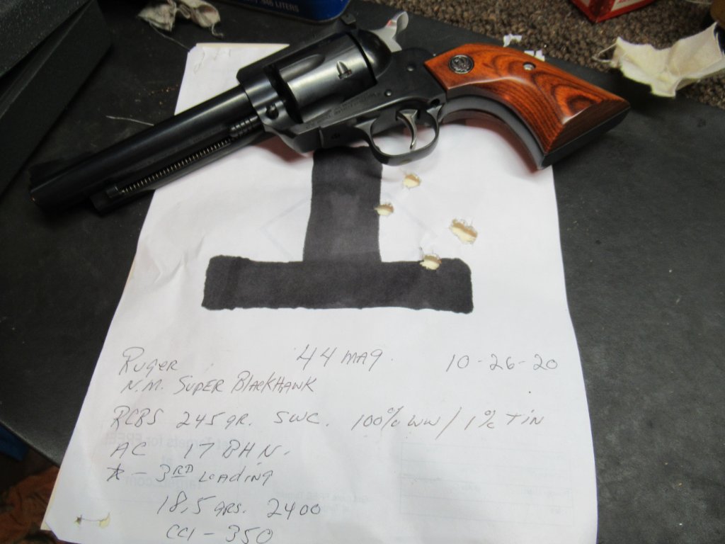

Mag primers worked great in my 44 mag yesterday with 2400. That's a 2 inch group at 25 yards. Had to use my left eye as my right eye has a cataract on it.See, even a blind squirrel gets a nut once in awhile. :D

I used them by choice since that was what I already had cases primed with because I was going to load up my Henry 44 mag loads with them but needed to shoot my Ruger yesterday. Since 18.5 was the stated starting load in the Lyman book, it proved to be safe in my revolver. Near max and I would not have used CCI 350's.

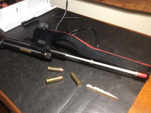

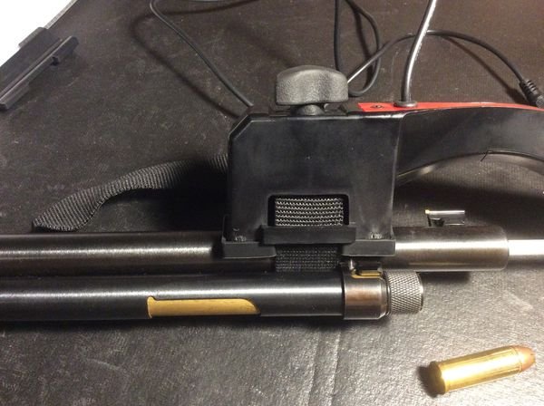

Got my 44 Carbine setup with the Magneto Speed to do the test with 180 gr XTP/ 2400 load using CCI 350 Mag primers.
Had to make up some .44 cal setup pucks for the rod and found out half of a clothes pin makes a great gap check gauge!

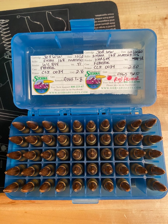

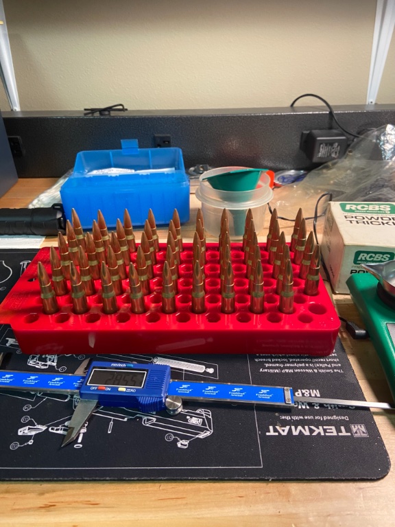

Today I loaded up 49 cartridges for a buddies .308 AR he just built. I had the bullets left over from when I used to shoot .308 in matches. (Sierra 168 gr Matchking Hollowpoints) The best powder for this load is Varget but as I have less than 2 lbs on hand and use it for my .223 match loads I was stingy with it. I loaded 40 with WC844 which is a military powder intended for .223. It is also used for .308 but is not particularly accurate with heavier bullets. WC846 is a better military powder for .308 with heavier bullets I understand but I have never used it. I did load nine rounds for him with my precious Varget so we can compare. I use the WC844 for my bulk 55 gr .223 loads that is just plinking ammo.
I reached out to him to see if he wants to head out this week. We have a range nearby that has steel out to longer ranges which is what he wants to do. Unfortunately this range is only open from 2:00 pm until dark and with the clock change this weekend we will lose an hour of shooting next week.
