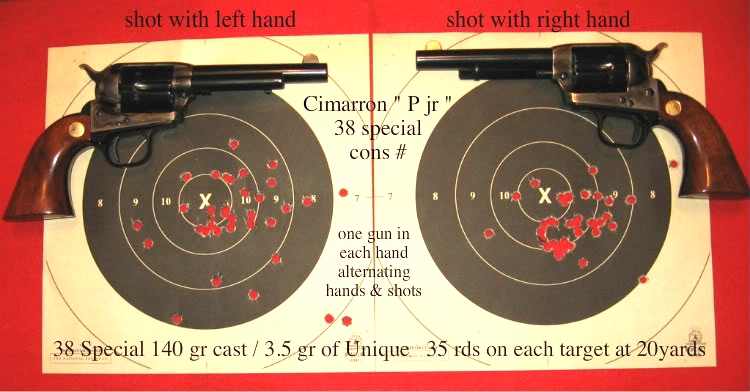

My SASS/CAS loads are real pussycat and they are only 750 FPS . Remember the are loaded for FPS not accuracy . 1lbs of Unique will load 2000 rds and they shoot good too . Pistols I shoot Gunfighter that is a gun in both hand and is how I shot the target below

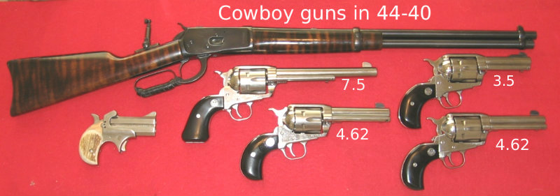

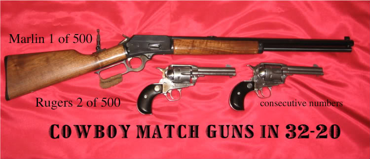

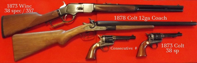

If you look at my avatar my SASS number is 7720 and SASS is now over 100,000 I believe . That is over 16 yrs . I was do this before long before I was a SASS member . Here is some of my SASS guns . My shotguns for years were Stevens SS hammerless and 1897 Winc ... Now it is the 1878 Colt hammer gun . I no longer can shoot SASS/CAS for the last few years because of my health , but don't ever feel sorry me I've done it all . Now I shoot pellet and BB guns and started with now slingshots too .Travlin wrote: How long have you been doing it?
