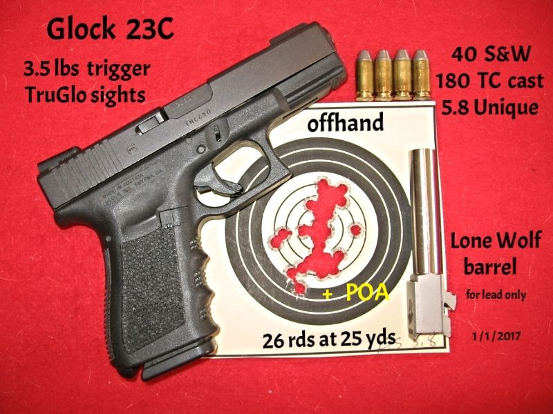

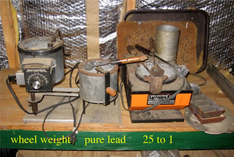

I make my own bullets and molds for my matches . Wheel weights I keep under 900 fps and no leading . 25 lbs lead to 1 lbs tin I keep under 1400 fps and no leading . I use the pure lead for muzzle loaders and I can drive them over 1600 fps but pure lead cast like crap . I find the harder the bullet the faster they lead . Here is the BEST book you can get below if you can find one and the Lyman book is a good one too

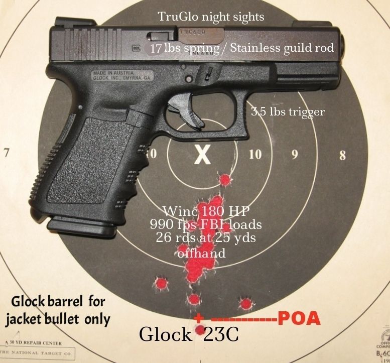

Polygonal rifled barrels, like Glock barrels can have issues if a lot of lead is fired thru them and then a jacketed bullet. If lead deposits are extremely heavy in the polygonal barrel then a jacketed bullet is shot thru it, pressure can spike and cause damage to the barrel or worse. But, that is after quite a bit not a few rounds.

Plated bullets are cast bullets with a thin coating of copper alloy LIKE sprayed on them . They are NOT copper jacket . Plated bullet were design too shoot in indoor ranges to cut poisons gasses down . For $100 you can get a Lone Wolf barrel to shoot cast or plated bullets and keep the Glock barrel for jacket bullets only . I'm not going to write a book on do's and don't of cast or plated bullets in Glock barrel . I know people who shot 1000's cast bullets in there Glock with no problems and I know 2 people in Tn that weren't that lucky . That is why I have a Lone Wolf barrels for cast bullets for my Glocks .
