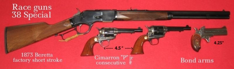

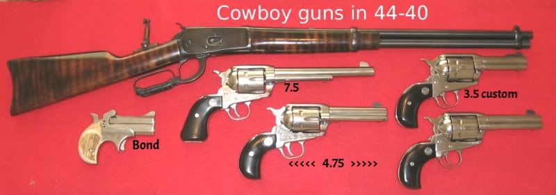

Post by tx gunrunner » Sun Apr 23, 2017 11:54 pm
You should starting cast your own bullets like I did for years . Below is some of my casting stuff I sold after casting for over 40 years .
