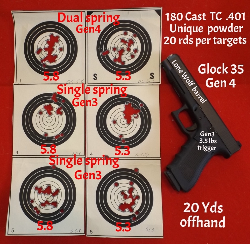

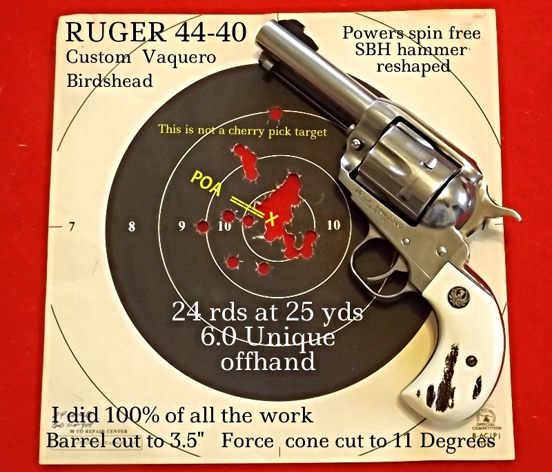

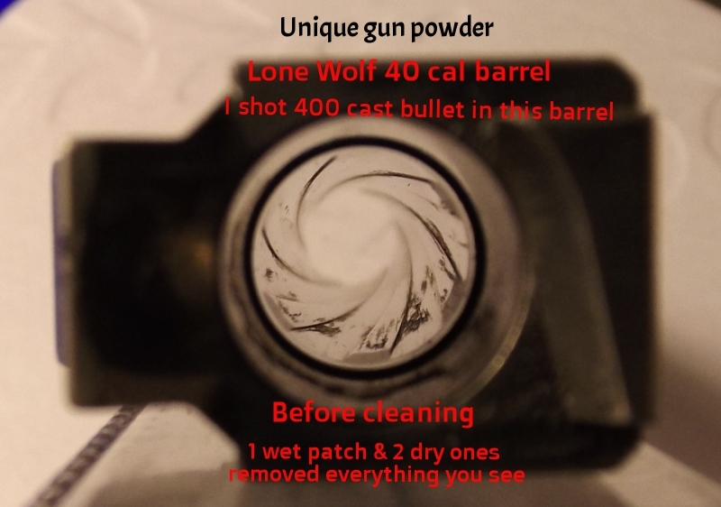

This is the short version the jacket bullet leave copper alloy fouling in barrel and lead sticks to this fouling and cause barrel to leaded up barrel very fast and this causes lead bullets to be very inaccurate . Plus it it very hard to remove lead from a leaded up bore . I have 2 barrels for all my Glocks . The stock [ original ] barrel for jacket bullets and I have a Lone Wolf just for lead bullet only . I have guns I shoot only jacket bullets in them and guns that only shoot lead bullet in them . Lead polishes a gun bore the more you shoot them the smooth they get . My 44-40 and Glock below have never had a jacket fire in them and only a wet patch and 2 dry clean the bore pefect .

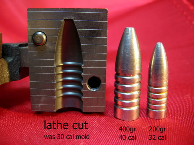

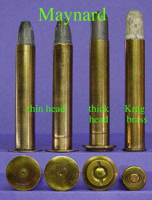

I built this rifle to shoot cast bullets only .. I won a lot of matches and trophies with this gun . I even make a lot of my bullets molds I shoot in my guns too . Here is 2 of them I make .

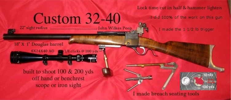

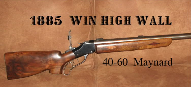

I've had a Lewis Lead remover for over 40 yrs .I only use the forcing cone tool for cleaning and polishing the forcing cone . .

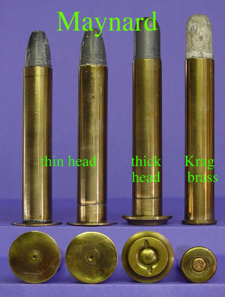

Here is the rifle I built for that 400 gr 40 cal bullet mold . You can't buy this brass you must make it . The 40-60 Maynard was sniper rifle in the Civil War and was one of the 1st cartridge in the Civil War

Post by JEBar » Thu May 26, 2016 10:28 pm
thanks for the picture and info .... moving to larger caliber, lead, high grain, slower speed bullets for hunting is an alien concept for me .... historically, I've used jacketed, high speed, flat shooting bullets .... when it comes to punching paper, I've always used whatever I could shoot the cheapest

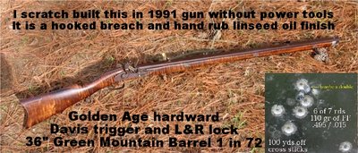

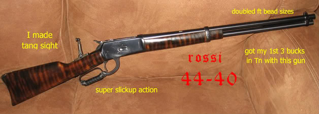

Post by tx gunrunner » Fri May 27, 2016 2:17 am
Some of my hunting guns when I was able to hunt . My patched round ball in muzzle loader runs almost 2,000 FPS and drops a Tn deer dear in it's tracks .

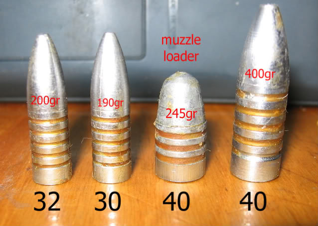

I chuck a old single cavity 30 cal bullet in a 4 jaw chuck and find center and then square up the mold which is the hardest part . I drill it for like a 32 or 40 cal . I made a tool to cut the nose and another tool to cut grease bands and another one for the rear band . My molds are cut to 4 different dia in each mold . And being lathe cut the are perfectly round and if they are center and square the bullets will fall out of mold . If there not square or centered you will need to beat them out like the mold that are cherry cut mold like Lee , Lyman and RCBS . Here 2 more I cut . Remember these bullets must be pan or hand lubed since each bullet band are different sizes to fit in a bore , free bore and rifling .

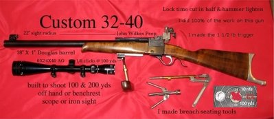

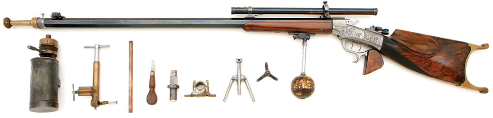

The rife was design to offhand shooting and it was little long for me to shoot offhand but it was super on the bench . It
fit my buddy Russ perfect who owns it now . I mirror my #3 to hold and feel like the Pope but to fit me . note the Pope type loading tool and palm rest. My ballard was like the in pic but no scope with all the tool and I had a the Pope nose pour bullet mold not pictured not pic .

Post by Travlin » Sun May 29, 2016 4:48 pm
Most Excellent work. Thanks for posting. I fear that your level of craftsmanship is almost lost . I am glad to see what a real gunsmith can do. Start with steel and a good piece of wood for a stock and end up with beauty and precision. The only other time that I have seen this level of skill was in the building of my friends two bore cartridge rifle. Thanks again for sharing and the photo of the the target.
