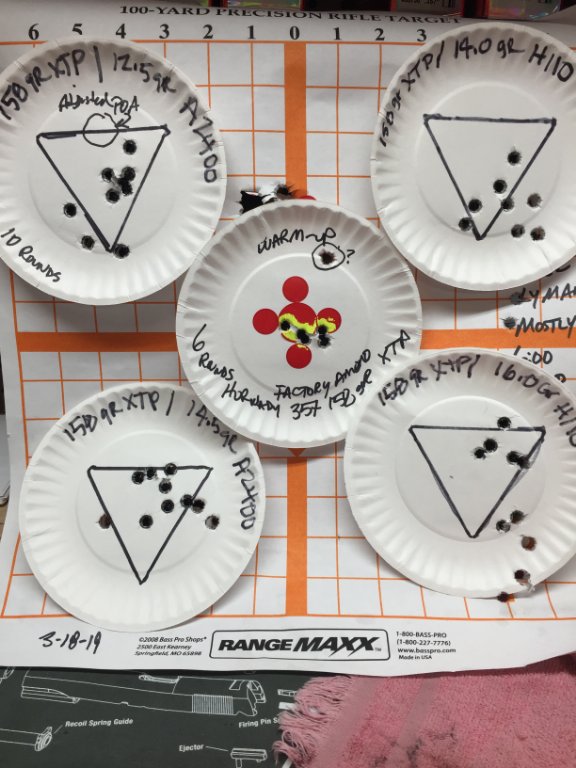

Went back for a second round of testing the 158gr XTPs through the BBS. As before, 50 yds, bagged, Leo VX Freedom 1.5-4X20 @ 4X.
Started out with the center target using factory Hornady 158 gr XTP 6 rounds total, 5 in the bull, plus the flyer). Always a flyer, right? Otherwise, very happy.
The powder tests were 10 round groups, stopping and reeling target in after Round #1, just to see where things stood.
Did the upper left first, 12.5 grains of Alliant 2400. Had to adjust POA to the top of the triangle (3") at the point circled. Once I got that figured out, they gave me similar groups to the factory ammo.
Next was lower left, 14.5 gr of A2400. Not bad on a 3" triangle.
Upper right next, with 14.0 gr of H110. Had the most difficulty adjusting to this variable, and generally "Meh."
Lower right is 16.0 gr of H110. Still not great.
My general direction will be to try to dial in the A2400 a bit more, with the objective being to end up with the "hunting load," but also plan to get outside with longer distances (75 and 100 yds) to see what works best. Will likely give up on the H110.
The other thing I'm concluding is that I"m spinning my wheels a bit without the benefit of a decent sled. I've resisted this so far, trying to make do with a pretty nice Caldwell "tack driver" front bag and a good rear bag as well. But, with all the shoot/retrieve target/shoot/move to next target, etc., it's just not possible for me to get very consistent in one session. This turns into a test with too many variables, the biggest variable being ME, constantly adjusting bags to different targets. For example, I don't think there's single powder variable target where I can clearly see all 10 holes.
Might have to revisit the Caldwell Matrix, which seems to have enough clearance to allow cycling the lever without a lot of other movement of the rifle.
As always, comments, critiques and suggestions welcome! It's all fun.

Evan, those two loads of 2400 look pretty good, as does the factory stuff. H110, meh. Lever towel duly noted!

Thanks, Tom. Have lots of 45 Colt loaded up, but have given up on the indoor range with the Peep Sight - lighting is too poor, so I'm just wasting ammo and making myself crazy(er) trying to make sense of it.Rifletom wrote:Evan, those two loads of 2400 look pretty good, as does the factory stuff. H110, meh. Lever towel duly noted!

I have never tested my .357 BBS with H110 but I really expected the 16.0 grain load of H110 to be more accurate.
I do not have a scope on mine but a couple of years ago, I spent time trying to find an accurate hunting load using 158 gr. XTP JHP bullets. I found 14.5 grains of A2400 or 14.2 grains of AA#9 were accurate and had same POI at 50 yds with iron sights. These are the loads I have been using. If A2400 if not available, I use AA#9.
I had been considering trying some loads with H110 but after seeing your results with a scope, I think I will hold off for a while.
