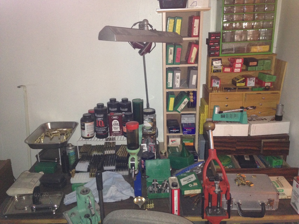

I started with a RCBS Rockchucker about 42 years ago - and eventually added a Forster (Bonanza) Co-Ax press - which is undoubtedly the finest SINGLE STAGE press of all.
I probably average several hundred rounds a month. I have never felt the need for anything faster or more efficient as I can switch calibers and loads very quickly. I shoot often so I don't have to 'plan' range trips (heck no range - just woods) and prepare 100s (or thousands) of rounds for a planned or scheduled shooting excursion.
It's kind of a mess in this picture and I have since cleared it up ! This was during a
Particularly high - output loading phase!
To answer your question though if I were just starting out I would probably look into a turret style press for quick die change out. I might also eventually look into an electronic powder scale for quicker setting of my powder measure.

Whouah !Mistered wrote:I started with a RCBS Rockchucker about 42 years ago - and eventually added a Forster (Bonanza) Co-Ax press - which is undoubtedly the finest SINGLE STAGE press of all.
Serious tooling for serious reloader !
many people say that rock chucker rcbs is a safe bet...
what are the advantage of the forster one ?
obviously many people find it excellent....!

The quick change die system and the universal, mechanical shell holder.what are the advantage of the forster one ?

I have a Lyman Turret press and a Rockchuker press. I keep the Lyman set up for .9mm and .327 Federal mag as that seems to be what I load the most. I use the Rockchucker with Hornady Lock-N-Load die bushings for quick changes.
Re: Tell us about your reloading press
I use two Herters presses. The Super O is the one that I started with in 1969. It has needle bearings in the linkage and by shifting a pin the stroke is shortened by about half and that increases the leverage so bullet swaging dies can be used. The other press is a Herters turret with a one inch thick turret that holds six dies. Both of the presses are fine grain cast iron and very heavy. I recently found my invoice for the first press It was $32.95.
