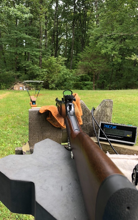

Got out my chronograph and checked my hunting loads in my BBSC .357 and .41 mag.
The .357 is loaded with 180g Hornady XTP bullets over Lil’Gun powder and the velocity averaged 1410 fps. I was figuring it would be a bit faster but that’s what it showed.
The .41 was loaded with 210g xtps over Lil’Gun and it is smoking right along at 1795 fps . That should work for TN whitetails.

Thanks for posting that. I was expecting right around that for mine for the 210gr .41 just working the numbers for the carbine barrel, but hadn't actually gotten around to borrowing a chrono yet. Guestimate was 1810fps based on 1560fps out of a 6.5" Ruger. :)

nicely done .... both should do the job .... we use 158 gr in our 357, this is the first time I've seen actual numbers on 180 gr'ers .... the 41was really impressive .... don't know if you have a ballistics program to feed your data into so as to know the trajectory of your bullets .. :?: .. if not, here is a link to the one we use .... at first glance it looks complicated but you don't need to fill in anywhere near all of the blanks

TNman, remember, the max velocity for the 210g XTPs is 1450fps as per the Hornady reloading, 8th ed. You might not get the penetration you expect, the bullet might even fragment on contact. Keep us posted on how you make out and good luck. PS, I spoke to a Hornady rep about the factory specs. posted on a factory box of 210g XTPs. ( those are pistol specs he said) . I said if they are fired from a rifle, you'll be over the max velocity for those bullets and he agreed and wondered himself. Rule of thumb- +/- 300fps. for rifle velocities.

Yeah Slugnut I never thought about shooting them at too high a velocity out of a carbine. I will see what happens...hopefully there will be several deer to evaluate their performance. Looking at the box it does say for velocities between 700 and 1500 fps.
