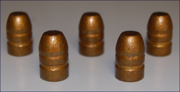

Yesterday I chronographed a .44 Magnum load from my 3 3/4" Ruger Super Blackhawk and my 20" barreled Henry Big Boy Classic. I used Starline brass, WLP primers, 7.1gr of Red Dot, and a 240gr RNFP hard cast coated bullet from Missouri Bullet Company sized at .432. I was encouraged by Squatch to try their bullets so I called them last week and they had some already sized at .432 from a previous special order. These loads had an OAL of 1.57" and a light crimp. The powder was measured using a very simple and not extremely accurate 1.0cc Lee powder scoop. I measured a few scoops and they were all within .1gr of the listed 7.1gr charge. However, those were weighed on my inaccurate Lee scale.

The ES & SD out of the revolver were not anything special, but I don't think I will be able to do any better out of the rifle even once my tuned scale arrives. I may have gotten lucky and pulled 5 loads that had identical powder charges.
This load seems very accurate out of both the rifle and revolver. I was keeping all shots from the revolver in a 3" circle painted on my steel plate at a distance of 15 yards. That was with multiple 5 & 6 round groups so it was very repeatable. I tested the load off a bench at 50 yards and got 3" 10 shot repeated groups. However, I think it is much more accurate and probably capable of that at 100 yards. I did not see any fliers and I would describe my bench rest skills yesterday as somewhat mediocre. I probably didn't keep the most consistent sight picture. I will test this load for accuracy at 100 yards this Wednesday.
This may be the load that I settle on as an only load for my revolvers and Henry. It can pretty much do anything that I will want of it. And it even meets the velocity constraints if I decide to do some Cowboy Action matches. A bit heavy on recoil for the revolver for that, but I would not be there for anything for fun and try to be accurate. Thanks to Squatch for encouraging me to try bullets from Missouri Bullet Company.
