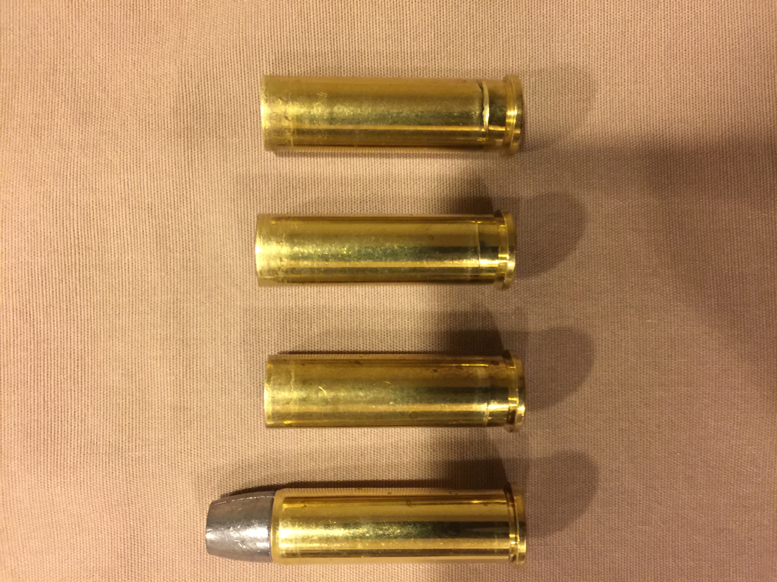

Has the quality of new factory ammo deteriorated or is there a good deal of trial and error involved in choosing suitable pistol ammo for a lever action rifle?
The following photos show some examples of case separation in one Henry barrel before being replaced with another barrel. The more I read; the more I’m beginning to suspect it’s ammo related.
First pic is of 158gr Selier&Bellot. 1. Unfired cartridge 2. Fired cartridge from original Henry barrel demonstrating ring 3. Case separation in original barrel 4. New barrel with same lot/box of ammo:

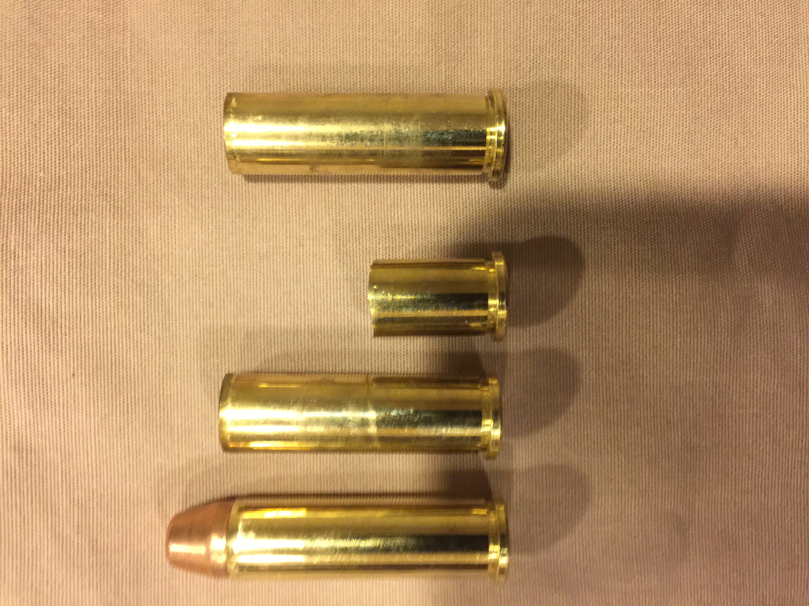

The next photo is 200gr Grizzly. First photo is the unfired cartridge and the next three are showing the order they were fired in. Notice on the last cartridge on right a deep cut/bulge:

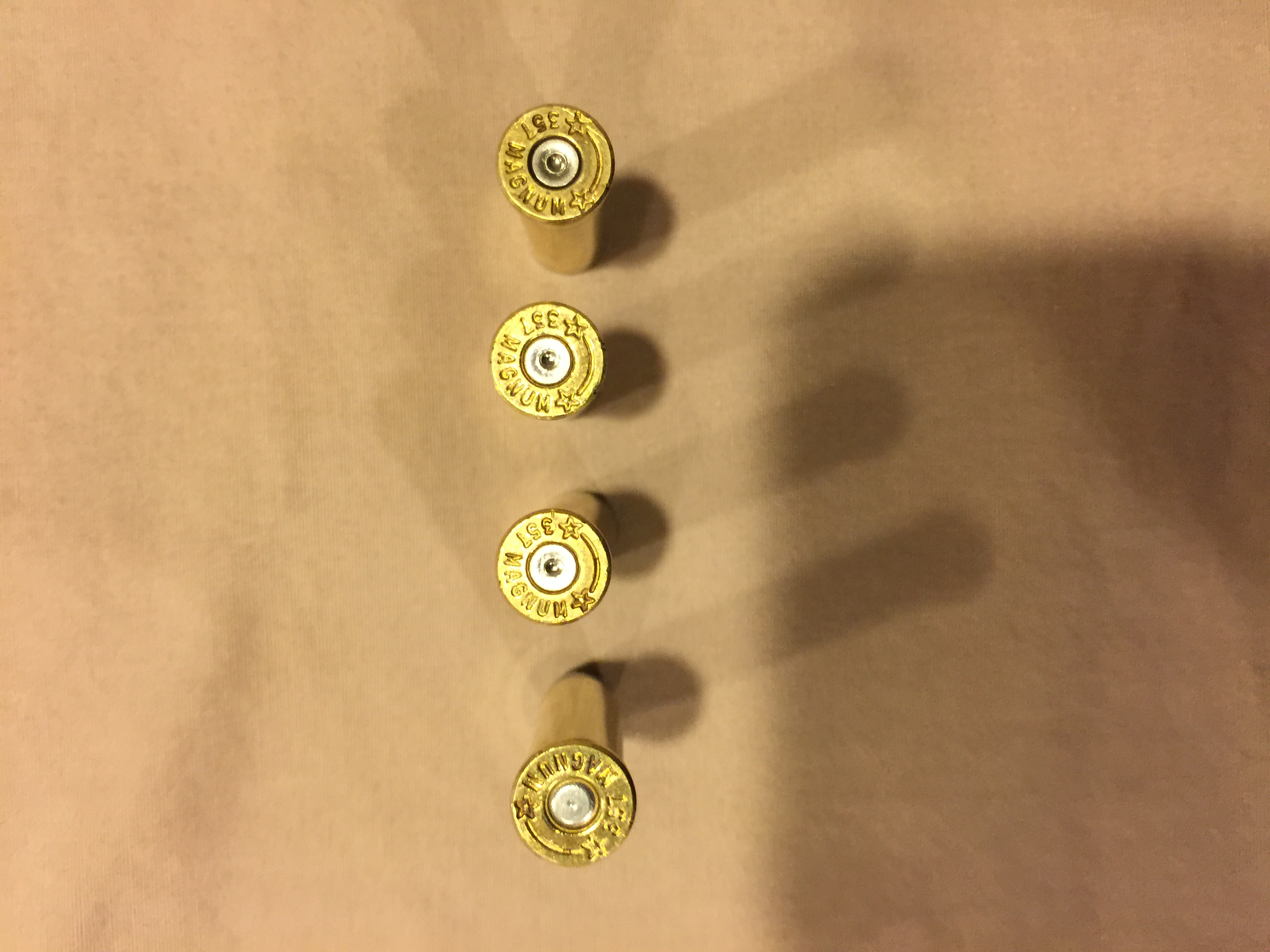

The last photo demonstrates the Grizzly ammo primers in the same order as above. Notice the far right primer:

My apologies for photo quality and duplicate photo. All comments are greatly appreciated especially if you have had any similar experiences with factory ammo.

JEBar, do you have any thoughts on what caused the cut in the last 200gr Grizzly cartridge? Was it just a coincidence that the case got worse from the previous cases shown?
I also need some help with the terminology for the Grizzly case defect. It’s not a separation yet, more of a cut and constriction.

That 200gr bullet looks awful long for a rifle. Are you sure the nose isn't tight against the lands?

.357 and 38 specials headspace on the rim. The rims on these rounds looked weird to me when I enlarged them. But then again it may be my tired old eyes.I've never seen rimmed cartridges look like that. Bottlenecked yes-but not rimmed.

No it’s not. In fact they cycle really well. I haven’t slugged the barrel but from what I’ve read, this cartridge is well within specs for the chamber.Jdl447 wrote:That 200gr bullet looks awful long for a rifle. Are you sure the nose isn't tight against the lands?

I could mic them. What is the acceptable thickness?Abnermal wrote:.357 and 38 specials headspace on the rim. The rims on these rounds looked weird to me when I enlarged them. But then again it may be my tired old eyes.I've never seen rimmed cartridges look like that. Bottlenecked yes-but not rimmed.
Probably not your eyes; just poor photography.
Abnermal
Re: .357 Magnum New Factory Cartridge Case Diagnostics
.060" is the rim thickness. For a moment I thought the rifle may have fired out of battery. But I don't think that's the case here as there isn't any case rupture. A little puzzling!

These averaged .058”. I agree it’s puzzling.

The last case especially exhibits signs of high pressure. If you look at the far right photo of the primers you can see the bright mark on the case and cratered primer. Before contacting the company, I was looking for advice from the experienced reloaders here. I reloaded a few decades ago and never had a problem with any of my reloads; or did friends I reloaded for as they made one shot kills on antelope and elk.
The thing I don’t understand, as was mentioned previously, was that each case became progressively worse. This is the reason for not firing the remaining seven rounds after observing the third fired round. I fired different ammo after this without a problem.
