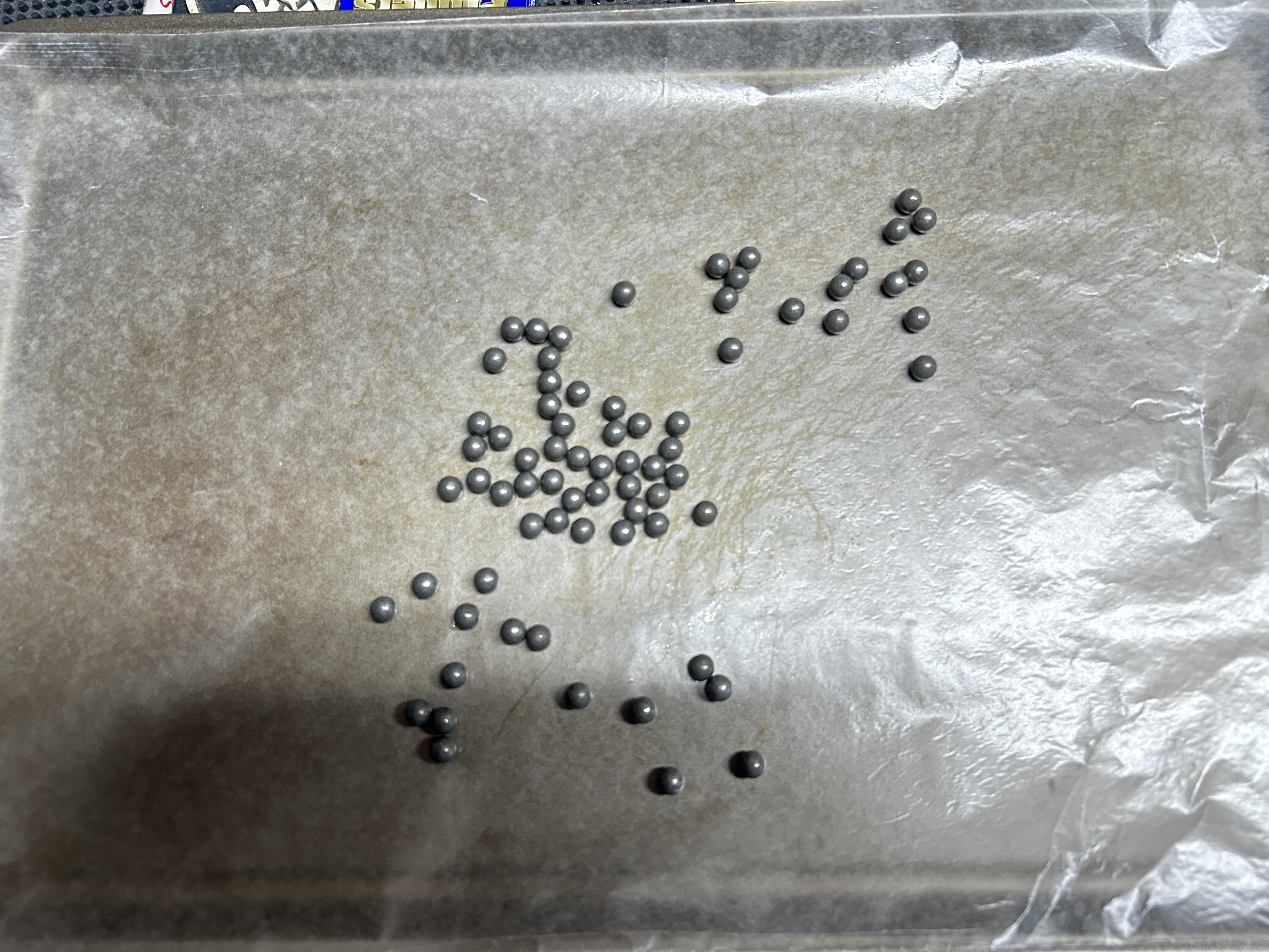

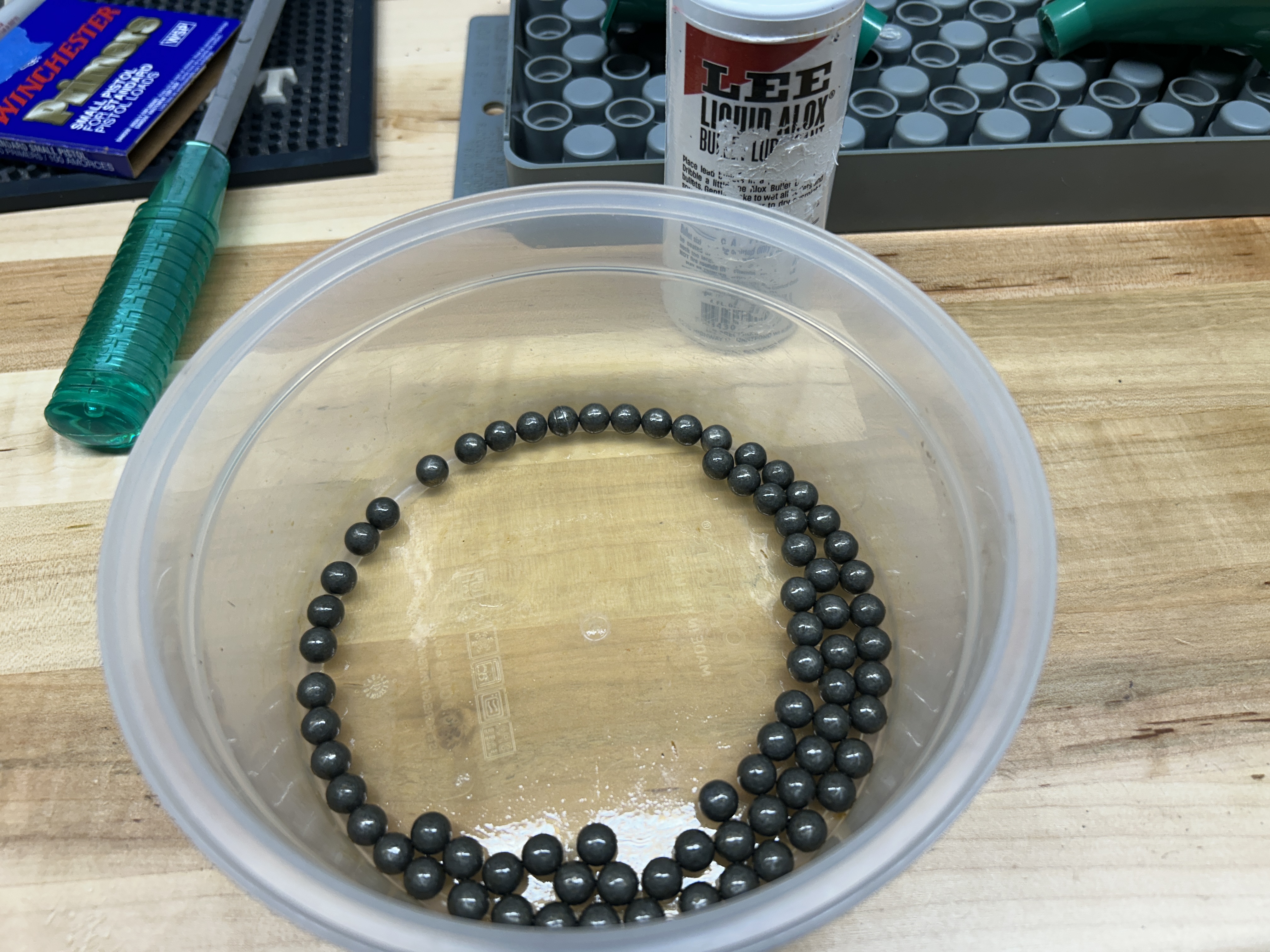

My Lee Liquid Alox bullet lube arrived so I lubed enough balls for the small amount of brass I have (60 pieces). I’ve never used this lube before and found it just as simple to use as what I read. Pour a few drops of lube on the balls, swirl them around until fully coated (1-2 minutes for me) and pour them out onto waxed paper. Next is to let them dry for 24 hours. May take longer for me as my reloading room is pretty much unheated unless I’m working in it and have the portable oil heater running. It’s in the basement which is always much cooler than the upstairs, especially in the winter as I mostly run the wood stove and not the furnace.
