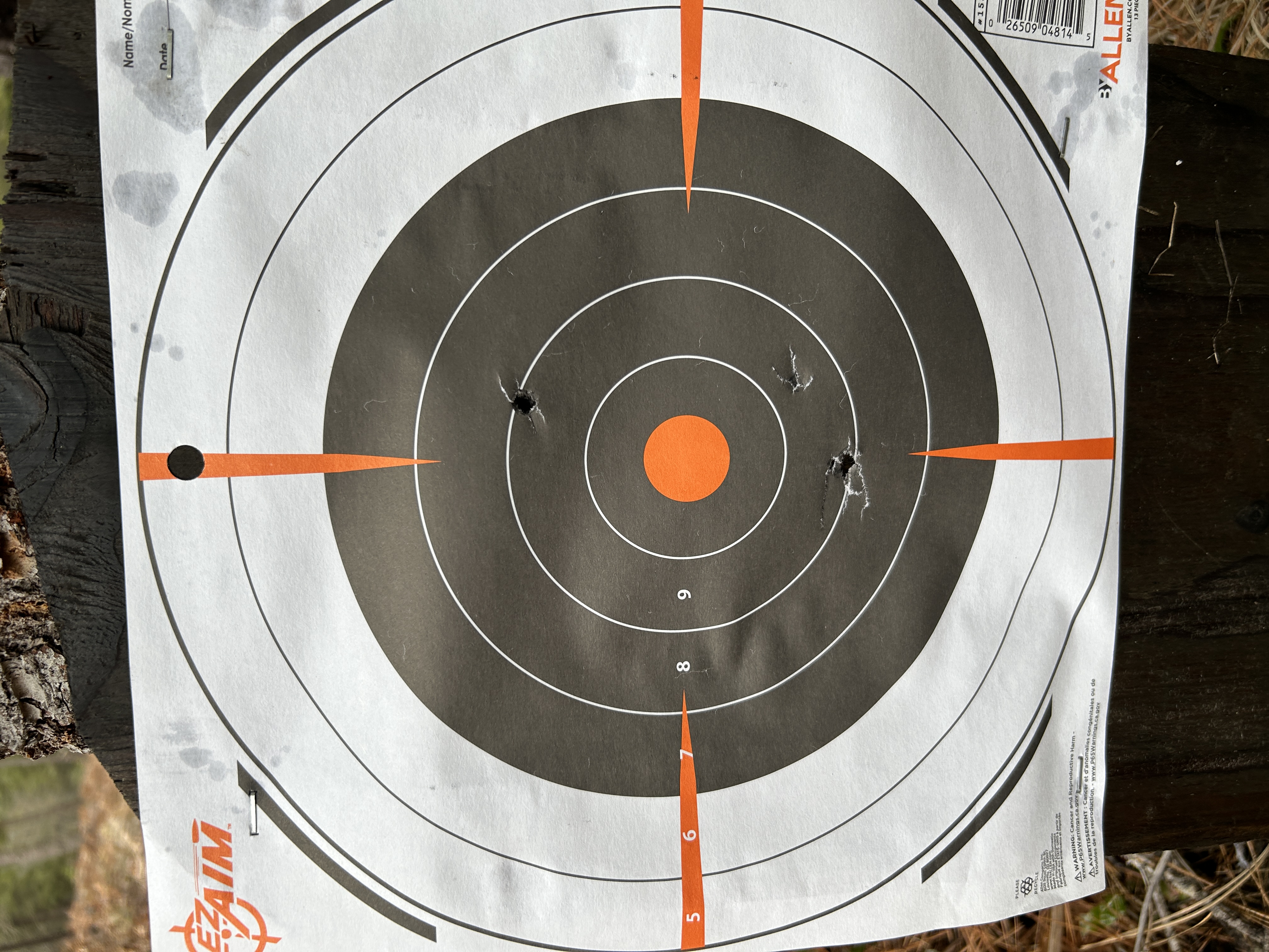

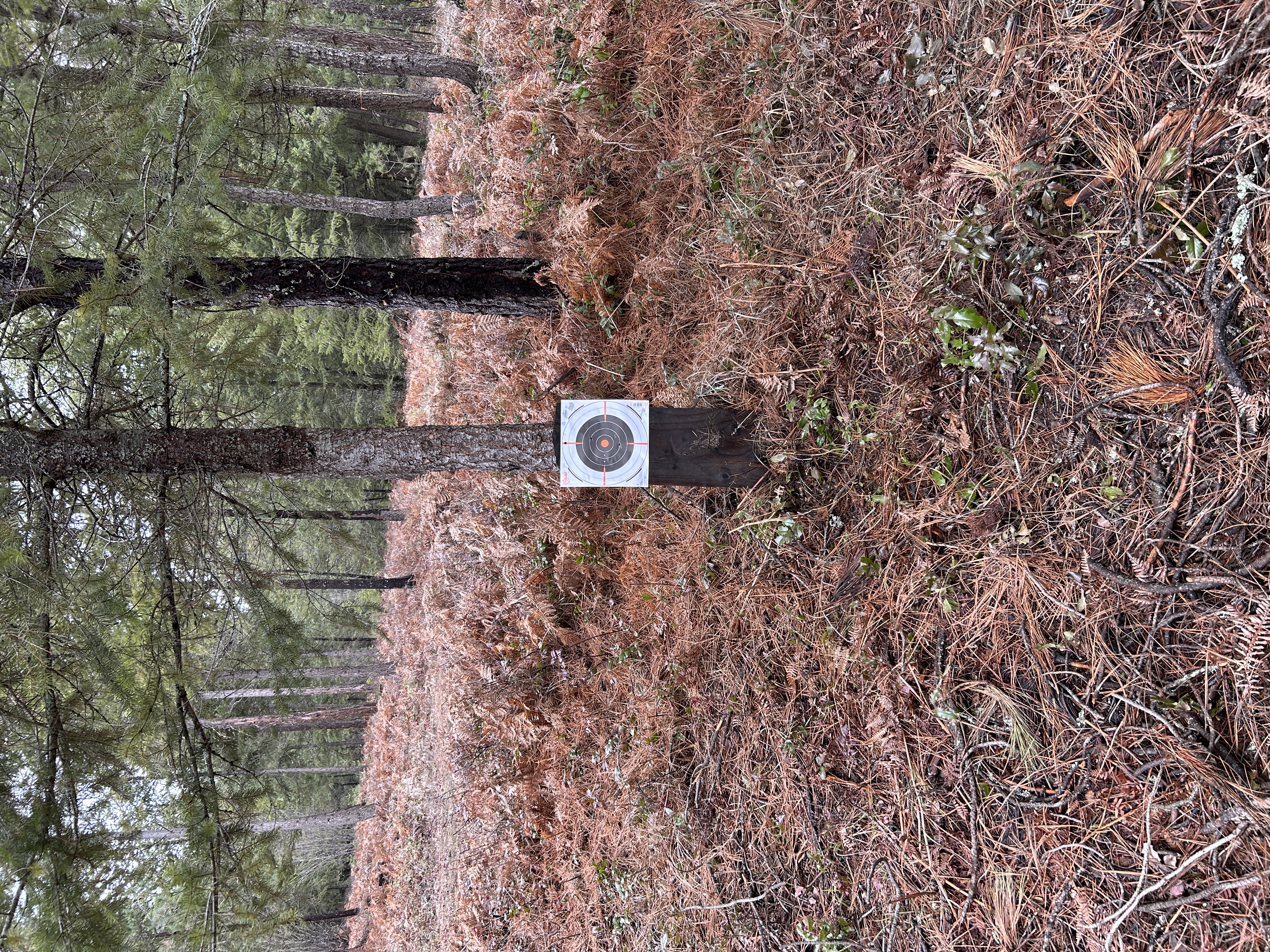

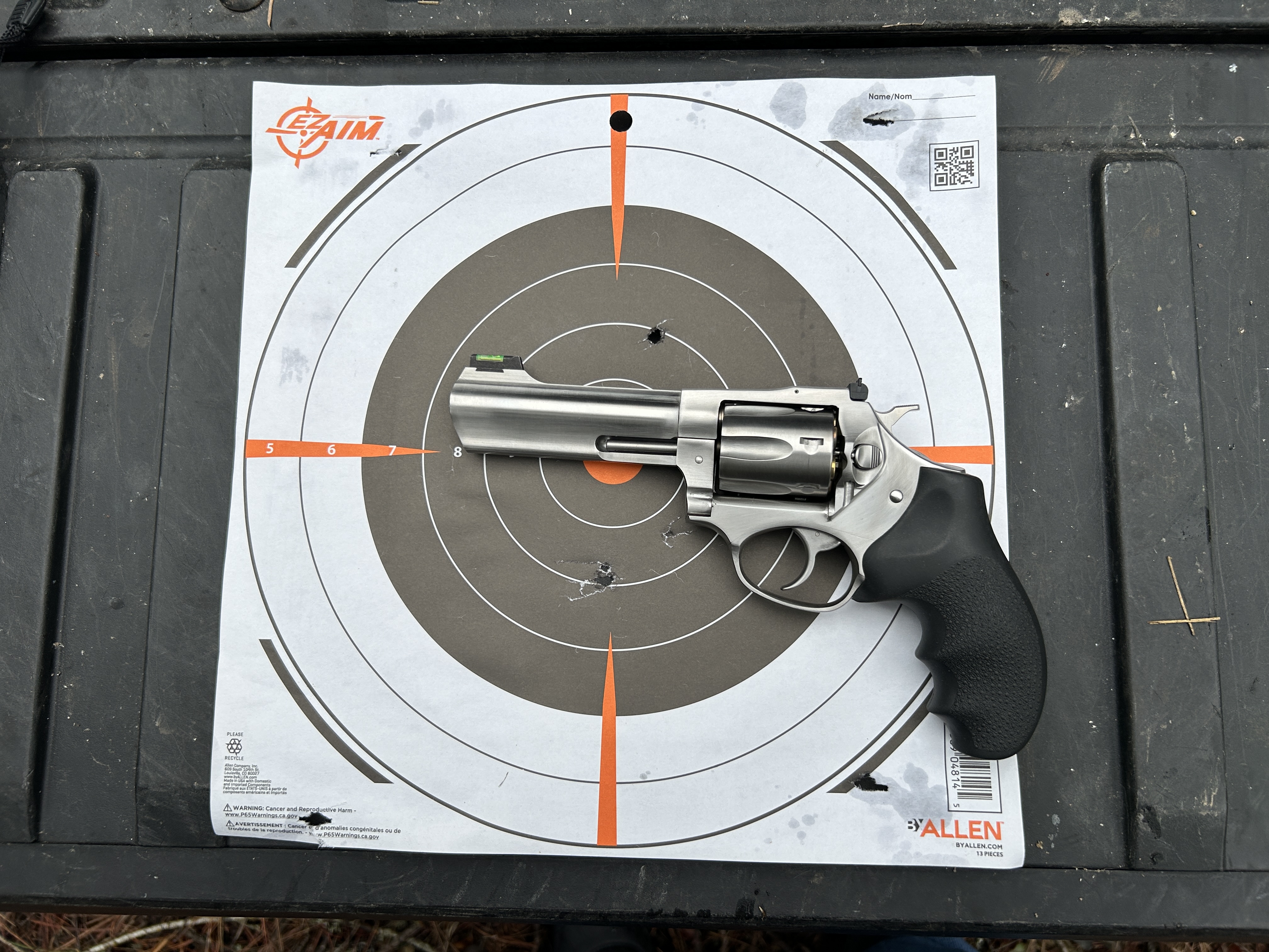

Got my second round of testing done yesterday. Fired six of my gallery loads with a full cylinder and my crimp held tight. Second part of yesterday’s testing was to see generally where the impact was on target. That’s a bit of a mystery. The first five shots I held center target. Result is one large impact area low and slightly left and a second impact area low and a bit to the right. It’s hard for me to believe that four of the five shots hit exactly in the same spot but maybe. For the sixth shot I held at the top of the black bullseye and the impact is a bit low which is consistent with the five shots fired at the center of the target.

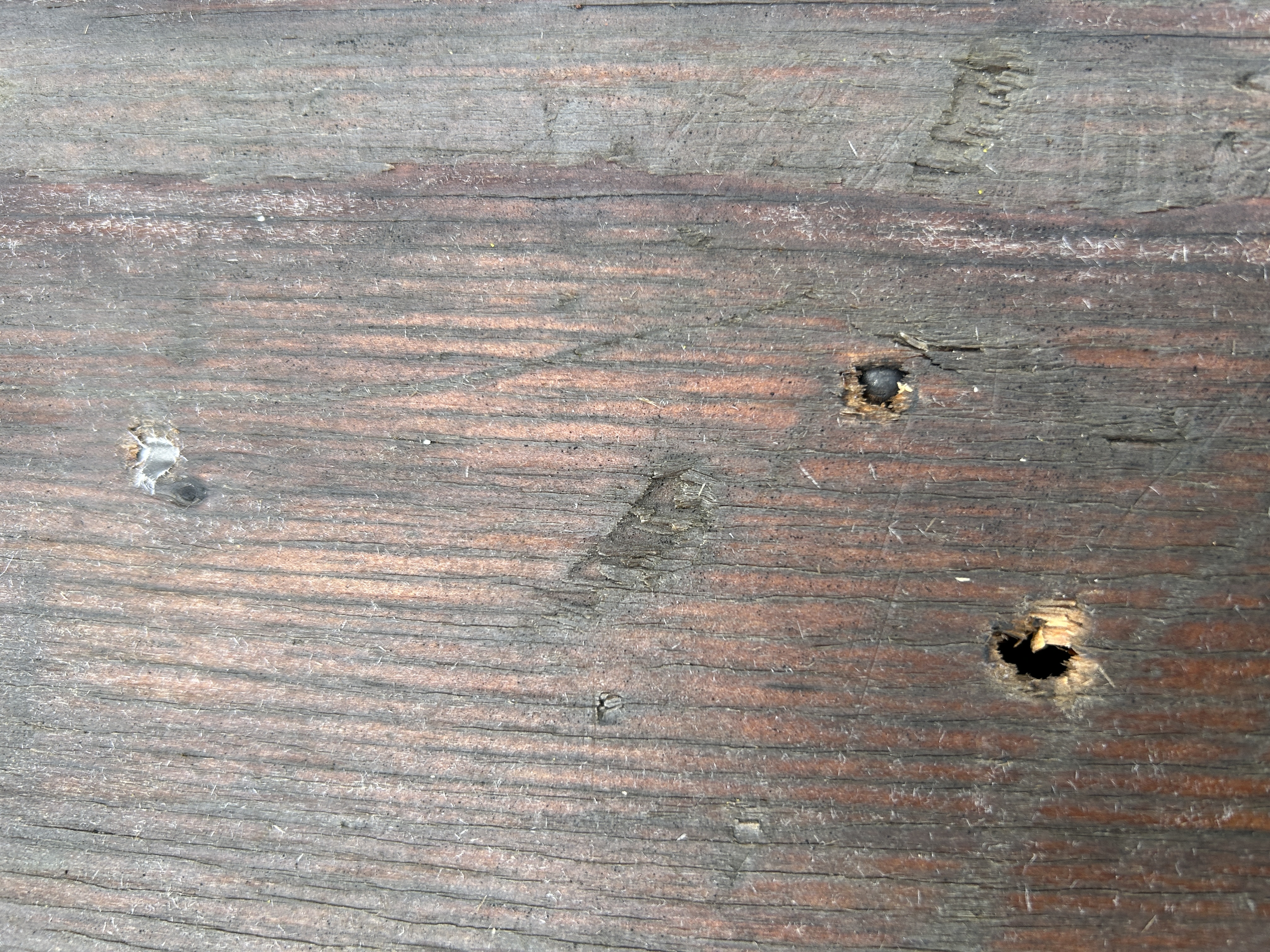

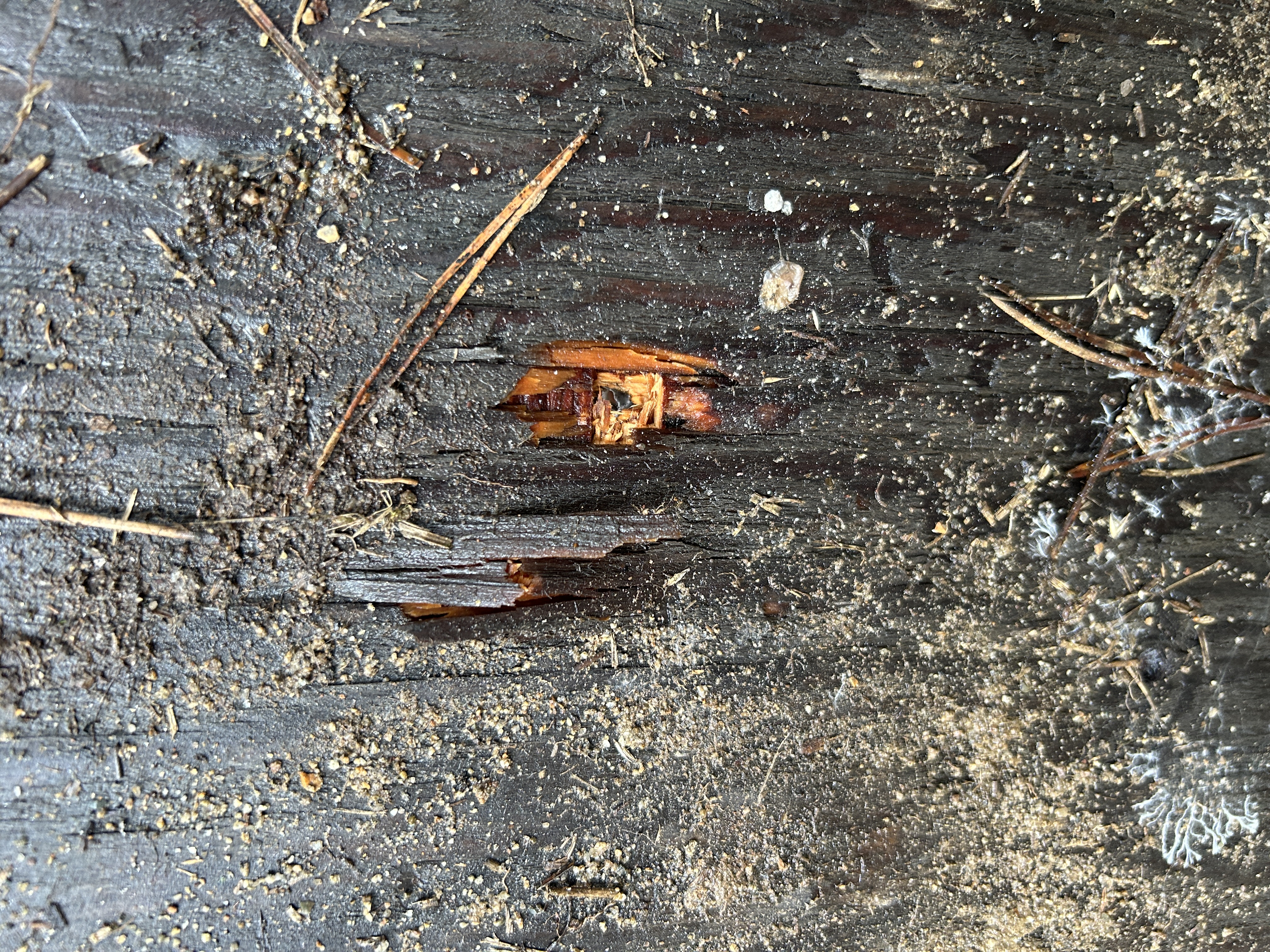

Looking at the back of the piece of plywood you can see where two or more balls impacted and tore up the wood pretty good. The hole with the single shot still has the ball captured in the plywood. Makes sense to me that the torn up plywood would have been from more than one impact. Next time I shoot these loads I’ll use a cardboard backer instead of the old aged weathered plywood scrap.
Shots were fired from 15 feet as this was mostly a function test.
