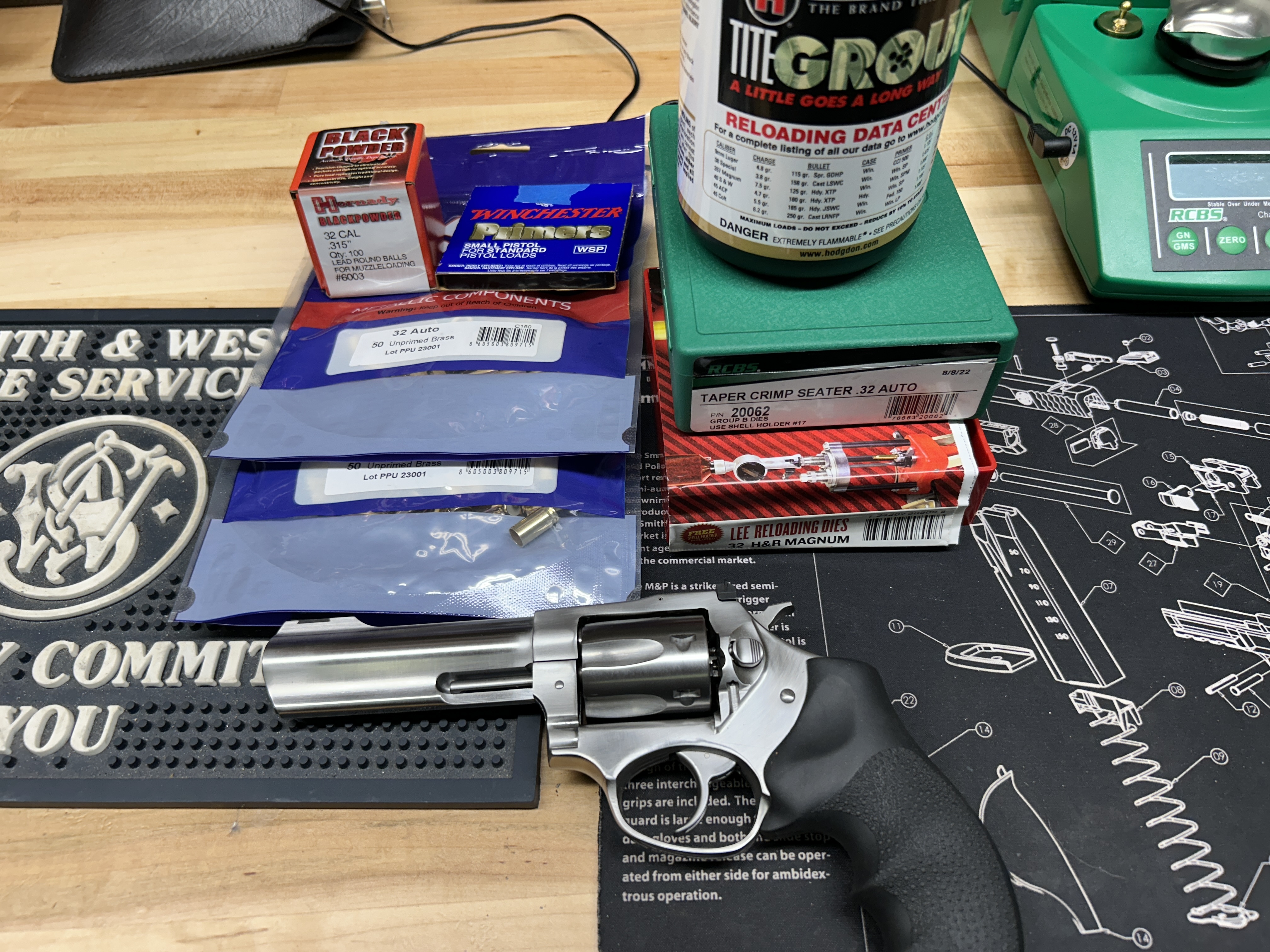

I worked on a project that’s been on the back of the bench only to have a big flop. A local guy had a bunch of .315 Hornady round balls that he gave me for a song with the idea of creating a gallery load to shoot in my Ruger SP 101 327 Fed Mag. I live in a no shooting community and thought these quiet loads would be a great way to break the rules and do some out the back door shooting.
So after gathering some 32 ACP brass I made a few test loads using 1.9 grs of Tite Group which is the fastest powder I had on hand. Bullseye is what is recommended but the Tite Group is pretty close in burn rate, just a bit slower. My set of 32 H&R dies which I thought would work for this project pretty much didn’t. I knew the seater die would not seat the ball in the 32 acp case due to length so I bought a 32 acp taper crimp seating die. Come to find out the expanding die wouldn’t get low enough to do its job. It is the Lee powder thru expander die with the floating expander piece in it. I had to put a bunch of flat washers in it in order for it to expand the case mouth.
So after all this I finally got a test load ready to try. It was raining pretty good so I stayed in the garage and took aim at a nearby stump. Pulled the trigger and……..”click”. Hmmm reset the cylinder and……”click”. Checked the primer and saw a very light strike. Just to be sure I tried another case with a seated primer and……”click”. Hmmmmm put this primed case in my little 32 acp and …….”bang”. Apparently the rim thickness on the 32 acp brass which is considered semi-rimmed thus able to be extracted/ejected in a revolver is too thin making it seat too deep in the chamber for a solid firing pin strike. Shucks.
So now I have nearly 500 .315 round balls I have no use for.
The fixings…
The fixings…
