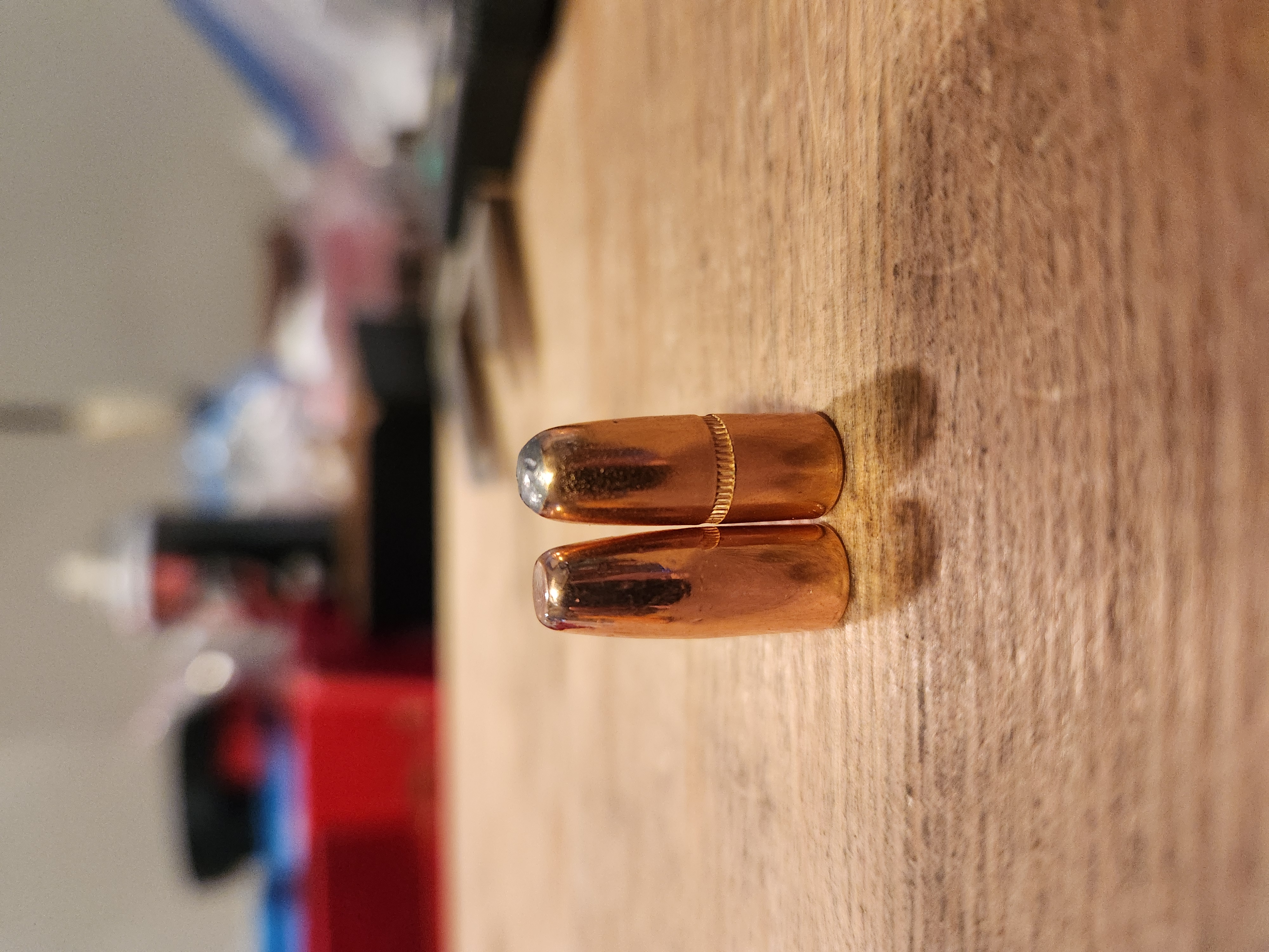

Picked up some Xtreme 150 flat point from a LGS. To give a try for plinking in the 30-30. Went to their data website to come up with a load and C.O.L. but they do not have that bullet listed. Searched for quite a while for data and and couldn't find any. Was wanting to try these out of my Henry and a 10" TC Contender. Has anyone tried these and have at least a starting point? They are .0030 shorter than my normal Hornady bullets so I'm wondering about overall length too. Thanks Dave

I dont think Xtreme gives load data on their website. But a starting load for a 150 gr bullet should give you something to go by. As far as OAl if it was me I would load a dummy load and make sure that flat point is going to cycle. Then I would just seat it where the cannelure is on the other bullet
