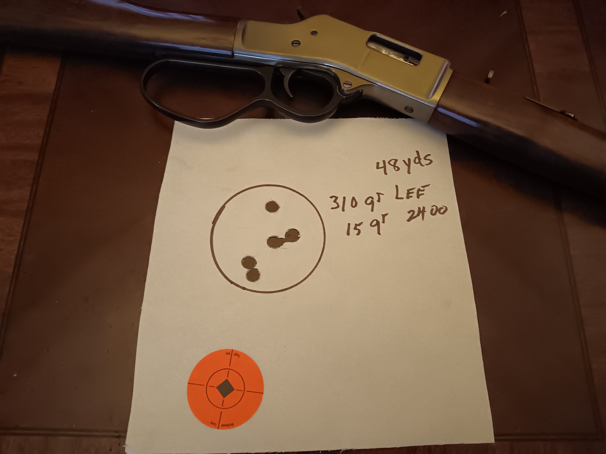

The 1:20 twist is to help stabilize the heavier bullets. Henry replaced my ⁴ barrel a couple years ago and I haven't shot it much.
But, I was messing around a few weeks ago with some of those 310s.

Vaquero,
Mighty fine shooting, especially with factory installed iron sights.

Post by Vaquero » Wed Oct 04, 2023 6:44 pm
Pitchman1968 wrote:
Wed Oct 04, 2023 4:01 pm
Vaquero,
Thank you.
