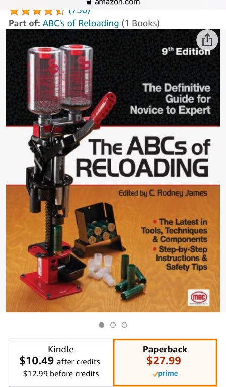

Read a good book on reloading, the Lee manual is OK, and their load data is good, but a more technical book like ...
https://www.amazon.com/ABCs-Reloading- ... 646&sr=8-1
.... will answer all your primer questions, plus a couple of dozen more that you have not thought of yet. I recommend that book, though I have to admit that I have not read the current edition, mine is from about 1980 and I still look at it every now and then. Maybe a member with a less ancient copy could comment. Perhaps forty years later it is time for me to upgrade.
OTH cartridges go and new ones appear, but they all work the same way.
