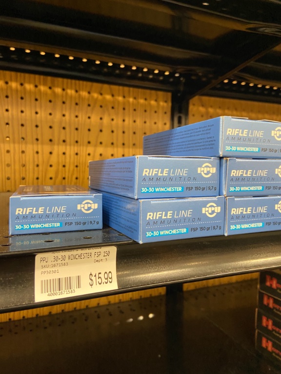

Post by Hatchdog » Fri Feb 12, 2021 11:09 am
Can’t help you with your brass question but I do see PPU ammo around. Funny, I took this picture a while ago just because I was surprised to see 30-30 in stock.
