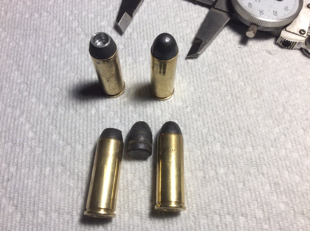

That light bulb went off in my head last night! Have been looking for some .45 Colt bullets at 200 gr. lead hollow point for revolver use and was examining my 230 gr. loads I had mainly for use in my 1858 Remington revolver. These are loaded with 5.5 gr. of Red Dot and shoot very well at most likely Cowboy Action type speeds 750-850 FPS. haven't run them thru the chrony yet.
Now the idea, being these are of a soft swaged lead, was to setup one up in the lathe and machine the hollow point cavity getting depth for a finished 200 gr. bullet weight. The resulting COL is 1.500 which is .085 shorter than they were loaded at due to trimming back the head for a flat. Finished weight came out at 200.3 gr. !
Made up a couple and will go to the range for a water jug test and see if they show any expansion or just break up.
Either way it will be a fun little project! Will fire them thru my Ruger Blackhawk since it is an easy revolver to setup the Magneto Speed unit on.
If all works well they could be a nice SD load ! I can most likely load them up a bit hotter if needed to the upper standard Colt 45 level depending on speed recorded. No need to run these much over 850 FPS being softer lead. These bullets are Speer and were for .45 ACP that a friend gave me some years ago. They have a special Speer lube mix in the lead.

Well wasn't too bad to do a couple for a test. It's easier on the bullet to chuck them up lightly when they are loaded in the brass. All safe since nothing behind primer to hit it and no heat/sparks involved. Just pay attention and watch what you are doing and don't get in a rush!
If it works out I would only need about 24 to keep on hand. They might be a good load for my S&W Model 25-7 !

What's the diameter of the hole?
Looks pretty big.

.250 diameter. I took 1/4 inch dia. 2 flute end mill and radiused off the cutting edges to leave a good radius in the bottom.

Post by fortyshooter » Thu Dec 31, 2020 10:17 am
Going to load up some more of these with 8.0 gr. of Unique and 6.0 of Red Dot. Keep bullet speed at no more than 900 FPS.
