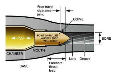

Post by Mags » Thu Apr 30, 2020 7:46 pm
Nothing silly about eliminating variables. Seems likely the "more bulk towards the front". AKA the ogive of the bullet too plump for the rifle throat/lead.
cross section.png (90.78 KiB) Viewed 3136 times

Ok, an update on this. I pulled the HSM bullet and ran it through my setup with no issues. Works fine at 2.548 OAL.
Gardners 405 gr flat point really weighs in at 420 gr and is shorter than the pulled HSM 405 gr bullet. If it is shorter but weighs more, I can see where the ogive has to be farther forward.
I was able to get it to plunk into the chamber and fall freely at 2.505 OAL. I backed off the powder level and will give it a try.
