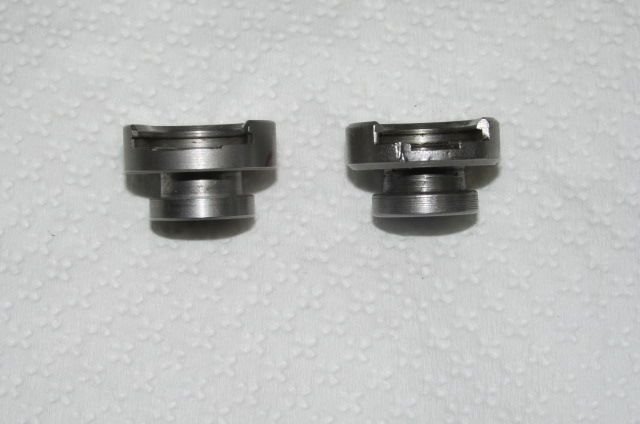

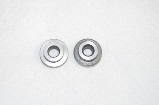

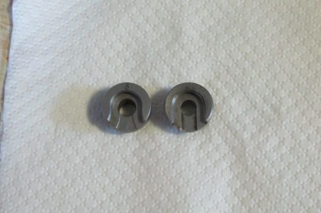

Post by JEBar » Sun Apr 05, 2020 7:28 pm
in the pictures below the differences in Hornady (on the left) and RCBS (on the right) shell holders can be seen .... the Hornady primer ejection hole is noticeably larger .... both will fit into each other's single stage press .... I plan on trying them and seeing if they will work

Grunt67
Posts: 1879
Location: Hartsville,TN
Re: Shell Holders
Post by Grunt67 » Sun Apr 05, 2020 7:43 pm
Probably will. That larger hole is why you need Hornadys' holder to work in their Cam Lok Trimmer.
