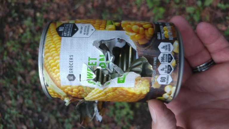

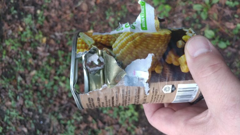

Still enamored with these 45 colt round ball loads. I switched from bullseye to trail boss and I'm getting a little cleaner burn. Another trick I've learned is to run the loaded case back through the sizing die until the top of the ball touches the bottom of the die. That increases pressure and keeps velocities pretty consistent. 1 grain under a deep seated round ball is accurate at 25 yards and it makes a mess out of tin cans. They are averaging 512 fps.

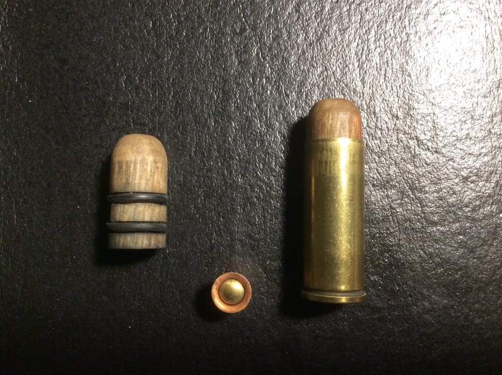

I used to make up wooden bullets with same overall size and shape as a 250 gr. RN 45 bullet and cut 2 grooves much like lube grooves
but for a pair of rubber O rings which would seal to the brass case and the revolver bore.
The case primer pocket was opened up for a 209 shot shell primer.
I would shoot them in the garage at a target with padded back stop. Cans and empty milk jugs made great targets showing a clean hole!
Ran a few over my chrony and got 330 FPS.

I've been thinking about casting some hot glue bullets. I'm constantly looking for something to keep me entertained. I need to cast some more slugs for my air rifles too. The rats will be out once we start filling the bird feeders for winter.

My woody Colt .45 loads. Bullet weight is 25.6 gr. powered by CCI 209 primer
