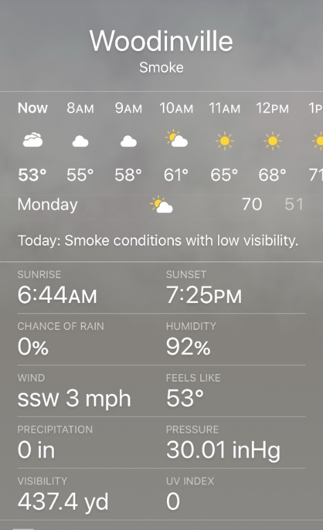

Currently we are having high humidity and smoke. It got me wondering if it would make a measurable drop in 200 yards. Would the type of bullet matter?
