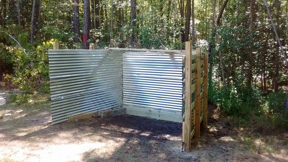

For mine I built up a 3 sided corral 11ft. x 10 ft.. and had it filled with 24 tons of sand since a sand and gravel place was just down the road a couple miles. A big mound will do the trick!

- range 2 sand corral.jpg (190.06 KiB) Viewed 1072 times

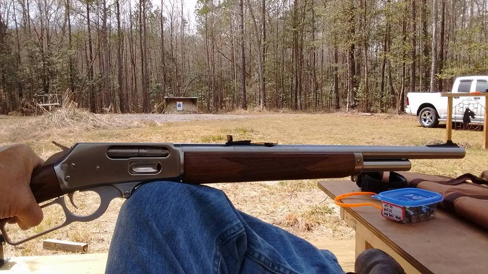

- 50 yd. target with .45-70 Marlin.jpg (164.47 KiB) Viewed 1073 times
