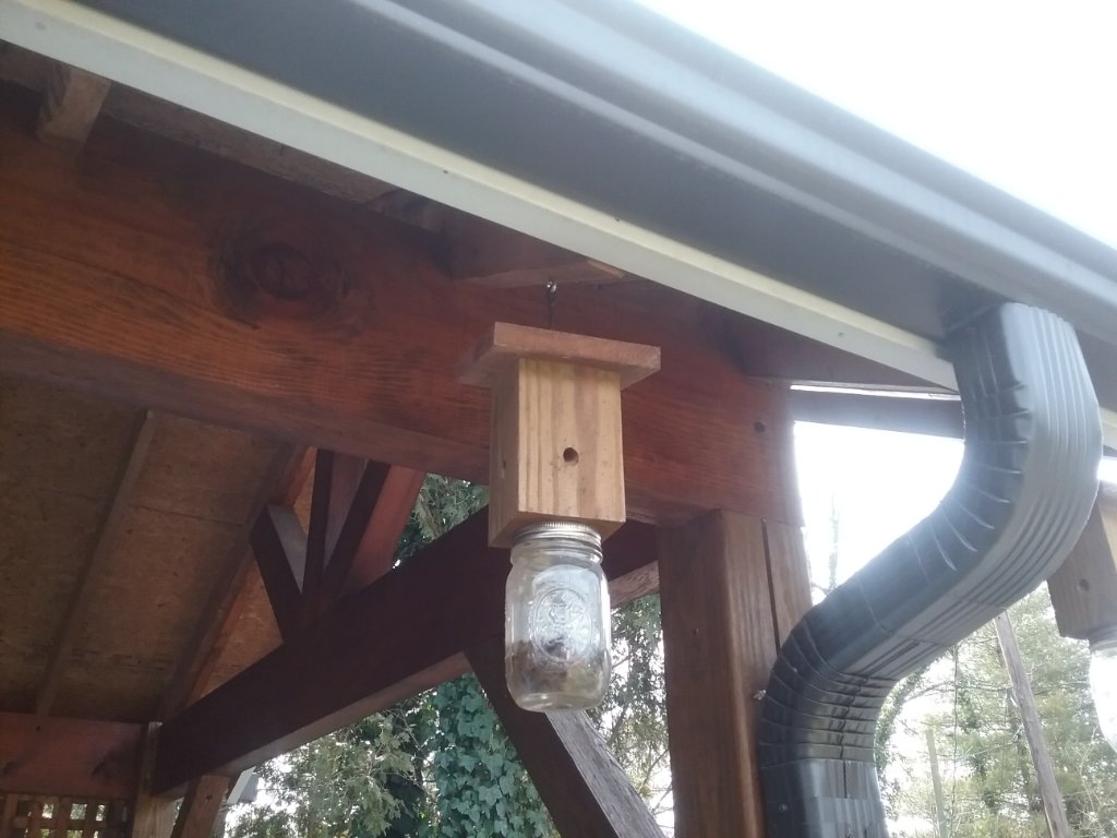

These are very easy to make, work very well and easy to empty. After made and before hanging, it helps to put a dead one in the jar. As you can see, this one is almost half full. Just have not emptied it yet since last year. I've made about 8 of these.

Sun Feb 23, 2020 11:02 am
I actually like the mason jar design better for the reasons you mention, but it can get a little rowdy around my shop and I didn't want to risk broken glass all over the ground. :)
Posts: 11138
Re: Borer bees
Post by markiver54 » Sun Feb 23, 2020 11:31 am
I hear Ya Gunny. Mine are up high enough though, so no risk of them getting hit. I always make sure the lids are tight as well.
