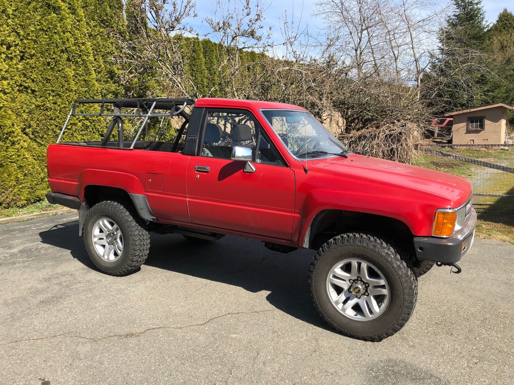

My Land Cruiser is full time 4wd, and non electricfrom high to low, but this does remind me to exercise its diff locker soon. It will stop working just like the actuator in your T4R. To keep it relevant, here is my ‘89 4Runner that I just finished welding new quarters and front fender arches into. I also built the Bimini top to keep my dogs out of the sun. Frame on that is now black.

Redthies wrote:My Land Cruiser is full time 4wd, and non electricfrom high to low, but this does remind me to exercise its diff locker soon. It will stop working just like the actuator in your T4R. To keep it relevant, here is my ‘89 4Runner that I just finished welding new quarters and front fender arches into. I also built the Bimini top to keep my dogs out of the sun. Frame on that is now black.
Nice Runner Redthighs. I had an 86 red. Looked very much like yours. That thing would go anywhere. Ended up selling it to a co-worker. Bought a 98 to replace it. Love 4-runners!

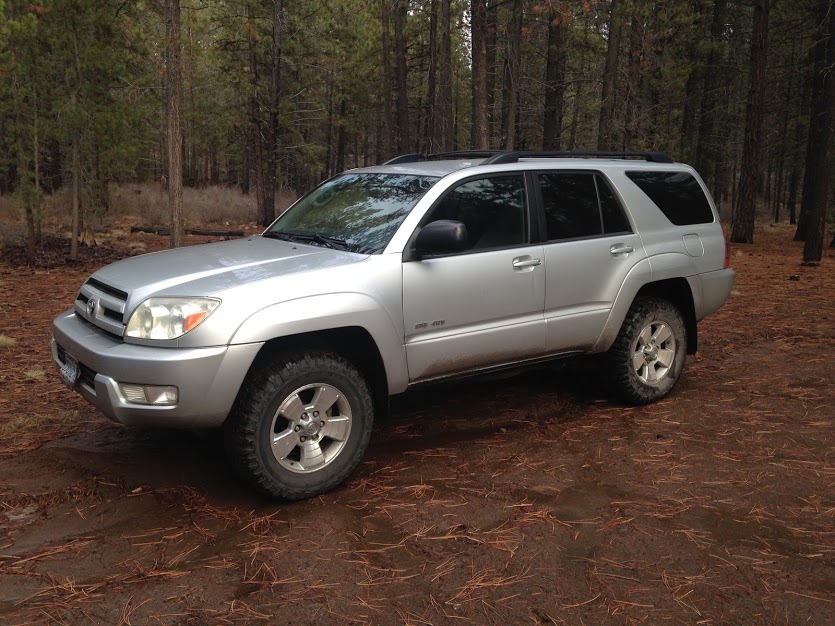

A pic of mine just so we know what we are talking about.
