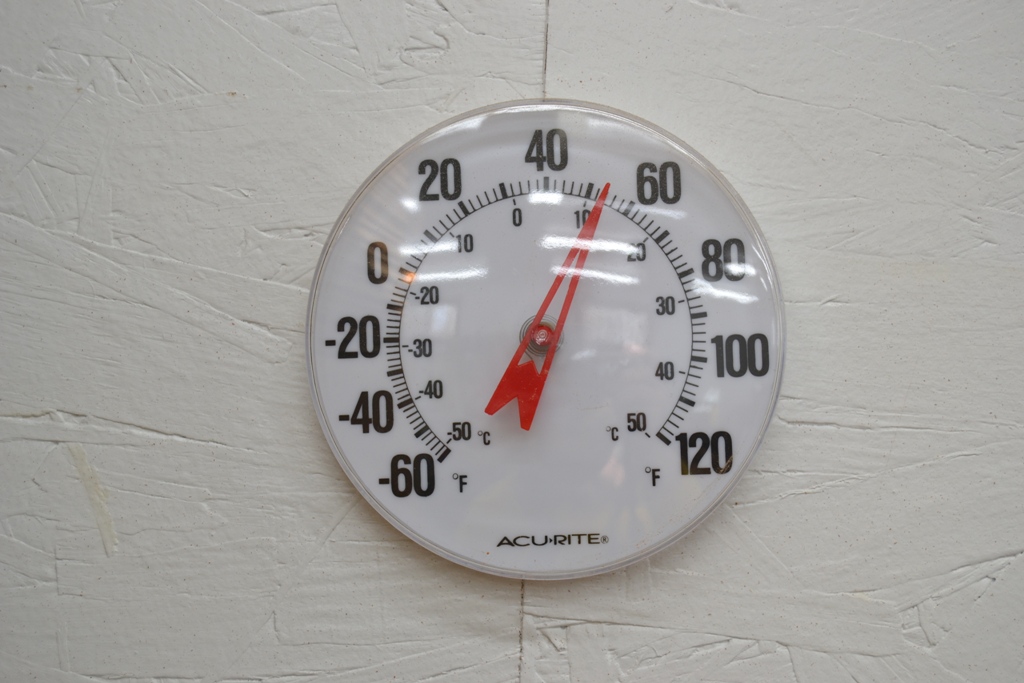

Now, coldest winter we can remember, overnight temps in the single digits. Still, temps have been steady and it's been a joy to don the coat to roll my walker from door to door and work in the flannel shirt in the shop in comfort. Got out there this morning and ... :o ... something just wasn't right? :roll:
Took a gander at the thermometer on the wall and ... Fifty Some degrees? :shock:

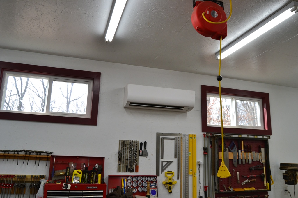

I checked the temp set on the remote control for the interior unit. It's mounted HIGH on the wall, so you have a TV style controller. Ah... still set at 68 degrees. Nope, that's not the problem. I switched from the AUTO setting recommended by the HVAC guy when we first turned her on and where it's been since: TO HEAT. I I turned on the FAN and set it to high. I expected the roar (okay, loud PURRRR,) of the fan we got when he demonstrated this feature.... :( Nada.
03 inside out of the way.jpg (245.7 KiB) Viewed 1556 times

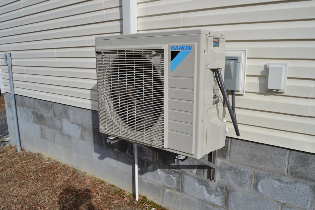

I called the HVAC guy and he answered sounding harried. I explained the problem and he said it could be a freeze lockout, but he'd have to come look, but was swamped. "As you might imagine, this cold snap has done me in." He said, he sounded exhausted already. "I can get to you late Thursday, or Early Friday." :roll: Yup, I understood, but ... I have a building full of stuff the cold will damage. He told me to try shutting down the main power to the unit outside, wait thirty seconds and restart. I did this; and will give it two hours. The outside unit is mounted up on the wall on the back of the shop so the finish mower can pass right under it, and it's easy to weed eat around. A nice touch. Right now I am NOT admiring it.... since it crapped out.

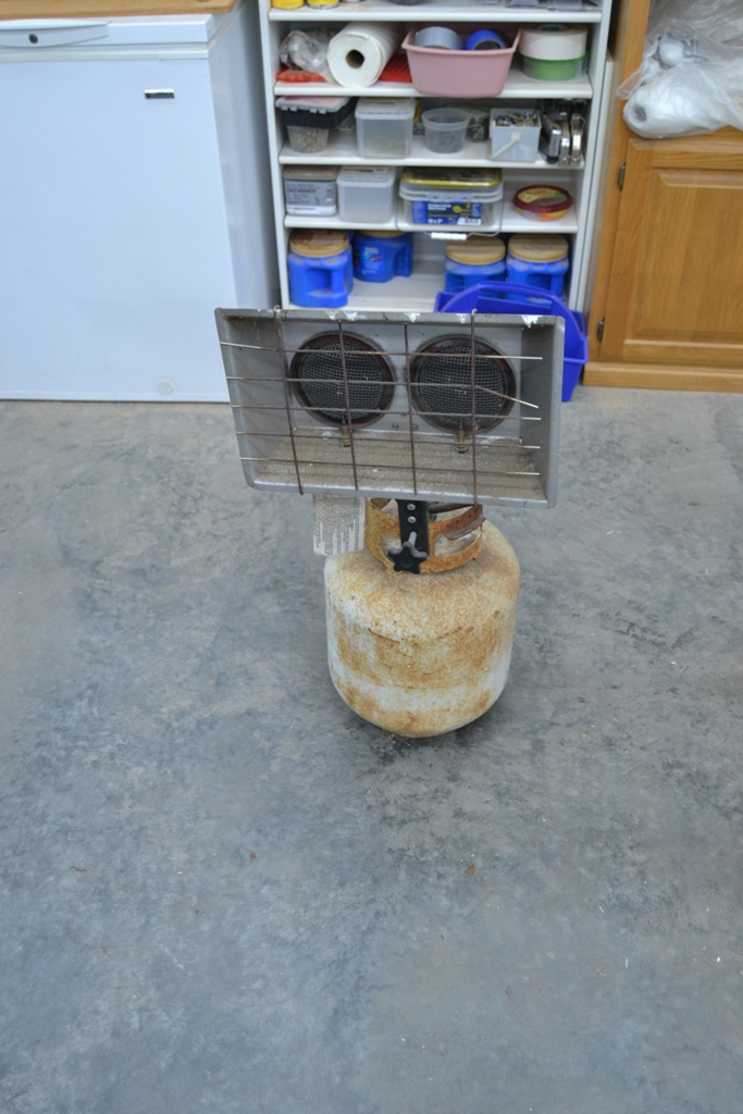

If the temps don't start to climb in the shop since the reset after an hour or so, I'll put my portable propane heater in the building and overheat 'er. (75 or 80) and then shut it down. That should keep it warm in this WELL insulated building for 24 hours or so. I'll repeat the propane heat until he gets 'er going again. This old gem is more than 20 years old, and uses the OLD style propane tanks. It's hard to get them filled, and eventually I'll have to find a new heater. But like me, old, but still works... mostly.

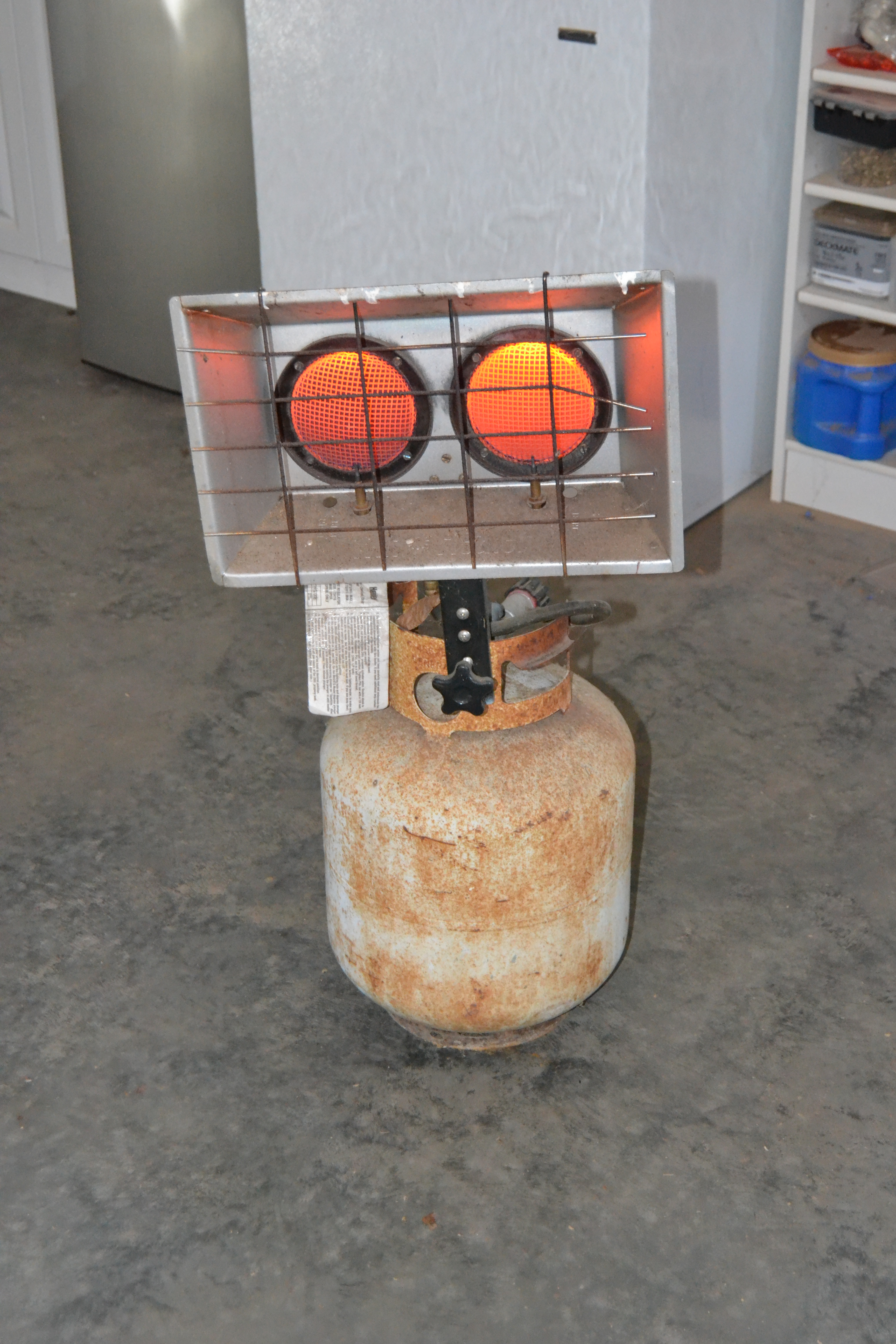

So old faithful was called in off the bench and is in the game. I'll check after a half hour and see what the old thermometer has to say about the old guy's performance, then follow up a half hour after that if he's still needed in the game.
hvac 010.JPG (3.5 MiB) Viewed 1553 times
Funny, it didn't take but a minute to get him "Fired Up," and he's been out of play for over two years, sitting and waiting. The last time I called on the old boy was when I taught a winter firearms class. Put up a three sided pop up tent, and we were all toasty warm as we shot the range portion with snow on the ground around us. :lol:
Posts: 7492
Re: If it's not one thing...
Post by BrokenolMarine » Wed Jan 03, 2018 2:22 pm
In seventy five minutes, the little guy added ten degrees to the shop temp. I shut it down and will keep a weather eye on the shop until the HVAC Guy makes his appearance.
