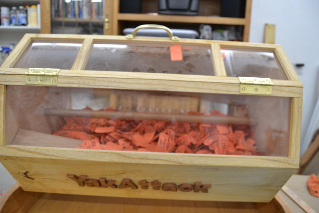

This morning after my coffee, I went out to the shop and sorted the raffle tickets into two piles by color, orange and blue. I wasn't worried about the colors for the first test, but I would need two different colors for the second... as you'll see in a minute. First test, I wanted to insure that the drum as designed would keep the tickets evenly distributed, so I loaded all the orange tickets all to one side, then spun the drum slowly, ten turns. Boo - Yah, success.
With the tickets loaded to one side, I slowly spun the drum ten turns to see if the internal paddles would smooth out the load.
01 side load.jpg (322.34 KiB) Viewed 659 times

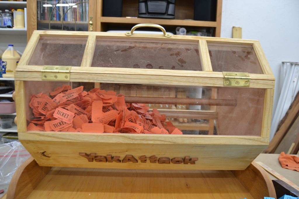

After ten rotations, the tickets were evenly distributed across the drum. A successful test! :) (sorry this pic is a bit blurred :cry: )
02 Evenly distributed.jpg (244.69 KiB) Viewed 659 times

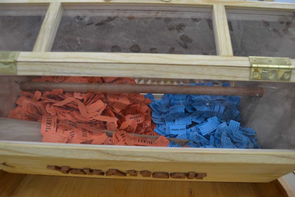

The second test was the most important. I had carefully installed the paddles to mimic a washing machine agitator, hoping it would stir the tickets in the drum, moving them both right to left and left to right and thoroughly mix them in the drum. This would test that. I placed the tickets in the drum with the orange tickets again all to one side, and the sorted blue tickets to the other. I turned the drum slowly twenty turns to avoid the interference of centrifugal force holding tickets against the drum...
03 Color Split.jpg (275.37 KiB) Viewed 659 times

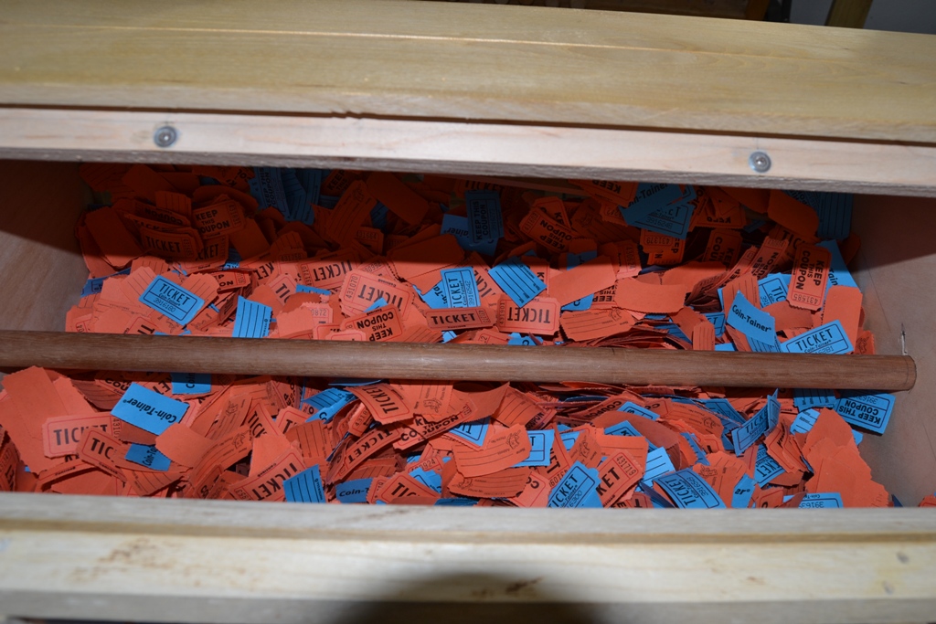

I peeked in the windows and ....
04 Evenly stirred.jpg (335.87 KiB) Viewed 659 times
Worked like a champ!
