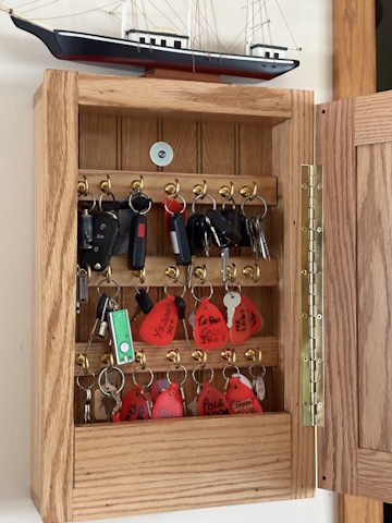

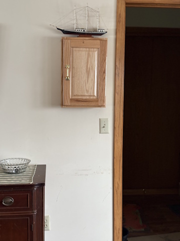

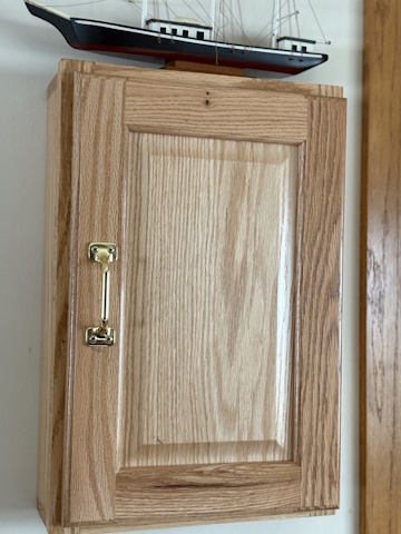

I also had a small project that I had wanted to do for some time. We have many sets of keys for vehicles, house, barn, and shop that usually were spread out on top of a buffet next to the door to the mud room. I wanted some way to get these out of sight and arranged for convivence so I designed and built this small cabinet which works out perfectly. I do a lot of wood working in my shop and I enjoy creating this type thing.

Nice job, like the piano hinge rather than a couple of small cheap one. White with poly or lacquer? My wife’s bought me some nice hand tools form
lie nielsen toolworks. Great stuff. I work mostly with Maple, Walnut my favorite and some cherry. I did make a colored pencil holder for my art. Made it with Caribbean Rosewood. I did four coats of Odies oil sanded to 600 grit. Looks like it marble not wood and super heavy. But that’s hard to get and super expensive.

Guide wrote:
Mon Feb 03, 2025 5:39 pm
Guide
It's white oak with a Urethane finish from Minwax. All of the woodwork in our home is white oak.
I'm looking foreword to seeing your project.

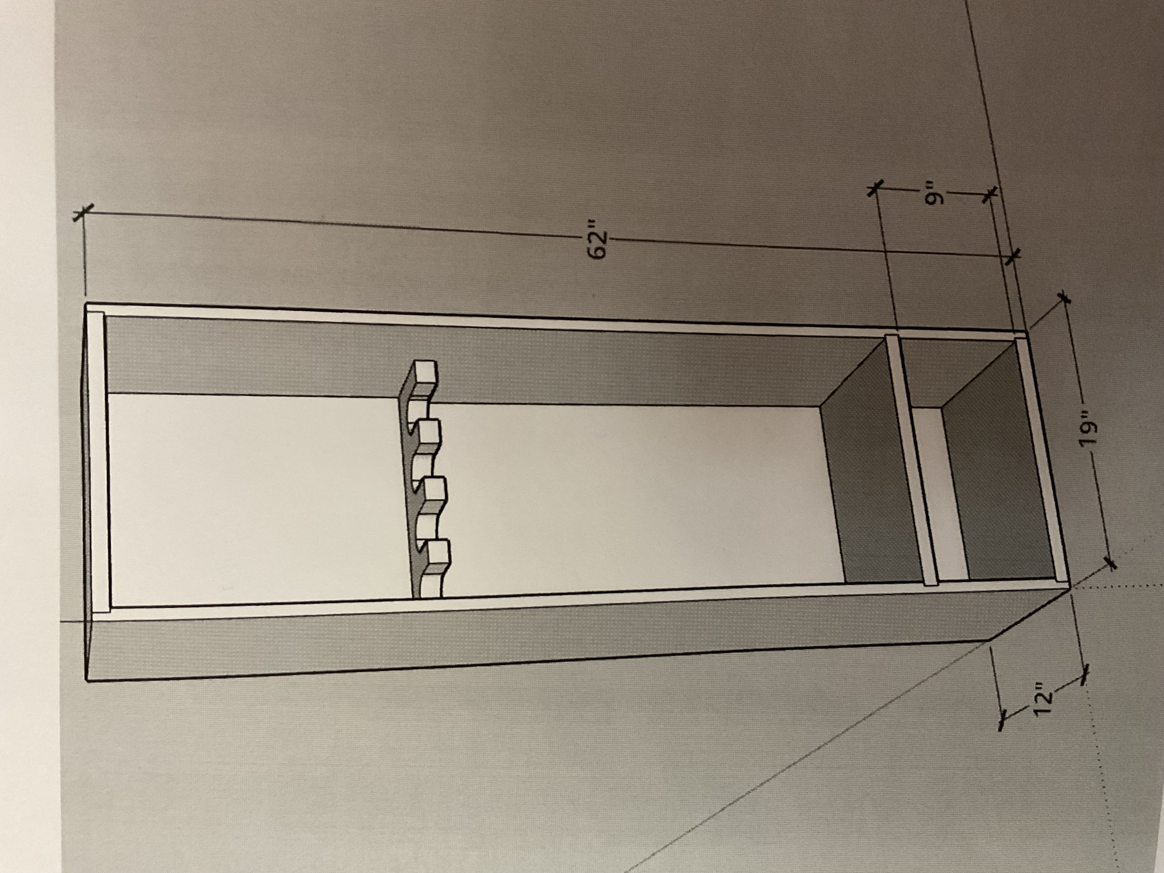

Post by Guide » Wed Feb 05, 2025 6:51 pm
A Sketch Up drawing of the cabinet. 62” high 19” wide and 12” deep. Opening on the bottom is 9” high, 17-1/2” wide and 11-5/8” deep. Not sure if I’ll use one full length door and keep the bottom area as a shelf or door over the top half and a full extension draw on the bottom are. I’ll loose some capacity if it’s a draw but a full extension draw is nice plus I can look both with different keys. I’ve got a couple of bronze oiled draw pulls the are really nice and both the door and draw with be soft closing.
