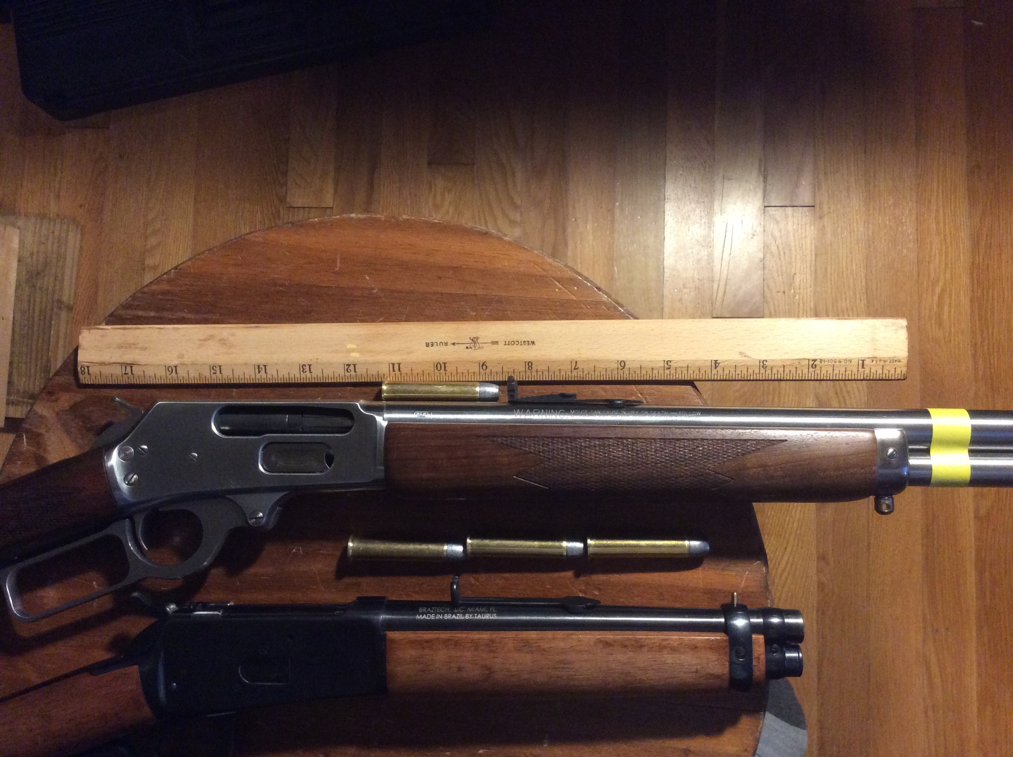

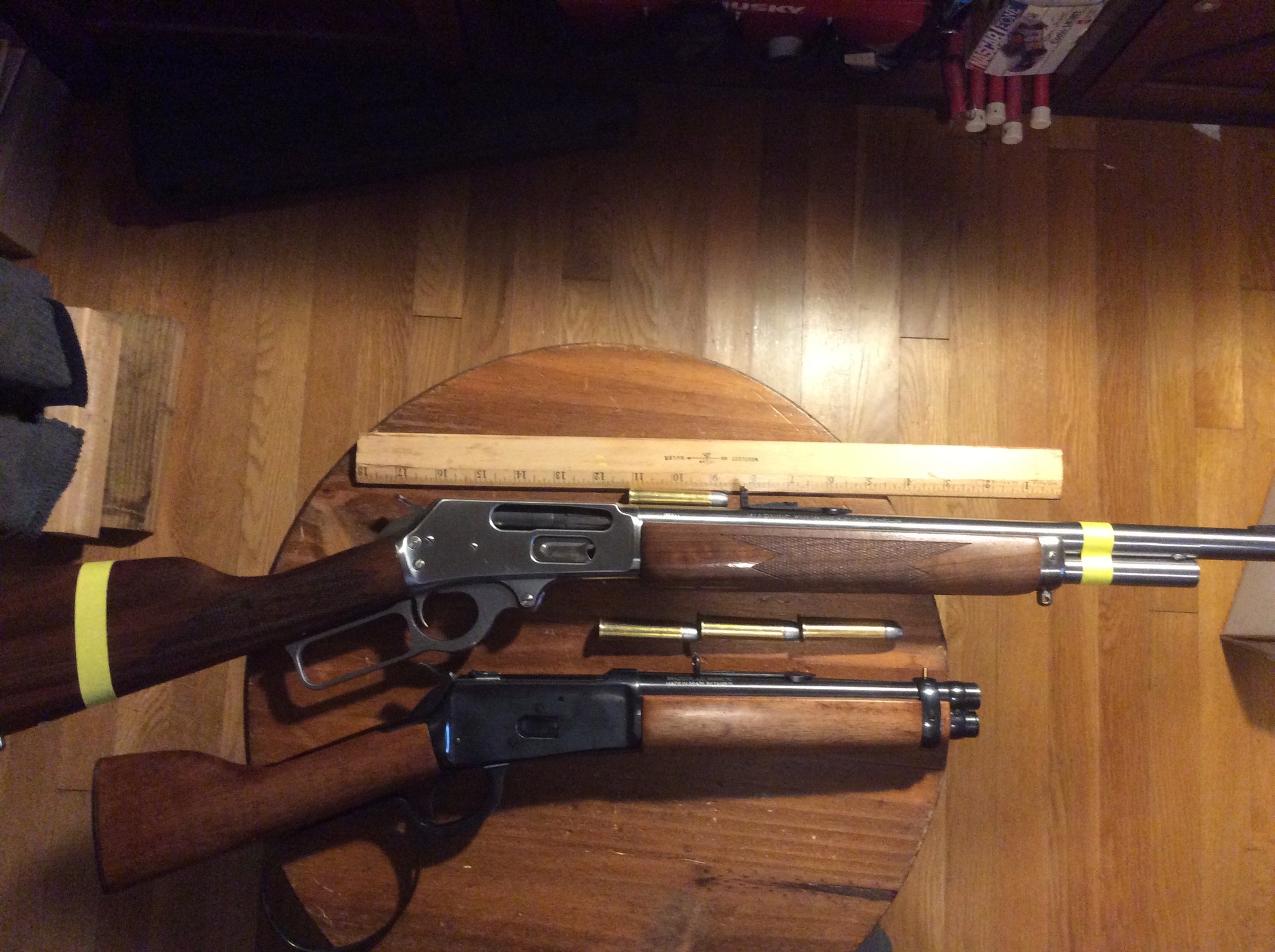

Post by fortyshooter » Fri May 19, 2023 11:45 am
Far as I know the idea of the mare's leg rifle came about from the TV series Wanted Dead or Alive and was intended to function like a .45-70 version.
Lots of folk joked about it when seeing the .45-70 in Steve's ammo belt/holster that such a beast would never work.
Doing a bit of looking and measuring with my Marlin 1895 GS and it really isn't a far out idea. Looks like with the barrel cut to 11 inch I would only loose one round of capacity going from 4 in the tube to 3. With one in chamber you would have 4 ready to go. Now 4 should be plenty with 405 gr. bullet going around 900-1000 FPS you think plus quick side gate reloading on the run if needed.
Since you would have to get the ATF SBR stamp for it you can save the factory stock and use a replacement for the cut down mare's leg version and have option of just an SBR with option of a suppressor attached since I have one.
My loads for this would be something like my 11-13 gr. Unique with 405 gr. cast bullets for less recoil.
So for the 200 buck Tax Stamp plus cost of a replacement butt stock you have the real deal as per the classic TV show!
Wheels turning in my head! :D
Comments anyone?
45-70 mare's leg possibilty.jpg (659.7 KiB) Viewed 876 times
11 inch barrel would loose one 45-70 round.jpg (653.62 KiB) Viewed 876 times

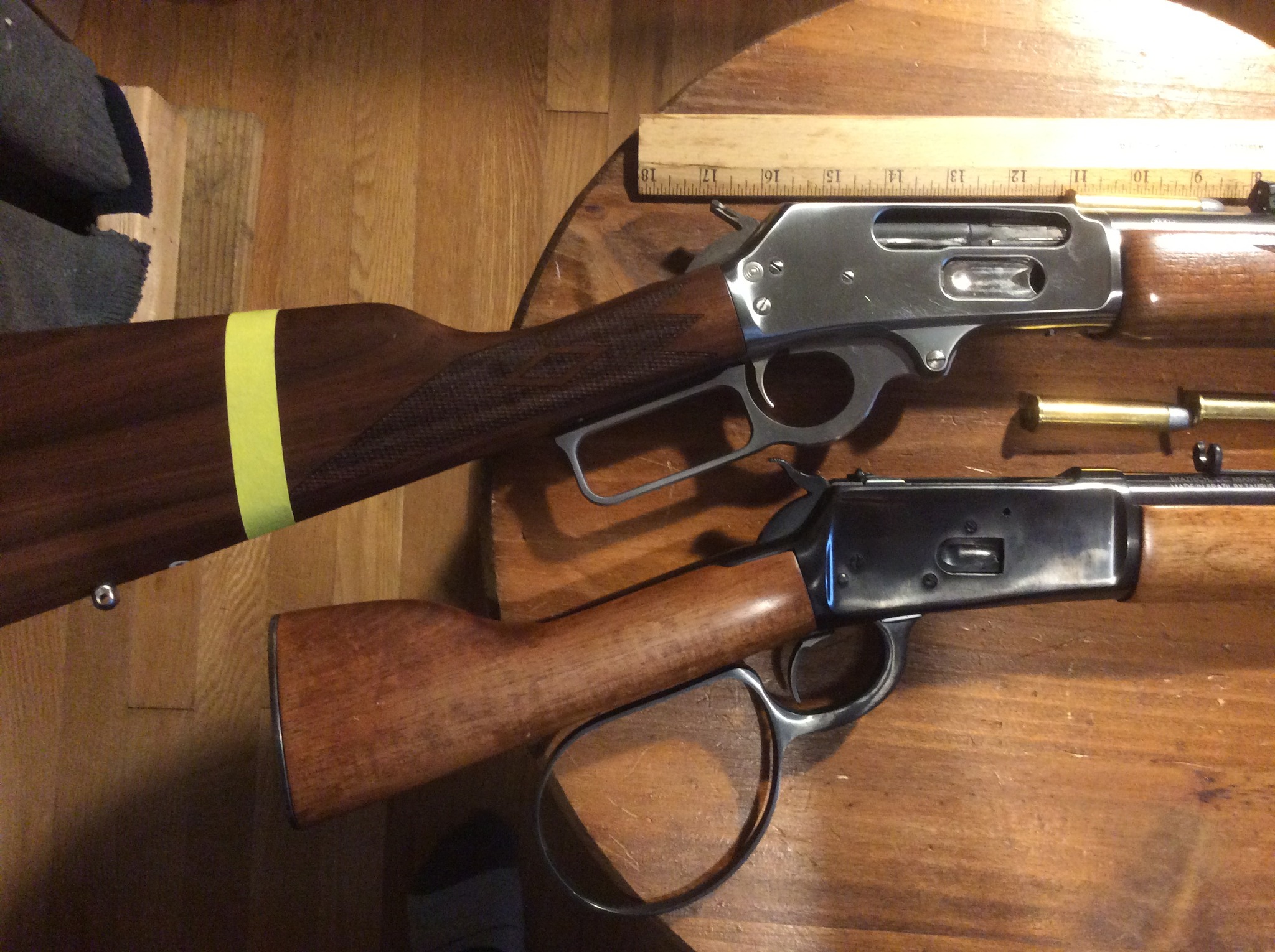

have to be an SBR but could have stock butt stock or the shrot mare's leg version.jpg
have to be an SBR but could have stock butt stock or the shrot mare's leg version.jpg (687.14 KiB) Viewed 876 times

Might open up that lever loop a bit too or get another that is a larger loop. My Rossi 45 RH cycles really easy especially after the slick up job.

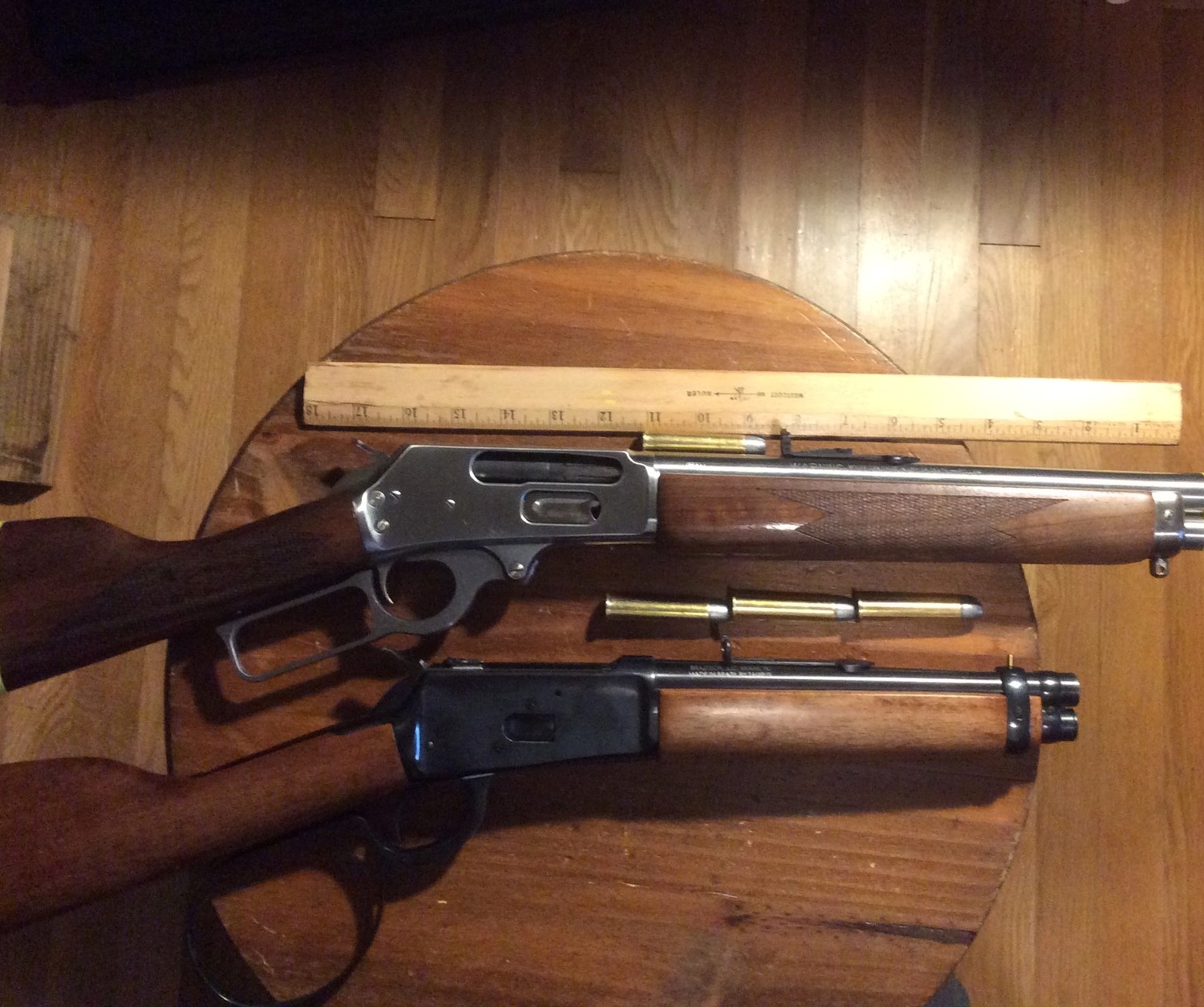

Post by fortyshooter » Fri May 19, 2023 3:08 pm
Did a little editing to get a picture of it. I don't know....still on the fence.
45-70 mare's leg possibilty (2).jpg (419.53 KiB) Viewed 862 times
