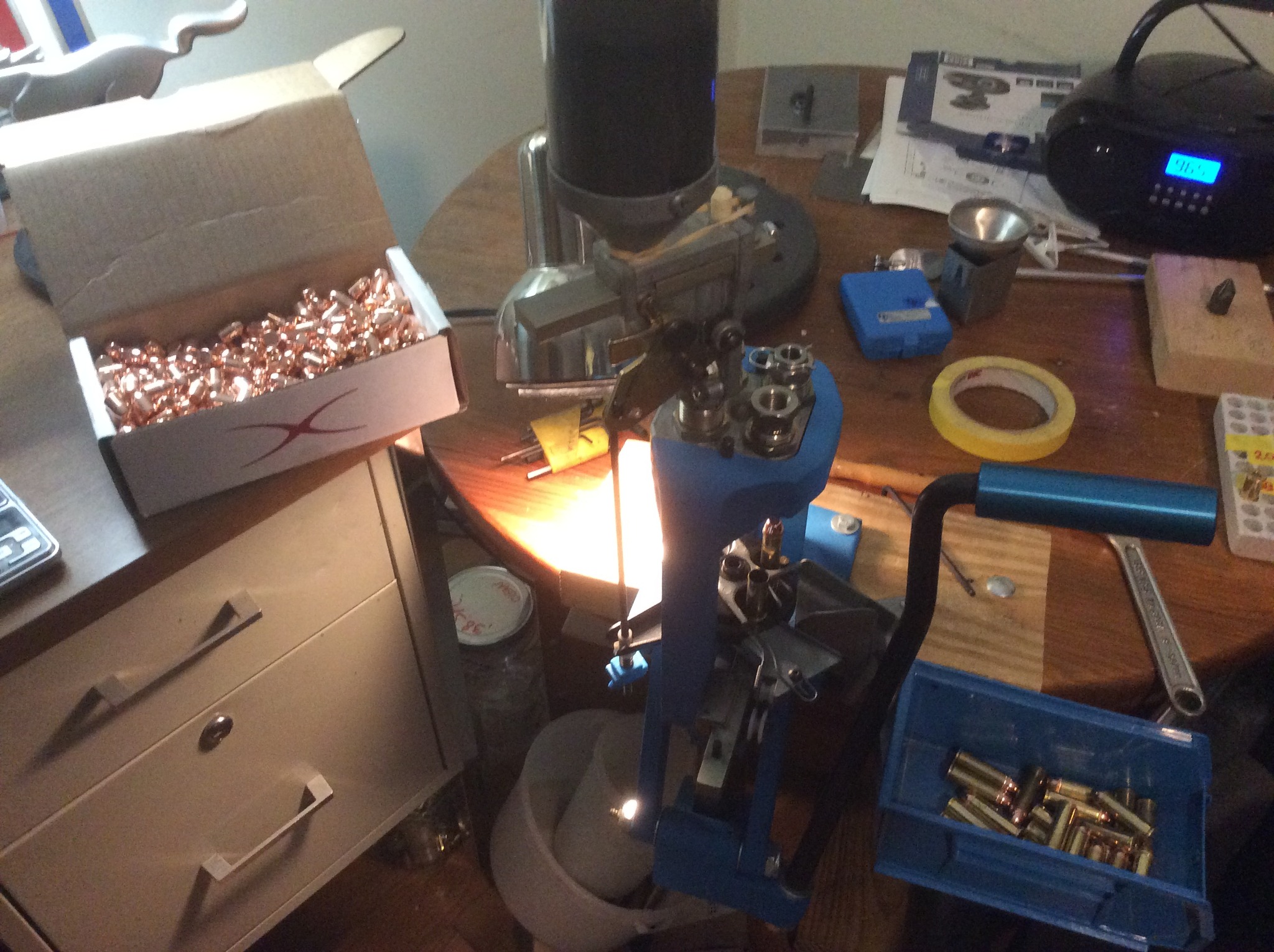

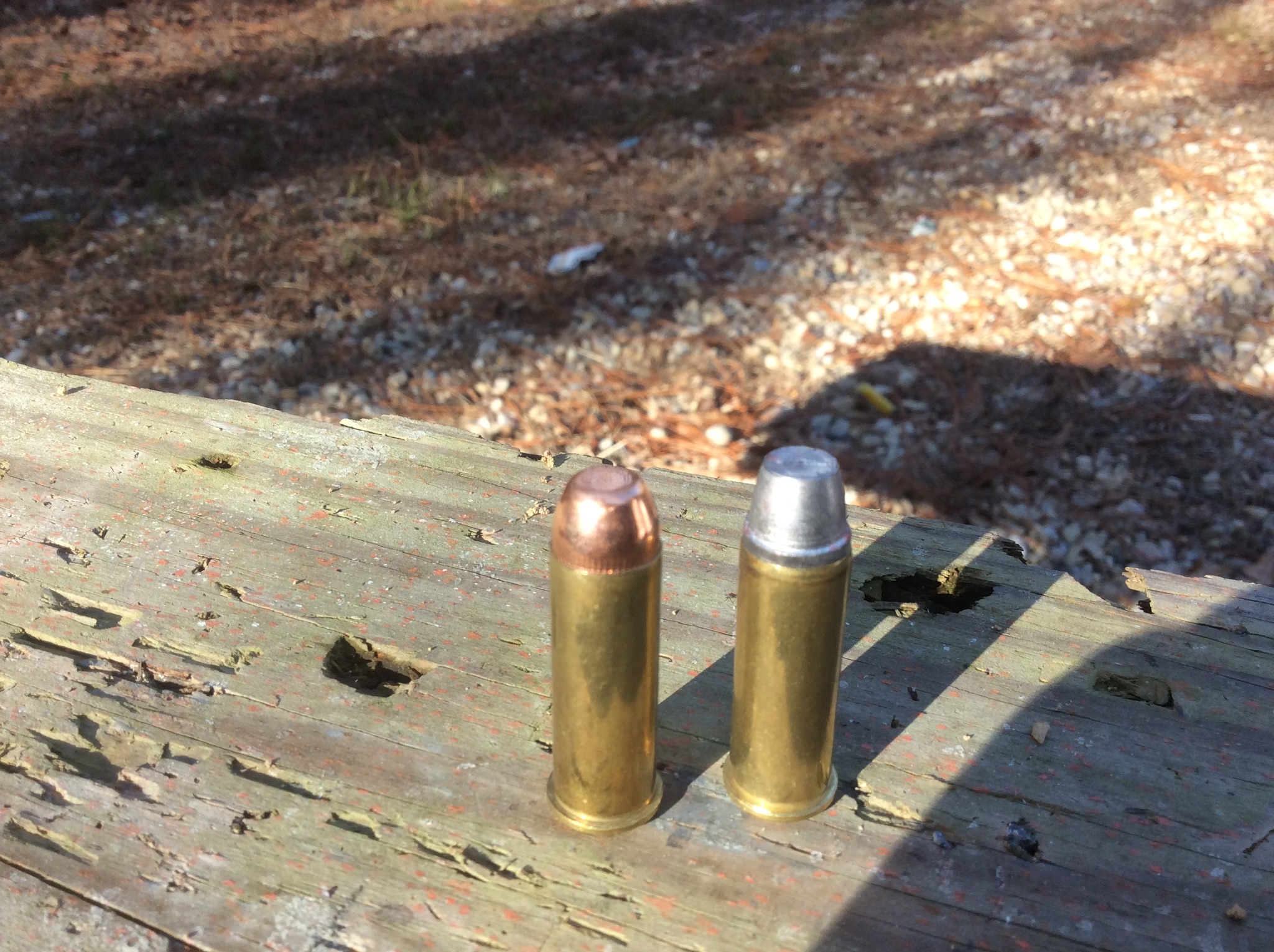

Yep to get the most fun out of shooting the large calibers like .45 Colt and .44 Mag loading your own is the way to go. I load for .44 Mag and Special among others and it is great to load them to the level you will most enjoy. For me I like mid level 44 Mag loads like a 240 gr. cast or plated bullet with 9 gr. Unique. I have a 1873 Uberti/ Winchester that just loves a 200 gr. Xtreme plated bullet with same 9 gr. Unique which is about like a top end .44-40 load. Find some back issues of Handloader magazine for the caliber you want to load plus read a good loading manual like Lyman.
I did a lot of research on loading equipment and went with the Dillon 550B since it was easy to change over to other calibers and the customer service is great when needing dies and such. Now I load for most all I shoot. Nowdays 44 Mag and 45 Colt can run you 50-60 bucks for box of 50 and might not be the load your gun will like.
However right now primers and some powders are hard to find and $$$ when you find them.
- loading 44 magnum today.jpg (649.19 KiB) Viewed 951 times
- 44 mag 200 gr xtreme and matts bullets 230 gr swc all with 9 gr BE-86 powder.jpg (763.3 KiB) Viewed 951 times
