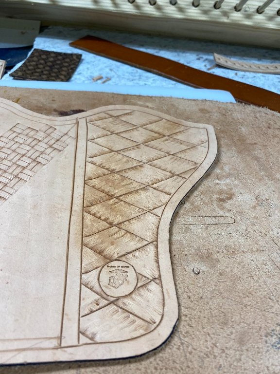

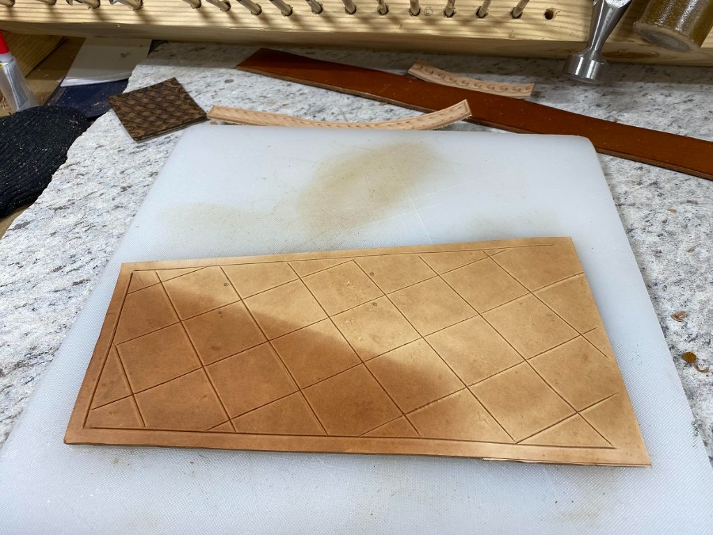

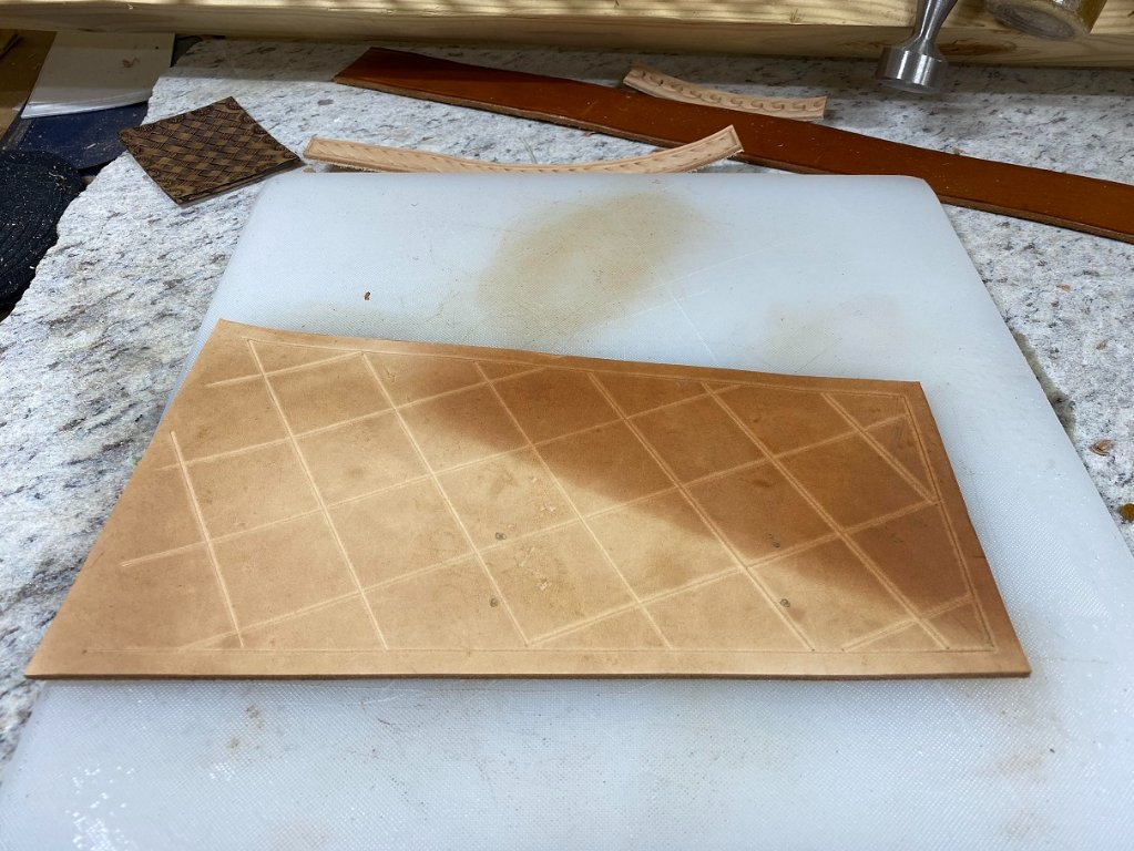

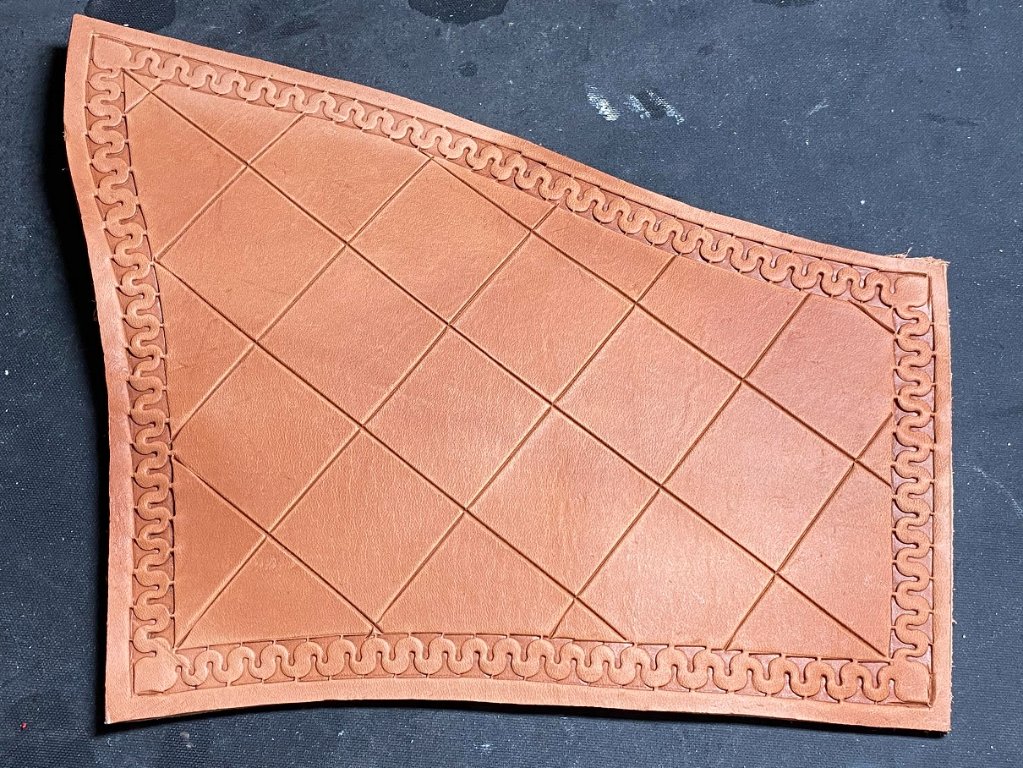

During another session in the shop, I laid out the second pattern on the back panel. I started by plotting the layout with the sharp stylus, cutting a thin line in the damp leather. Easy to see but no pencil marks to deal with.
05 layout.jpg (152.86 KiB) Viewed 770 times
Once the initial layout is in place, I sharpened the swivel knife and deepened each cut. Prior to each step, I spritz the leather with the spray bottle as properly cased (moistened) leather holds the work better.
06 cut in.jpg (167.72 KiB) Viewed 770 times

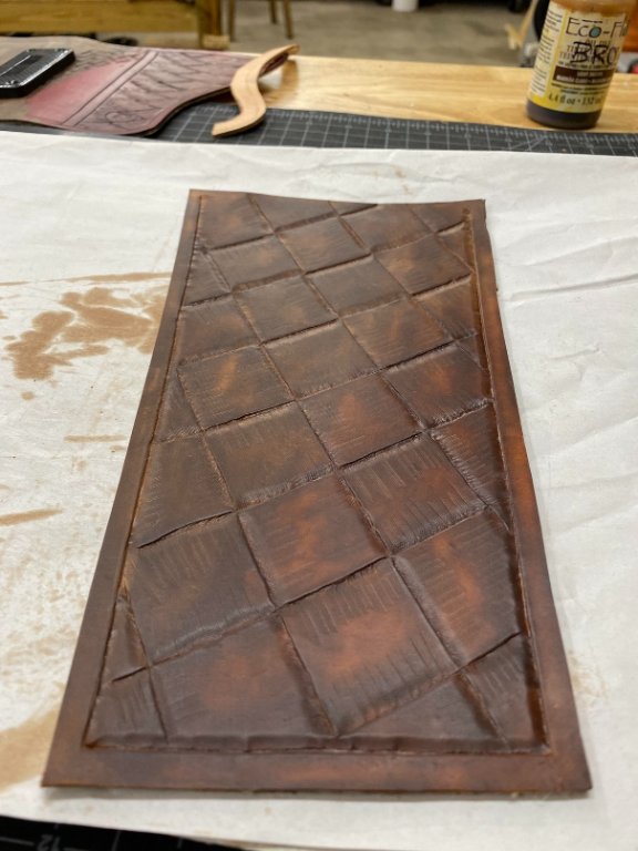

The next steps were the most important on the design and why I called it practice. I was going to be beveling all four sides of every square. two of each were beveled IN and two OUT and they alternate. Getting these right, and done well will make the pattern appear to be large basketweave. The depth has to be there and dramatic. It will take Practice and skill. It will have to be earned.
07 beveled.jpg (123.56 KiB) Viewed 770 times
Hmmm... not there yet, but we are beginning to see a hint of the basket weave starting to emerge. I still feel it's not a bad looking pattern for the backing panel. Next we stain and coat it in mink oil to preserve it's flexibility.
08 stained and treated.jpg (71.73 KiB) Viewed 770 times

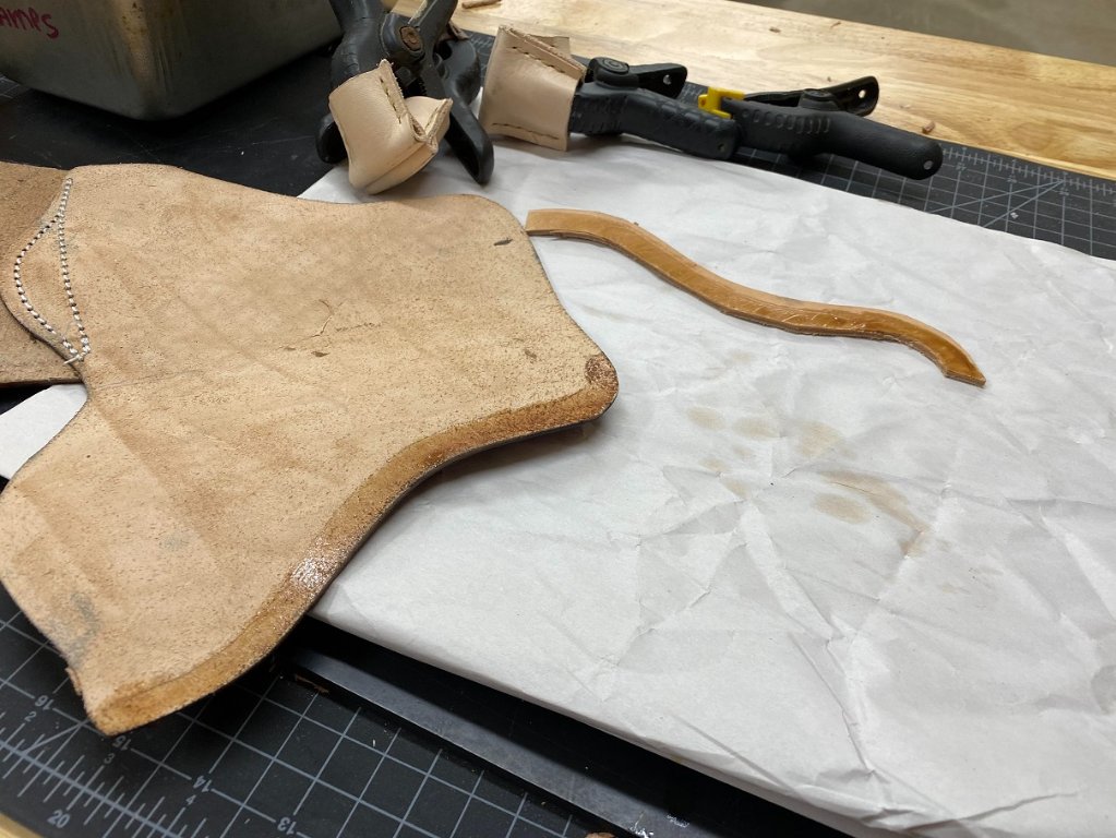

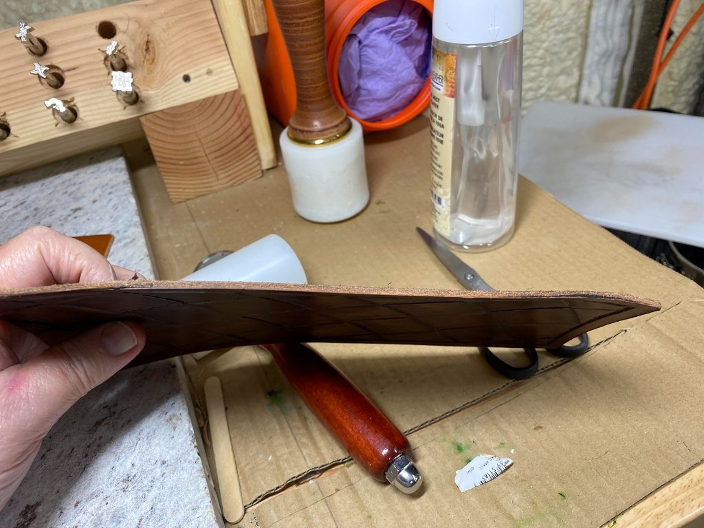

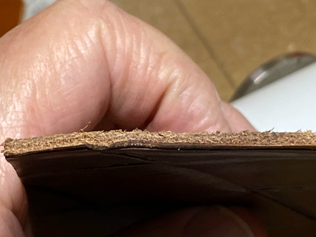

Next up, I burnished the edges of the back panel and the loop that will go around the bottom of the holster to hold it tight against the back panel. If you look at the edge of the back panel, you will note that the edge of cut leather looks suspiciously like a sponge. Untreated, like a sponge, it will absorb moisture, grit, and dirt and quickly rot or fail.
11 rough edge.jpg (140.4 KiB) Viewed 771 times
A closer look.
12 look closer.jpg (86.25 KiB) Viewed 771 times

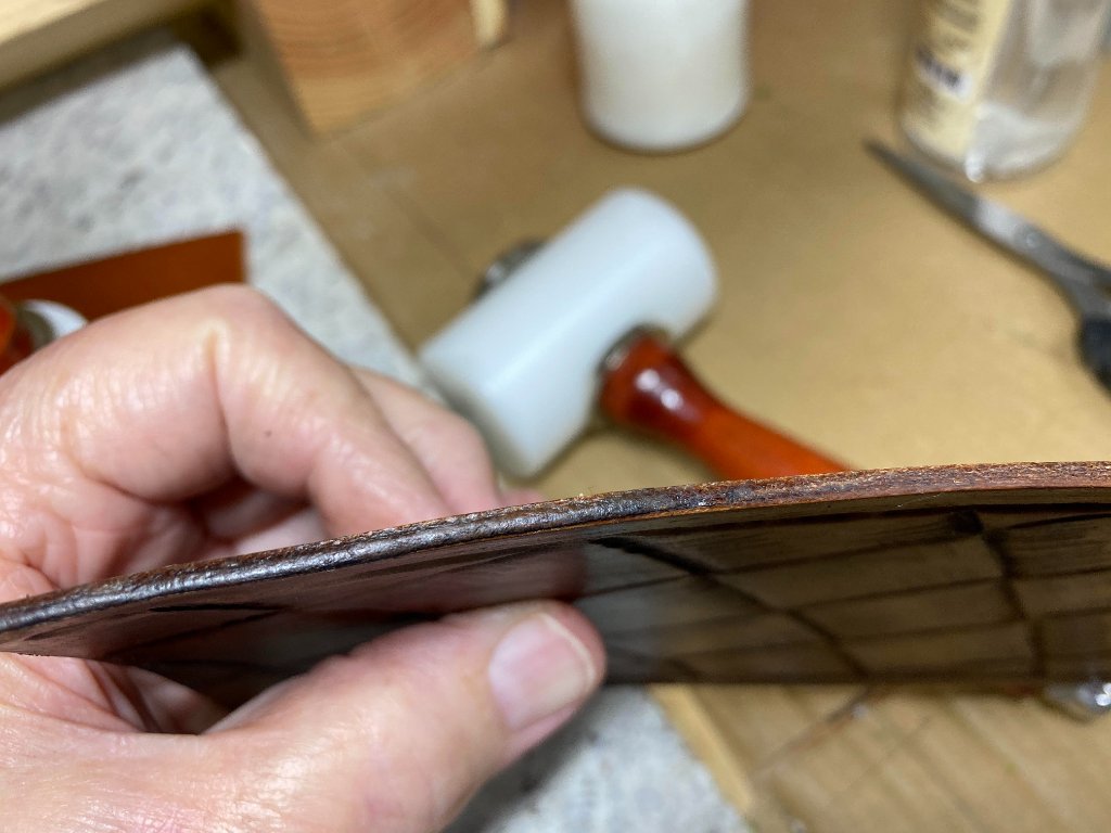

To burnish the edge, you lightly dampen the edge and sometimes add a burnishing compound, or simply a dab of finish. Then buff with burlap, or rub with a burnishing tool or the side of a screwdriver. It's not pressure, which would deform the leather edge, but the friction generated heat. Light rapid strokes form the burnished edge...
13 burnished.jpg (91.7 KiB) Viewed 771 times
Note the finished edge and fading into the partially buffed area.

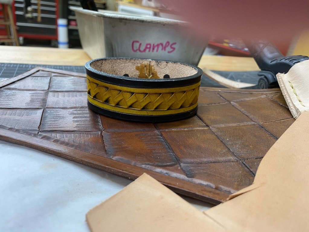

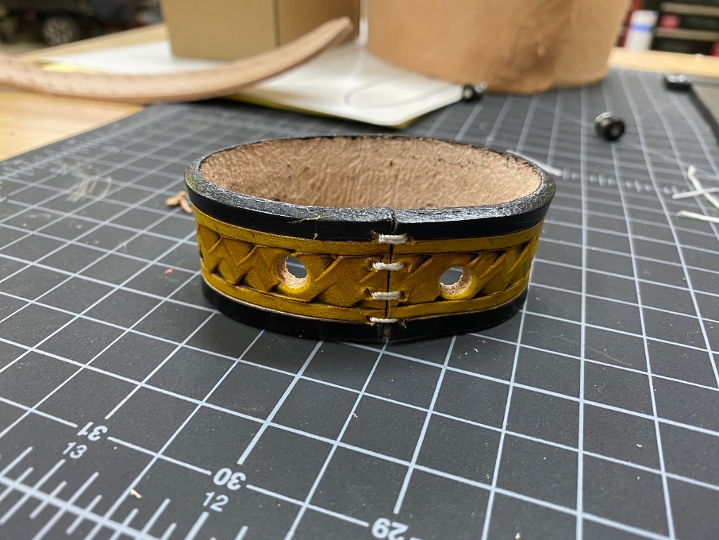

I took the antiqued loop piece, and punched matching holes in both ends, then applied a thin layer of contact cement to both ends. While that cured, I set up the needles and thread. I punched a hole in either end for Chicago screws to attach the completed loop to the back panel. Then I sewed the ends together using a baseball pattern.
14 a loop.jpg (148.79 KiB) Viewed 770 times
You might notice that the loop looks a lot better now, more subdued, after being antiqued. If you look inside, you'll note that I painted the stitches inside with a strip of Contact cement to help insure they were locked. The inside will be hidden by the bottom of the holster and not seen.
15 Looks better antiqued.jpg (136.55 KiB) Viewed 770 times

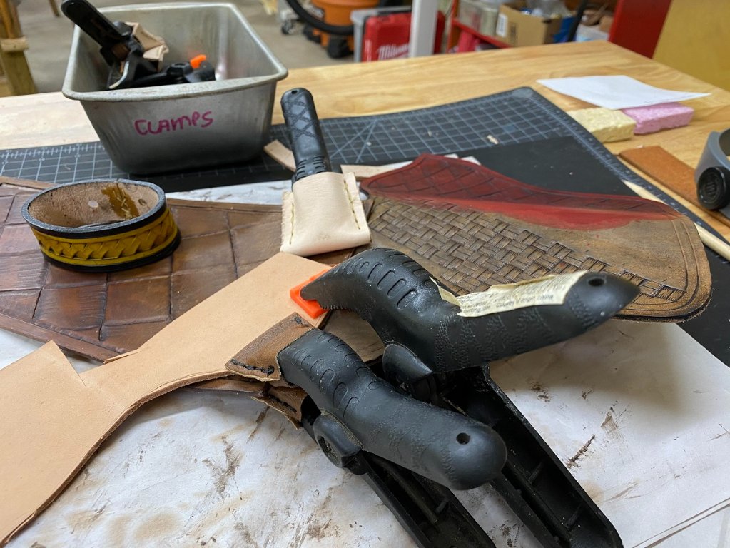

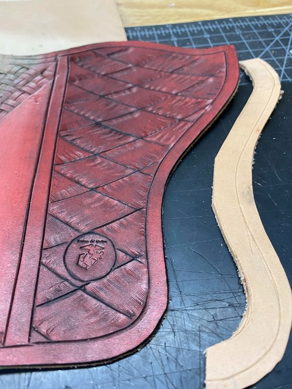

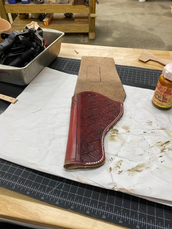

To start the actual assembly, I glued the top edge of the back panel to the back edge of the holster panel and clamped it. I'll sew this edge to lock it once it's cured.
16 started assembly.jpg (157.96 KiB) Viewed 770 times

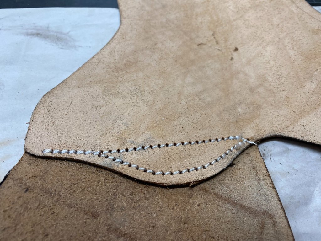

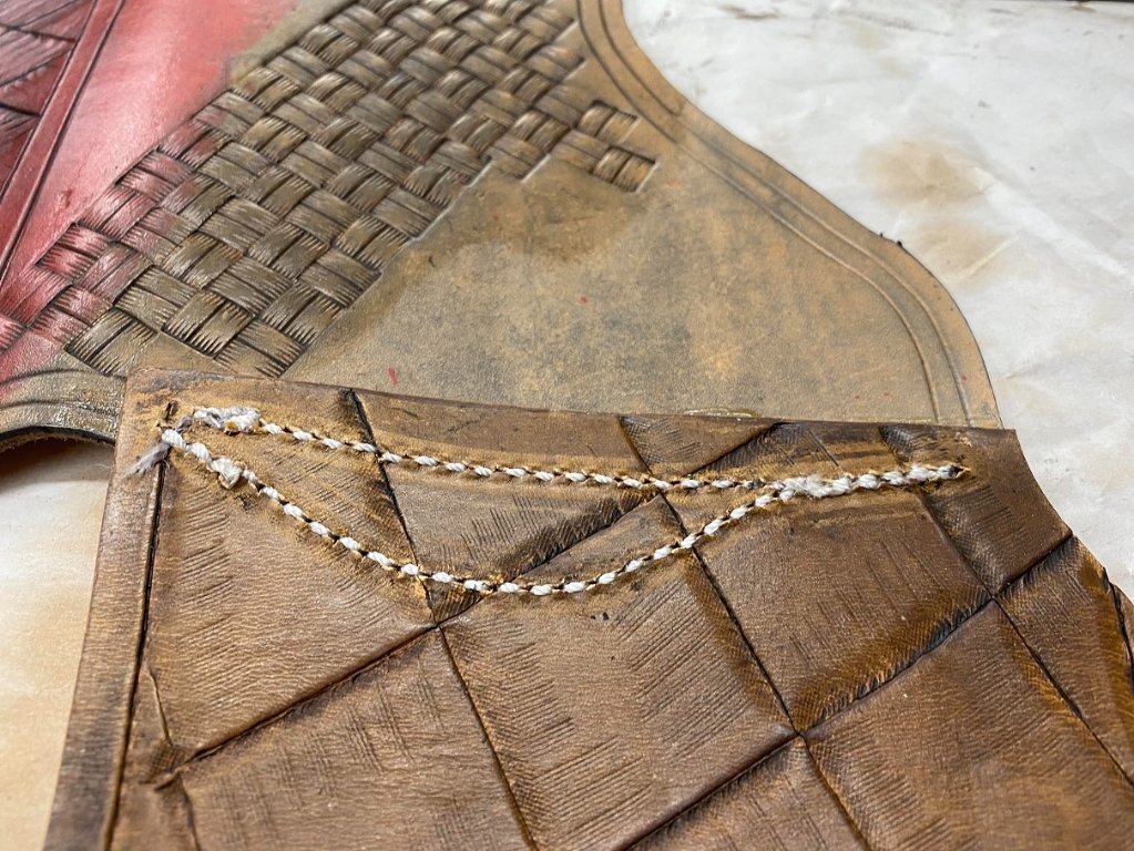

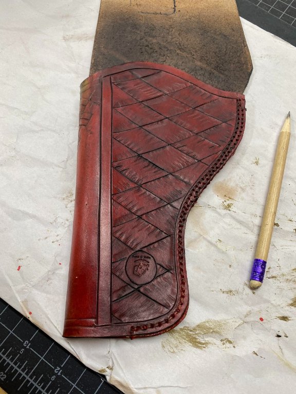

Went out this morning and took the project out of the clamps. First thing, sew the holster to the backing plate. It turned out pretty good. I need to burn the ends. ;) Duh.
17 sewn.jpg (161.81 KiB) Viewed 681 times
The machine left a little trail in the mink oil but that would buff out. You won't see it as it will be hidden by the fold. Anal, I'll buff it out anyway.

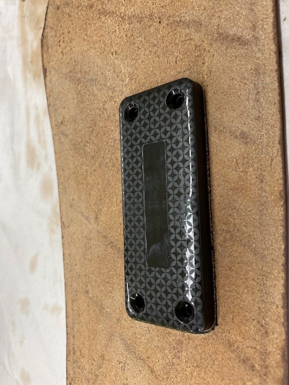

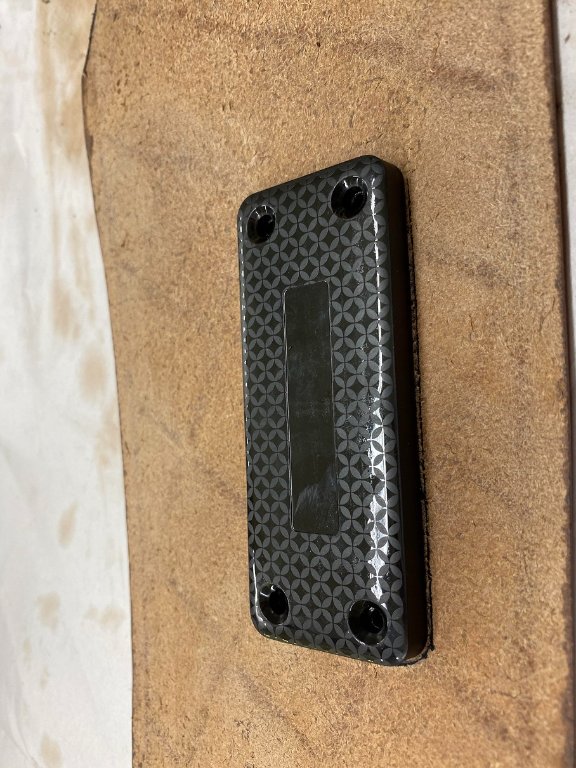

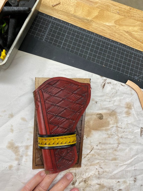

I have talked about the magnet I will use on several occasions, but haven't shown it other than laying on the bench in the background a couple times and forgot to point it out. Here is the magnet. It's meant to hold firearms under tables or against your bedframes. I have used them in the home in several places and they work great. They are non-marring rubber coated. TWO hold the wife's 410 pump up in a discreet location. You have to PULL to retrieve it. ;)
19 magnet.jpg (112.54 KiB) Viewed 681 times
This is a look at what the setup will look like, sorta. A mockup so to speak. I note that due to the fold you can see a bit of the unfinished back. Hmmm, guess I need to stain part of that. (Anal, again.)
20 mockup.jpg (107.32 KiB) Viewed 681 times

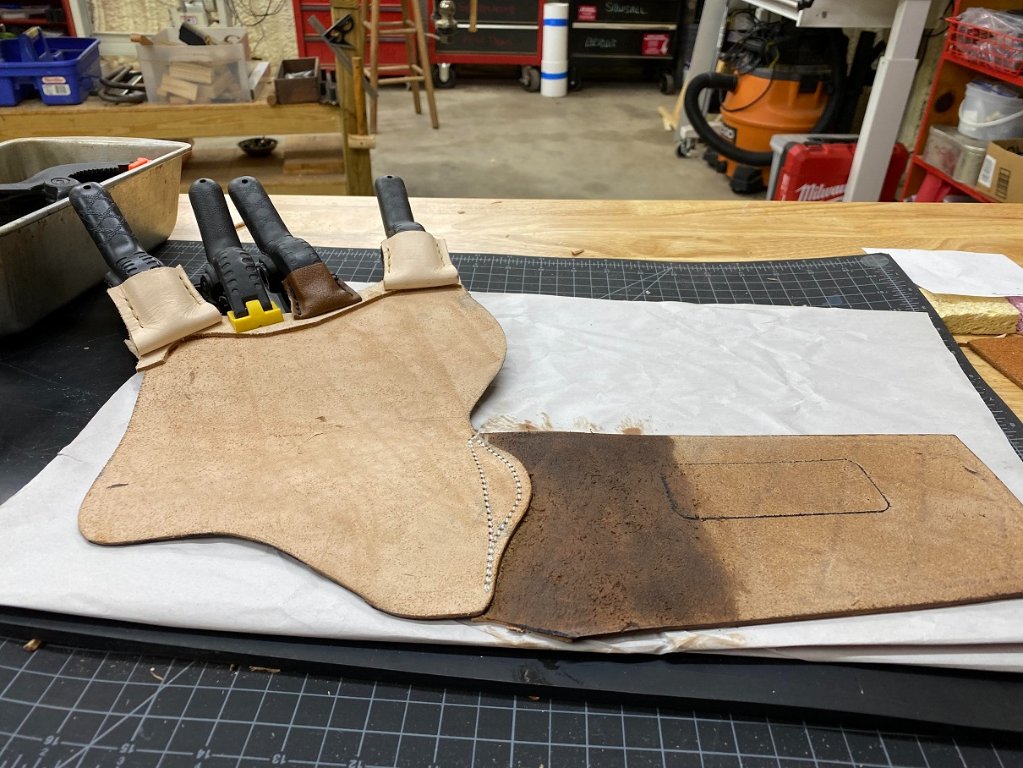

Now that I am ready to sew the holster portion together, I'll glue the spacer (Memory issues, I forgot what it's called... :oops: ) in place. contact cement on both sides will be given time to cure and then be carefully placed. It's spaced to insure the inside is properly aligned, but oversized on the outside so it can be trimmed.
21 cement.jpg (142.71 KiB) Viewed 681 times
In place and in the clamps... Wait, what's that, the back got brown dye spilled all over it, or was it dyed so it didn't look so pale compared to everything else. :twisted:
22 clamps.jpg (165.73 KiB) Viewed 681 times

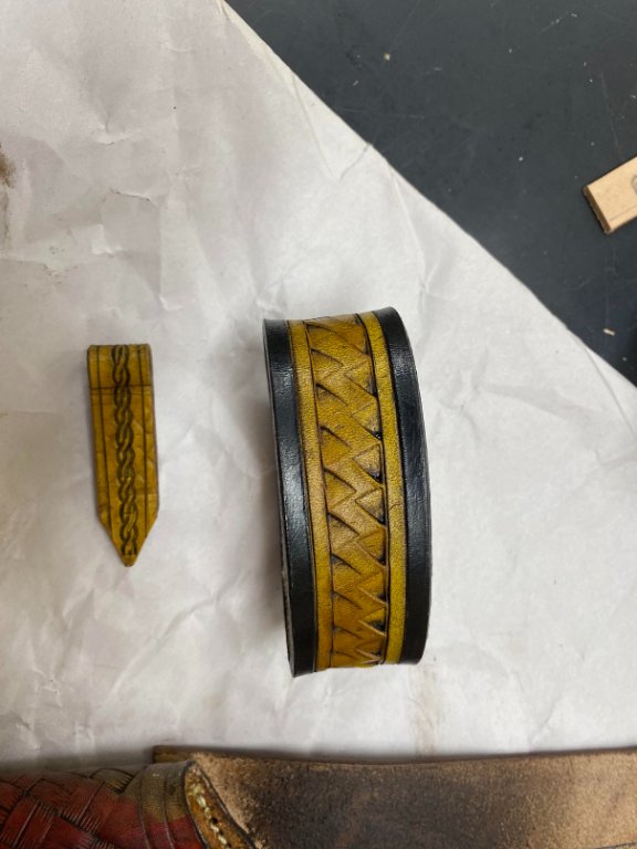

I dyed the stitching red to calm that white down, then antiqued the holster one last time, as well as the pull tab and holster loop.
24 dyed and antiqued.jpg (99.34 KiB) Viewed 673 times
The pull tab looks pretty good considering it was made from a scrap out of the junk pile. It will go on top of the lace that will hold the Wrangler in the holster by hooking over the hammer spur. This will make it easier to hook and unhook the loop.
25 pull tab.jpg (61.15 KiB) Viewed 673 times

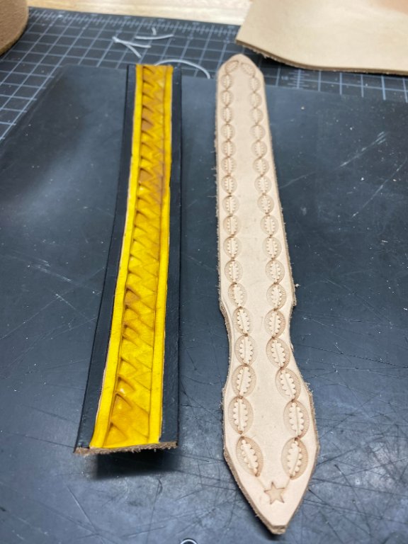

Went back out to the shop and looked everywhere trying to find hardware that would allow me to finish the project this evening. :P Yeah, yeah, I wanted to see the end of the project and try it out. So sue me. 8-) Try as I might I couldn't find proper hardware and I was going to halfa... um, half way do it. I'll have to hit Home despot and get the correct hardware. But, since I had walked all the way to the shop, You know, 30 yards... I decided to practice the tooling again, and prepped a piece of leather to make one more attempt at the large basket weave pattern. I had a heavy 7/8 weight piece of leather. Okay then... I cut off the rough edges, but for aesthetics left the natural curves it came to me with.
Then, I got a little carried away with the layout, and didn't get to the beveling tonight as the layout and border filled my HOUR limit on my arthritic hands. ;) Well, there is always tomorrow.
27 tooling practice.jpg (247.07 KiB) Viewed 669 times

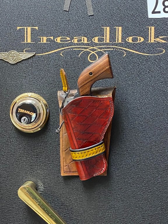

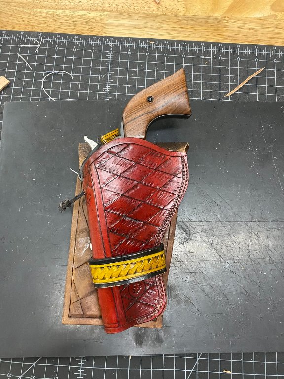

Got out this morning and started on the finishing touches on the holster. I mounted the magnet, now that I had the hardware, and finished off the hammer loop. I also added a couple holes to the bottom of the toe of the holster and sewed it to the back plate to insure the holster didn't move when you tried to draw. THAT magnet HOLDS the holster in place.
It looks good, I'm happy. It was a learning experience and the design flow changed as the holster progressed.
28 done.jpg (130.08 KiB) Viewed 655 times
Since that picture is on the bench, I thought you might like to see that the magnet would hold the weight. Here it is on the front of the safe.
To remove it you HAVE to slide it sideways and twist to start breaking the hold of the magnet. :twisted: You can't just pull 'er off.
29 magnet holds well.jpg (177.29 KiB) Viewed 655 times
Handed it to Tina and she immediately tried it on the front of the stainless steel fridge. Upright, then sideways. She loves it.
I can call this one DONE.

For those who might be interested.

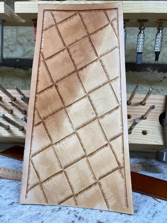

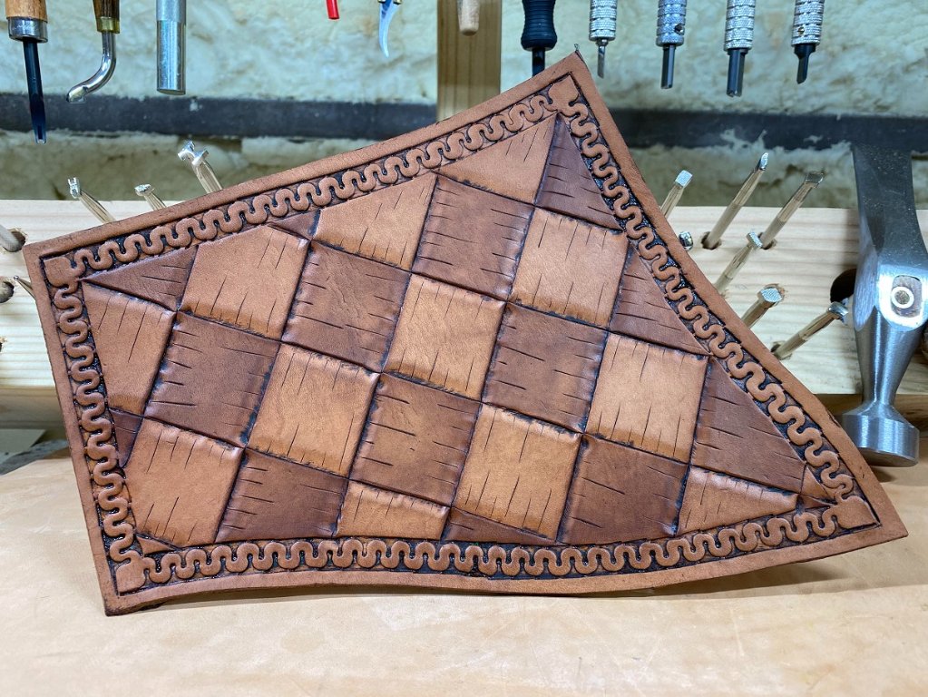

That practice panel? I did finish it to see how it would turn out. I won't do anything with it, just keep it around, but Miss T gave it a thumbs up.
