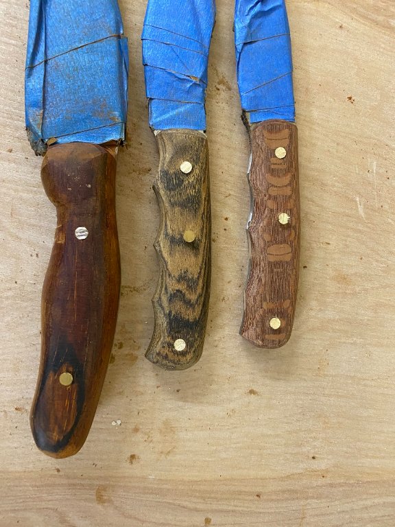

What I did was get back to work on the knives that have been sitting on the bench for nearly a year. I HAD been out to the shop once, about two months ago, and did some sanding on the three knives, ONE grit level belt worth, maybe thirty minutes, using the left hand only as a guide. This put me at the point where I needed to put the brass pins in place. I stopped, not trusting myself to do the work.

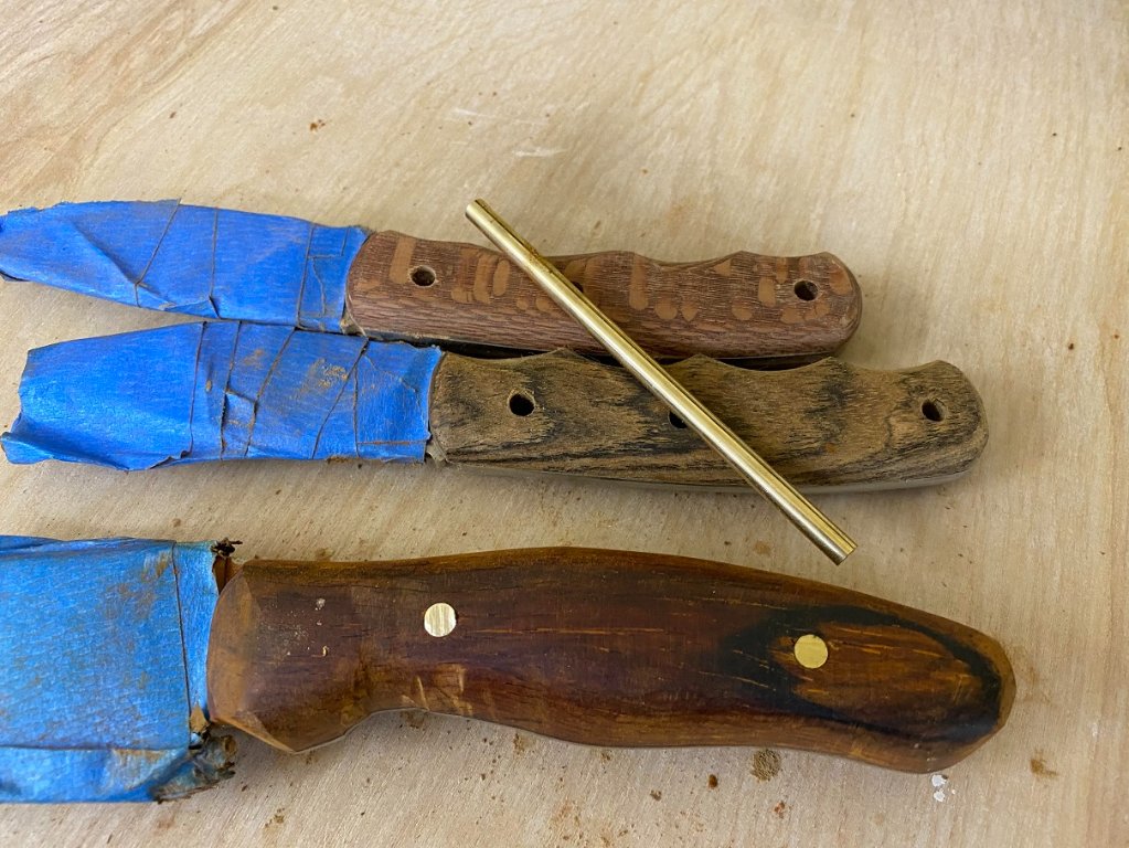

NOW, I felt I could do the work. I grabbed the assortment of brass rods and found the size that was slightly larger. 13/64. I got the bit and set up the drill press and reamed each of the eight holes to the proper size, VERY Carefully, taking my time. Then using a scribe, carefully marked the rod for each cut, clamped it in a vice and cut each pin to length, a fraction oversize. This way it can be glued in and sanded to flush.
brass pins c.jpg (173.86 KiB) Viewed 1029 times
You can see in the above picture the brass rod, the knife in the lower portion has the pins fitted, but not yet glued. The top two haven't been reamed on the drill press yet. I worked slowly but surely and got them all done. I had planned to glue them in place but after the job was done, my hand was telling me that detail work would have to wait. I'll glue them tomorrow, and sand them the next day. Or the day after. I am NOT going to rush this. They have been waiting a year, the job can take some time.

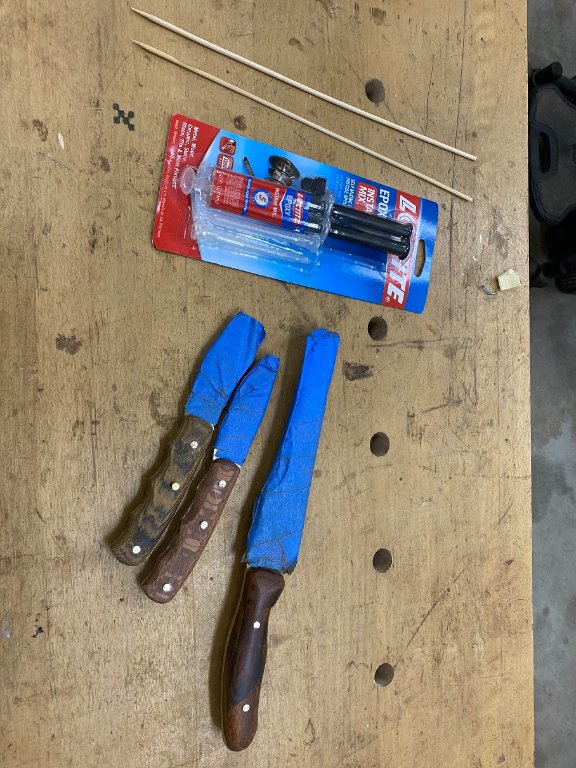

Back out in the shop on Monday to glue up the pins. Got the Epoxy out, and mixed a small amount, AFTER knocking out the eight pins and making sure to keep them in the proper order with the proper knives. :? After all, they were measured and cut for a certain hole in the certain blanks. ;) I used a couple bamboo skewers as my mixer and applicators to work with the five minute epoxy. The one thing I had forgotten in the year out of the shop was the smell of that stuff. :evil: I should have set up ventilation. Too late, just needed to work quickly and get OUT. :twisted:
gluing up pins c.jpg (123.67 KiB) Viewed 940 times
I got the epoxy mixed and then using the SHARP end of the skewer applied the epoxy inside the pin hole in the blank, then pushed the skewer thru the hole and coated the interior of the hole thoroughly. I carefully pushed the appropriate pin thru the hole, then insured it was centered in the hole with a bit of brass showing on each side. Once all holes were filled, I pushed the tape coated blade into the wooden vise at the end of the bench. The LAST thing I wanted to do was epoxy the knife to the bench. :roll: :(
I carefully, but quickly repeated the process with each blade blank until all eight pins were installed, and the three blanks were standing at attention at the end of the workbench, then rechecked the alignment, making minor adjustments until I was satisfied. Once that epoxy sets, there are NO adjustments. ;)

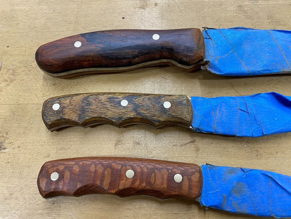

Today, I got out in the shop for an hour or so to sand down the pins flush and blend them into the scales. After a bit of work I was pretty happy with the result. The pins on the three knife blanks are blended flush, and although I'll be moving up in grits to do the final sanding, and working around the edges of the knives to insure the blanks are dressed... we are getting there. I can't use the belt sander on some areas, so strips of sandpaper and two handed buffing will be required. Probably 15 - 30 minute sessions with my bad left hand will be required. Don't know if I can handle much more than that. :D
pins sanded flush c.jpg (207.24 KiB) Viewed 896 times
Looking pretty good with the blended brass pins now.
Won't be too long until I can remove the protective tape. :)

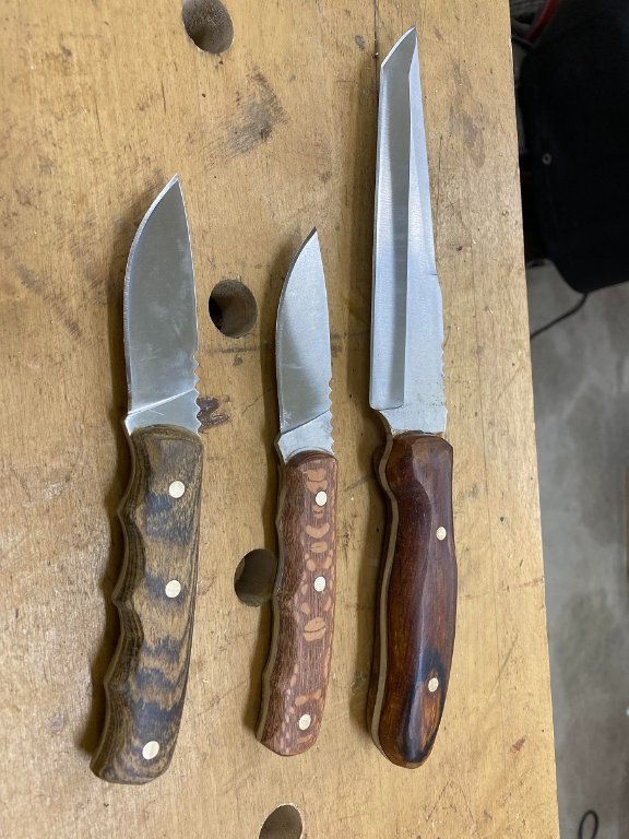

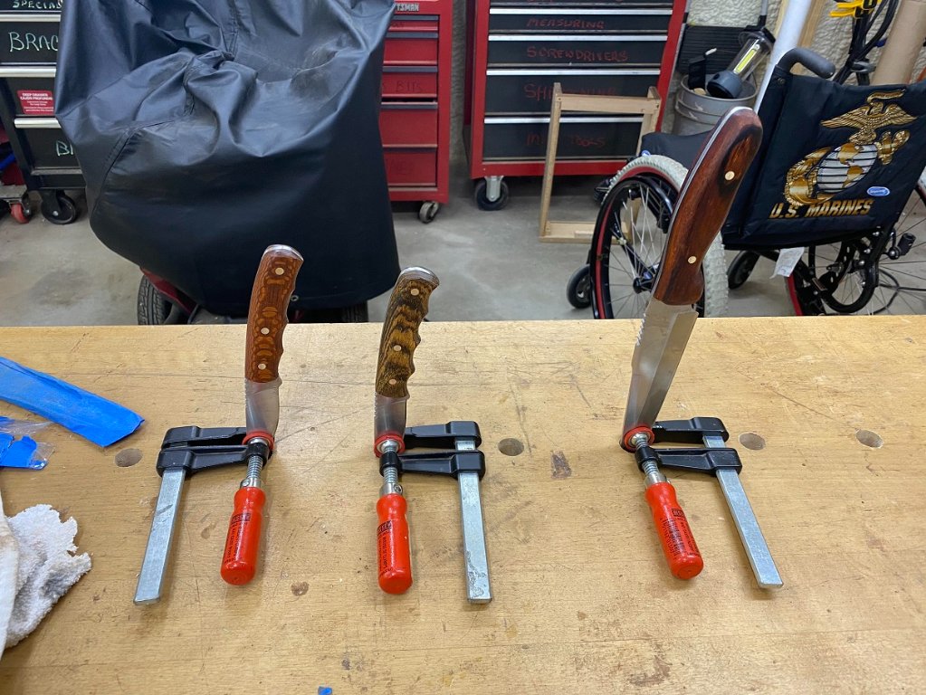

In the shop for a bit the last couple days. Yesterday I cut strips off the 60 grit and worked on the slots in the underside of the two smaller knives, and the underside of the front edge of the tanto. Today I cut strips off the 100 and 400 grit and polished what I had worked on until I was satisfied. Then using the belt sander, made a couple passes to smooth and blend with the 600 grit. Everything was looking good so I pulled the tape off the blades and wiped off the dust.
sanded c.jpg (102.97 KiB) Viewed 853 times
I was ready to apply the first coat of Watco oil. The Curly Cherry got a wipe down with Golden Oak.
The Small Cocobolo got Natural Watco Oil.
That dark cocobolo got wiped down with Medium walnut.
The oil will protect the wood and the chosen color will make the grain pop.

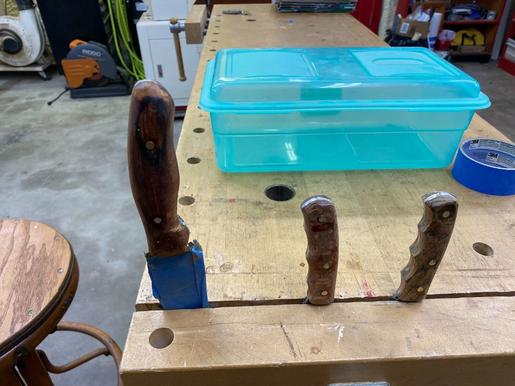

finish applied c.jpg (184.81 KiB) Viewed 853 times
They all got a small clamp on the end of the blade and placed vertically on the bench to dry.
They all will get a second wipedown with their Watco oil to insure deep protection.
Then beeswax coats and buffing.
So far they look pretty good.
