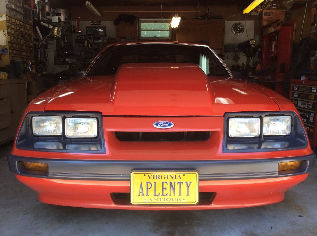

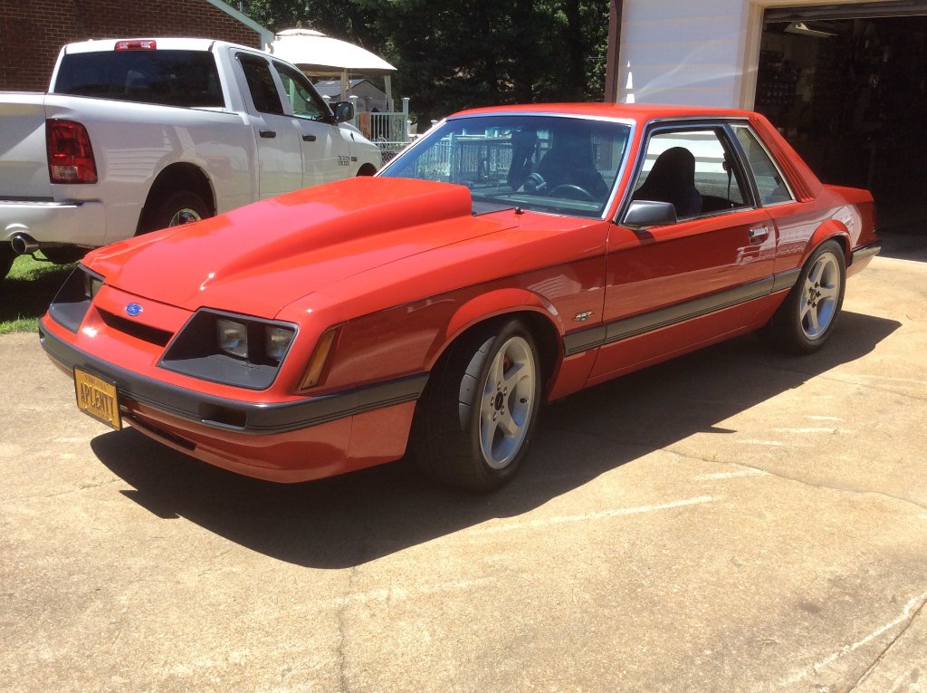

A beauty of a day to take the Lil' Beast out for a drive! :D
Just added the video...crank it up! :lol: https://youtu.be/GnIMOoEqzMc

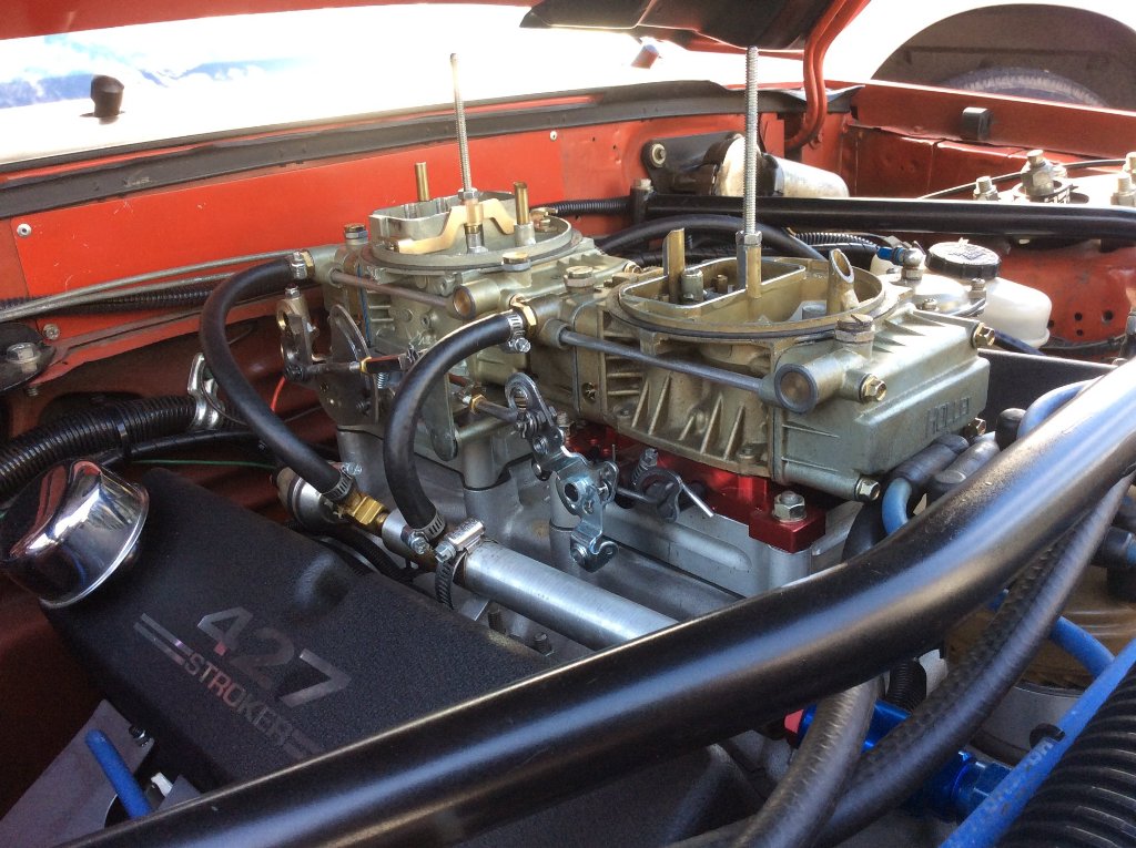

Do you have a special place to buy gas to make it run like it should.

Well I designed the build to run on 93 pump gas and that is all I have run in it. With 10.3 compression, aluminum heads and 200 psi cranking compression it has run very well and not tempermental at all. Cruises nice at 1500 RPM in 5th gear.

427 cubic inches of raw power.

Hey 40, nice wheels ! Looks lie early 80's maybe around 82.

Those wheels are the 1999- 2001 Cobra wheels I picked up almost 20 yrs ago...how time flies! Recently put those back on along with a fresh set of Nitto soft compound road race tires. Before that I had the typical skinny fronts and larger 275x50 15 drag radials on the rear.
I run the big 2003 Cobra brakes up front.
