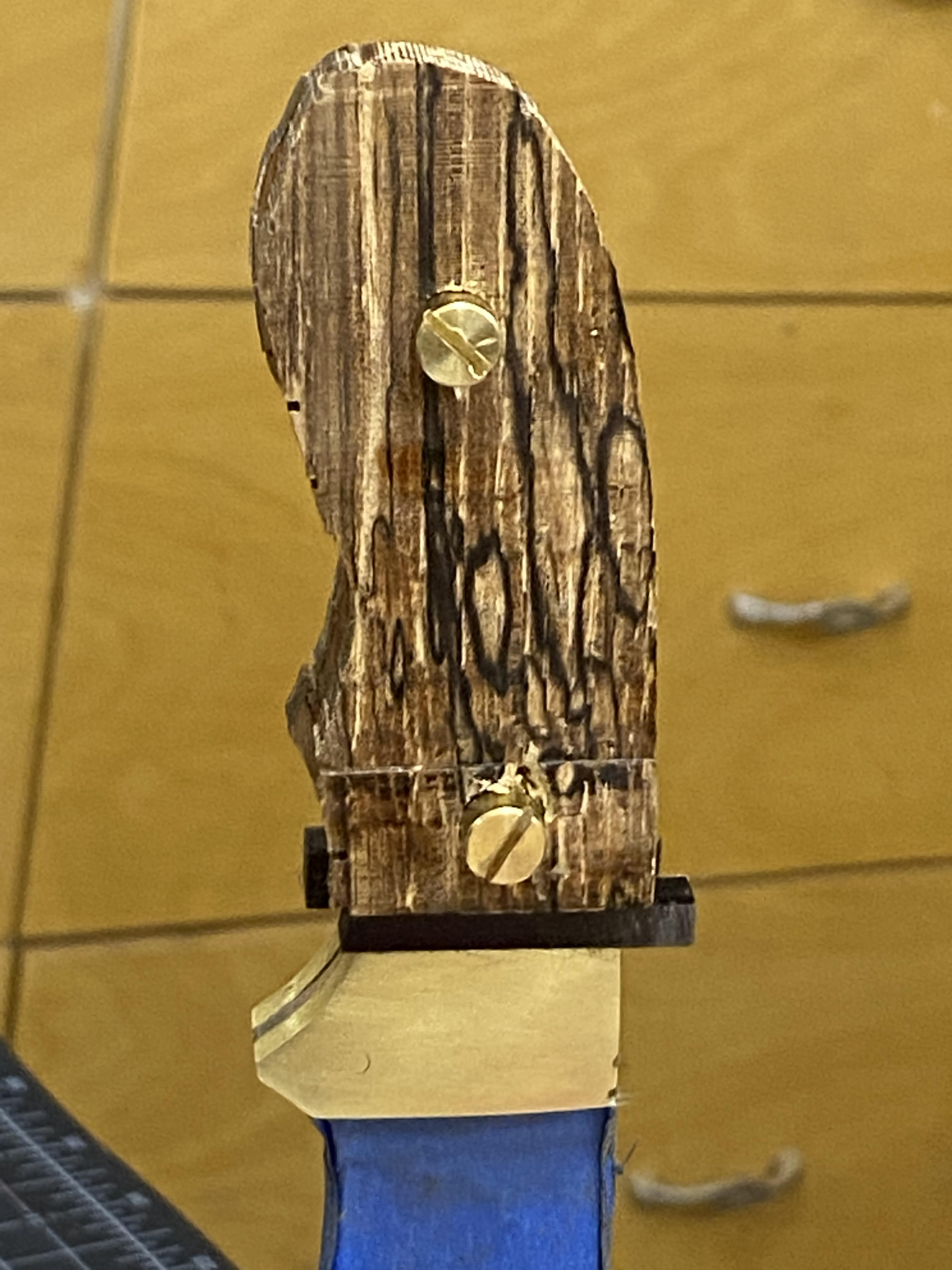

Was in the shop this morning, and set the scales on the Shawnee blank. Spalted Maple, with the Bone scraps from another knife as accents between the brass bolsters and the scales. A lot of trial and error hand fitting. :evil: But, we'll see how the finished product turns out. The Corby Bolts WON'T have the slots showing, you grind those off.
09 corby nuts and bone accents.jpg (683.03 KiB) Viewed 901 times
This will sit in the vise for several hours to let the epoxy set and then I can trim off the tops of the corby bolts, trim around the blank to remove excess wood and bone, and start shaping and smoothing the scales and accent. Once done shaping, the polishing will begin. We'll go to 800 or 1,000 grit, then move to buffing with rouge.
Then I have to decide on the finish. Tung Oil, Watco Oil, or just a buildup of wax to preserve the finish.

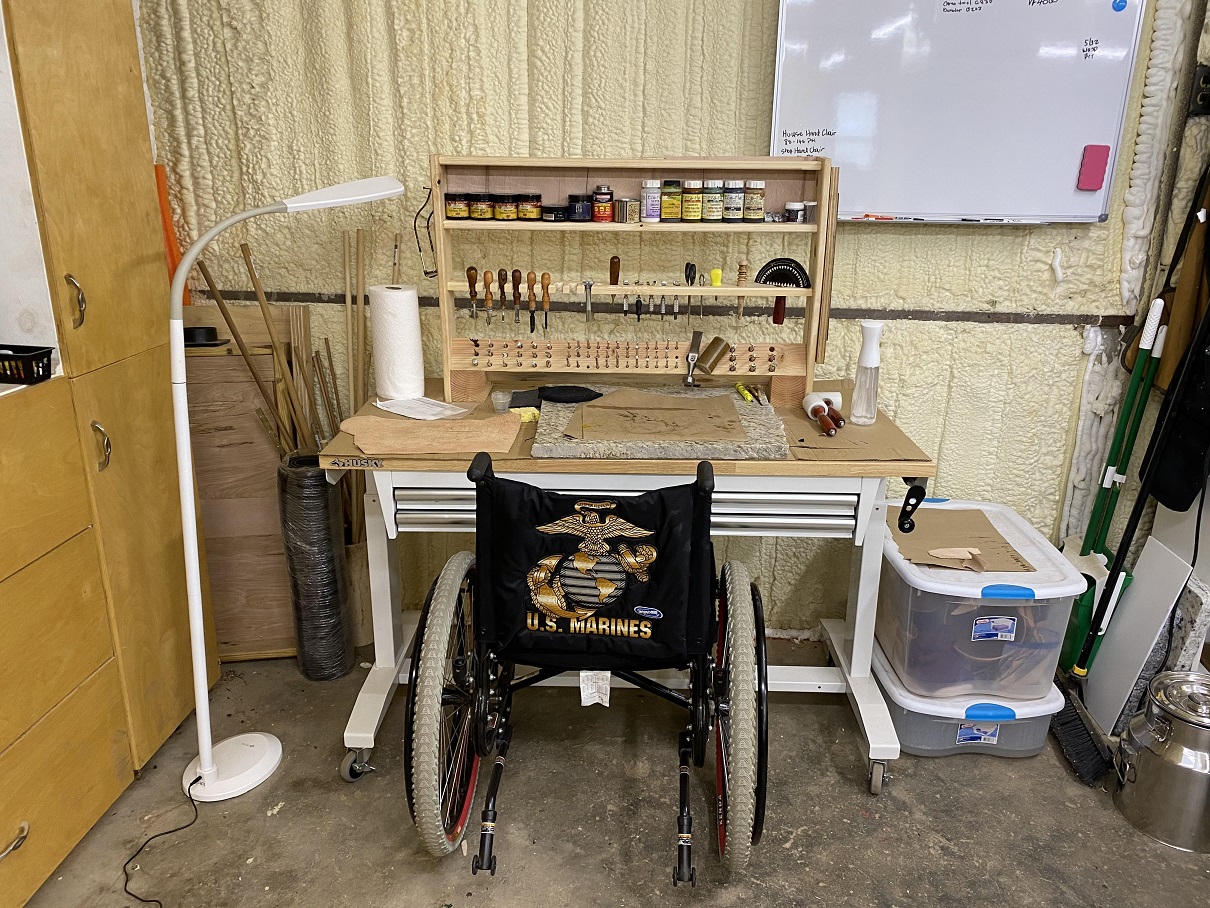

A look at the work areas in the shop.
The leather working bench... (There is also a similar Cutting Bench...)
15 my leather corner.jpg (514.12 KiB) Viewed 890 times

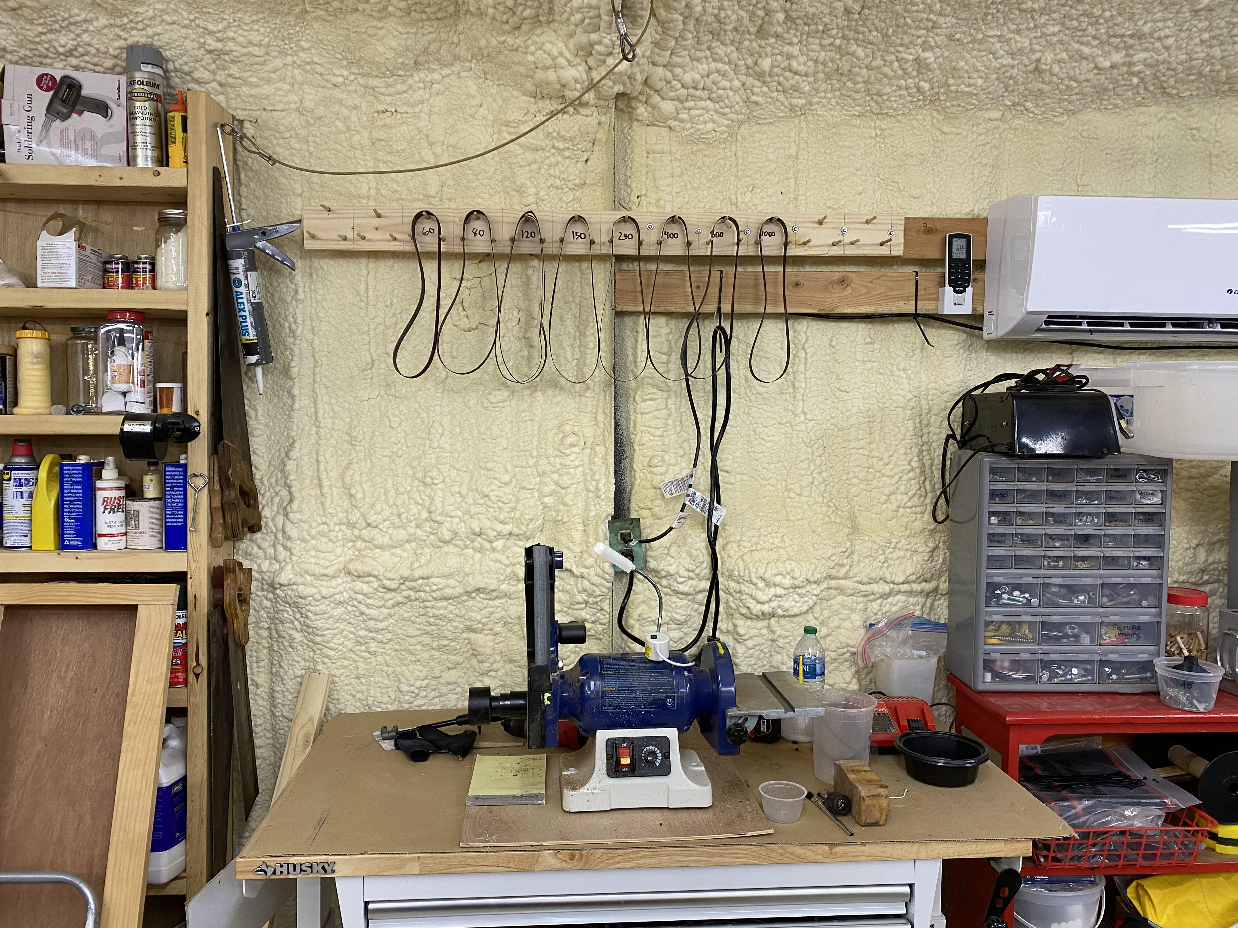

The Knife Shaping benches:
belt storage.jpg (1.97 MiB) Viewed 889 times
new knife working setup.jpg (623.44 KiB) Viewed 890 times

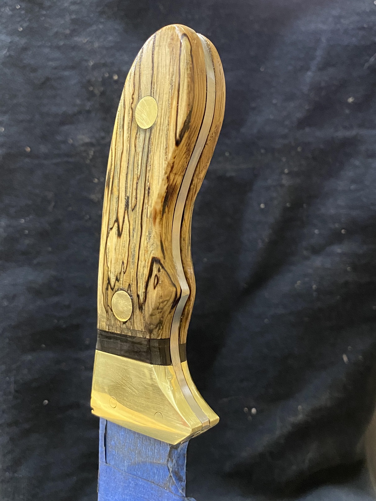

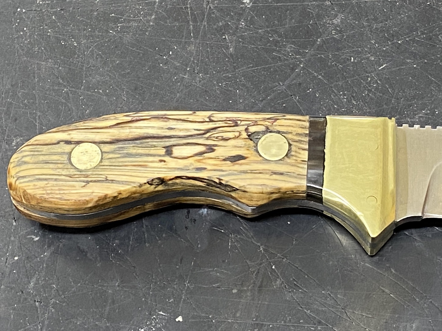

More work on the knife. Using dremel buffing heads, and rouge in various grades, I polished the brass and bone on the knife. A learning experience. Not as easy as I thought. :? This will take some experience. The final step was to coat a strip of leather with the finest grade rough and buff some more.
Then I worked the Maple with three coats of Watco Oil in Golden Oak to bring up the grain pattern. After that cured overnight, I applied a coat of Amber fly rod varnish. I'll work up three, four, five coats. Wet sanding between coats to insure it's smooth.
So far, it's looking promising.
12 stained and varnished.jpg (618.95 KiB) Viewed 877 times
I just need to get those last fine scratches out.

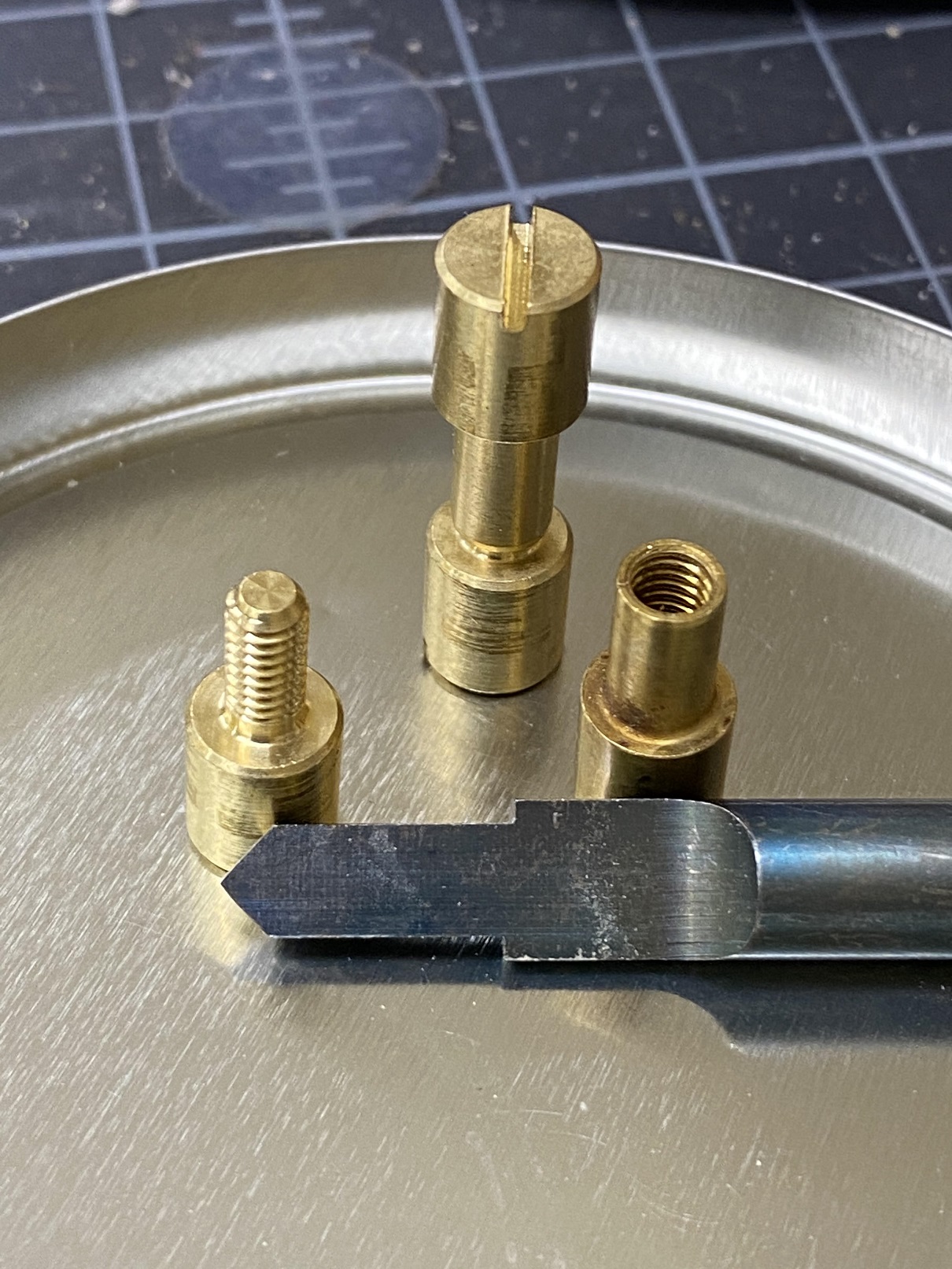

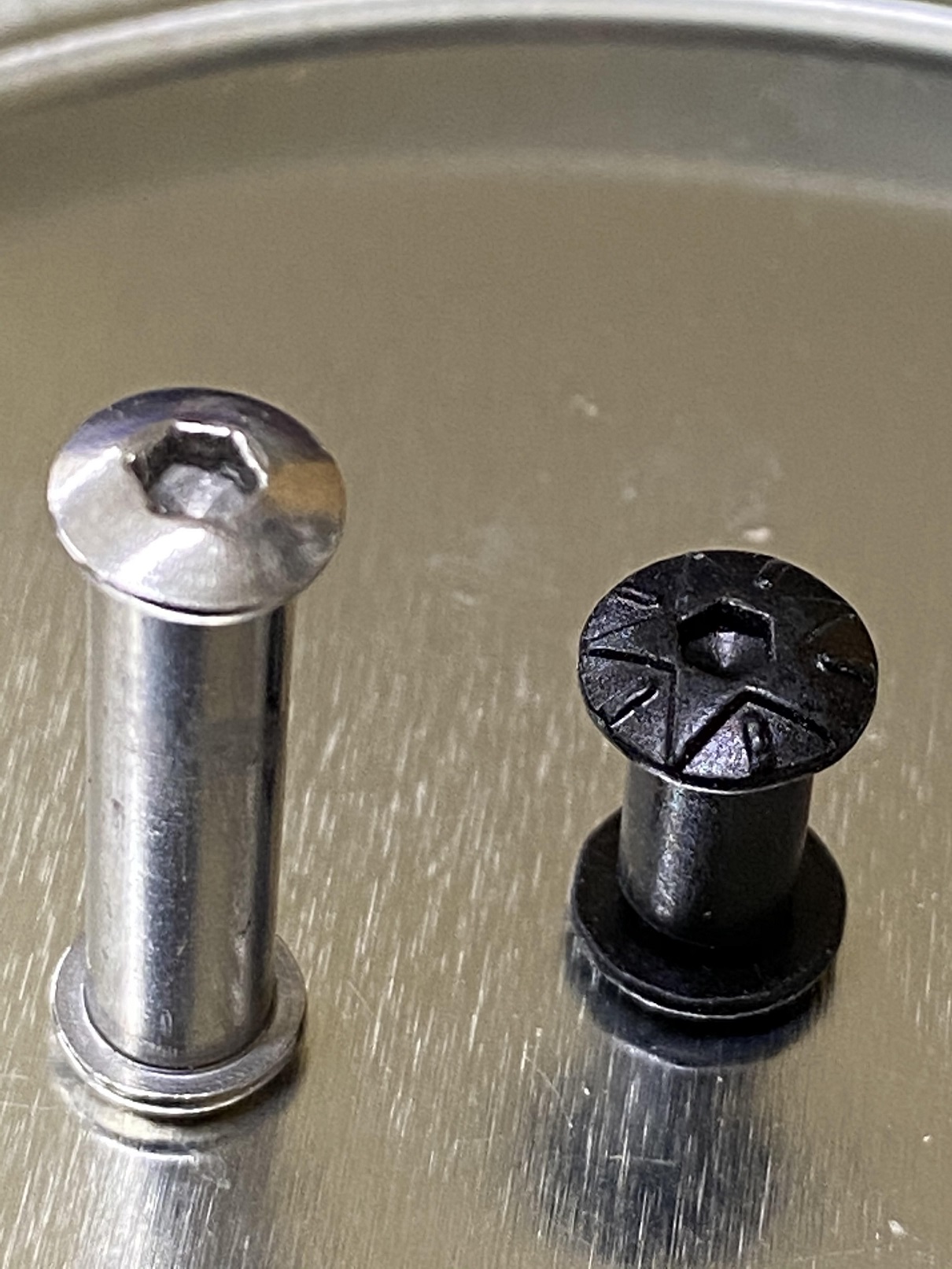

Here is a look at Corby Bolts before they are installed. Note that they come in two pieces, and are screwed together. They come in various sizes with varying shaft thickness and shoulder thicknesses, and varying lengths. They are MEANT to be installed and then the heads cut off and polished smooth. You can get them in brass, nickel silver and stainless. The length of the threads allow for some leeway in the thickness of your handle material as you shape them.
01 corby bolts.jpg (574.16 KiB) Viewed 742 times
When you order the Corbys, the narrative will tell you which step bit you need. It will drill the hole for the shaft and the shoulder. For me that's always a pucker factor. I always insure the rounded side of the bit is against the edge of the pilot hole so I don't end up with the work wasted when I fail to center the holes in the scale. No, No I haven't made that mistake... (More than once.) :evil:
02 with step bit.jpg (544.18 KiB) Viewed 742 times

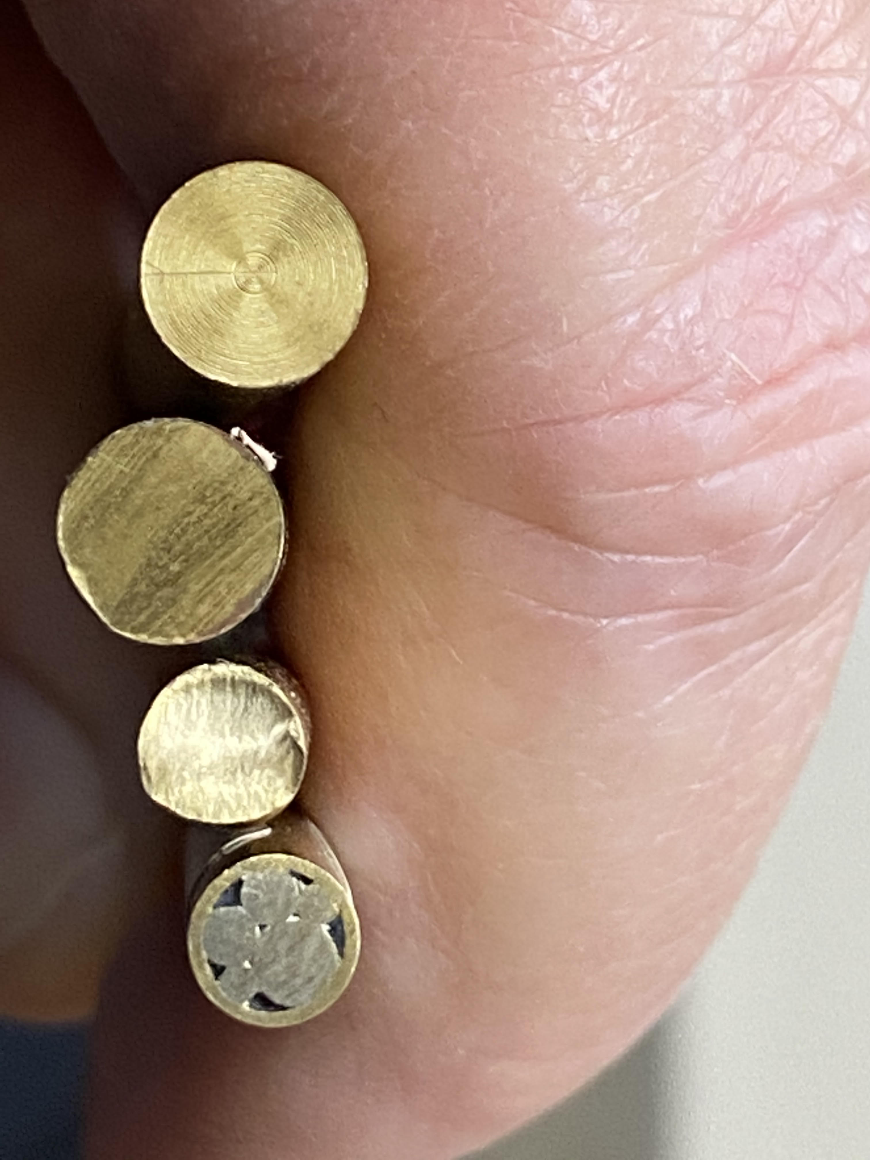

Another option would be Rod Stock. You can order this in Brass, copper, Nickel, Silver, Stainless... the possiblities are endless. It comes solid, hollow to use for lanyard holes in the base of the knife, or as Mosaics, with patterns filling the hollow ends. Some may remember I used mosaic pins in Miss T's Ivory Scaled Knife. The Bottom Rod in the pic below has a dog print mosaic pattern. You can get Batman, dragons, anvils, stars, Texas, whatever.
04 brass rod stock and mosaic.jpg (496 KiB) Viewed 742 times
There is a downside. The Mosaic rod for Miss T's knife was about 12" long....
05 problem with mosaics.jpg (412.75 KiB) Viewed 743 times

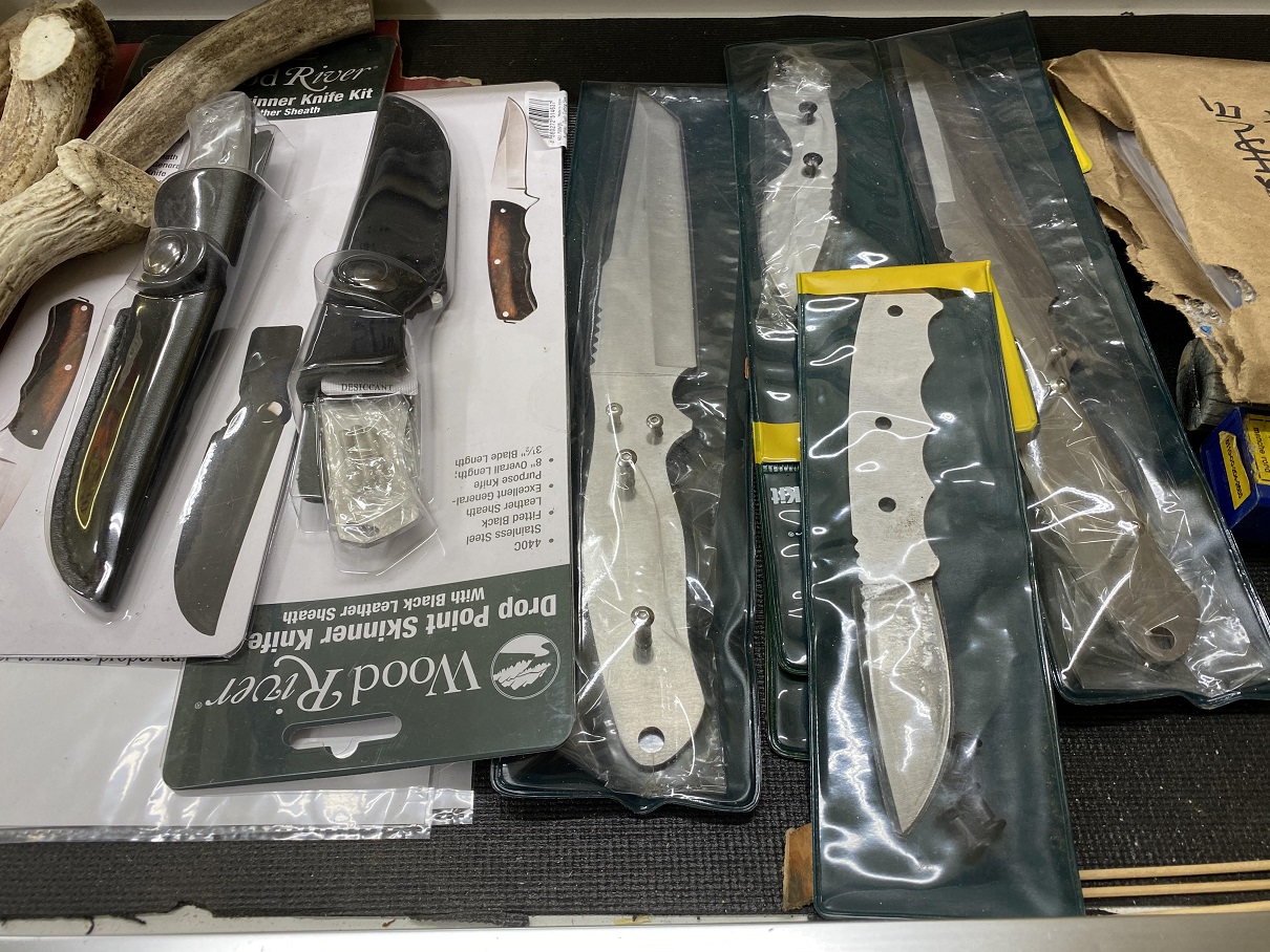

If you watch for sales, you can find kits at really good prices. Woodcraft sent me flyers all the time in VA and I loaded up on kits when they marked down several of my favorites to clear old stock at the end of the fiscal year. 50% to 70% off.
07 woodcraft blanks and kits.jpg (471.07 KiB) Viewed 743 times

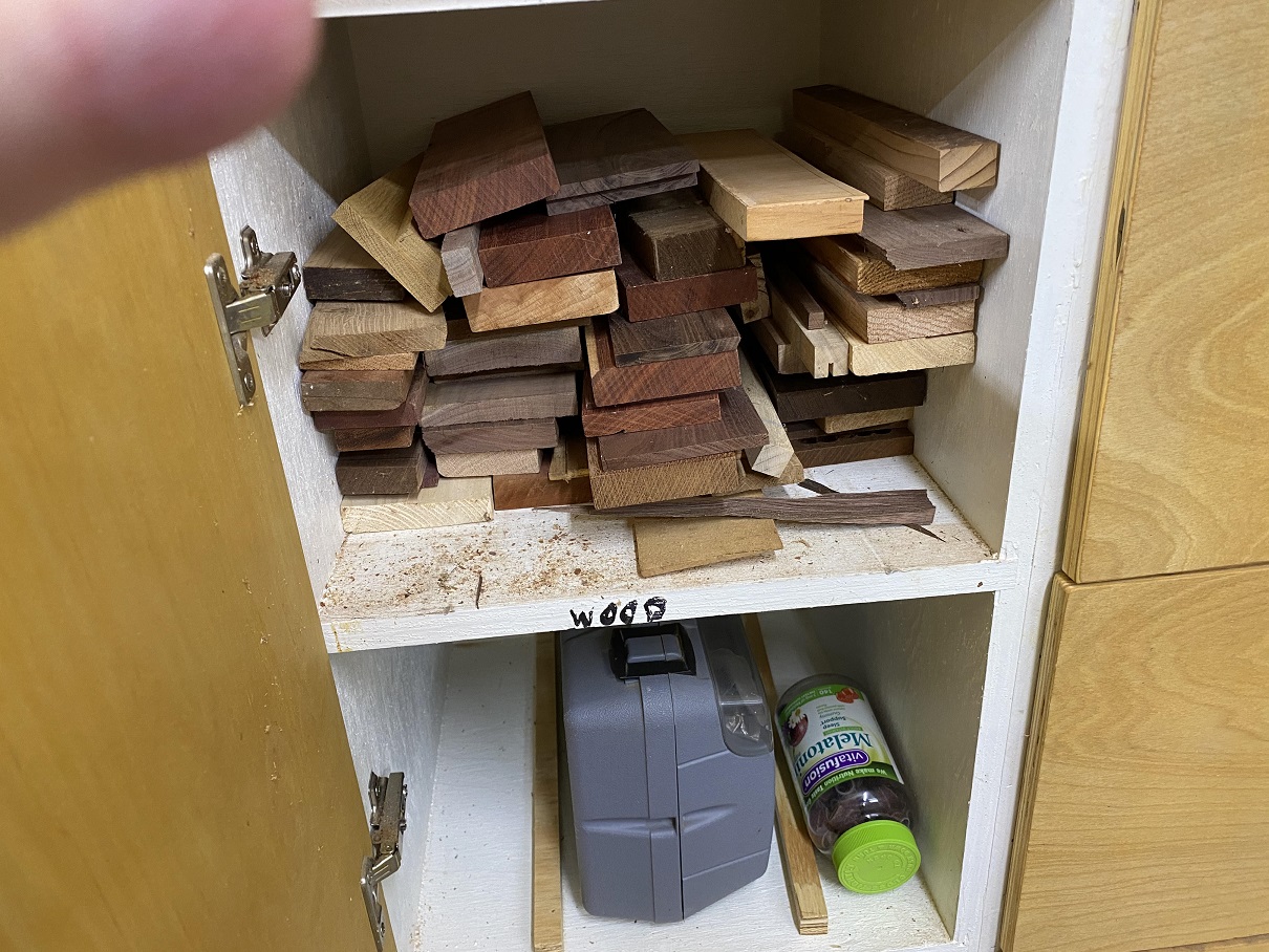

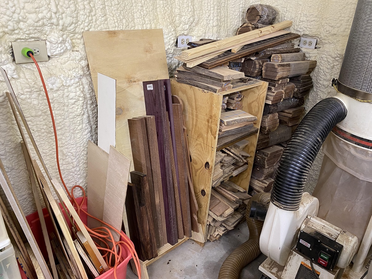

Being a woodworker first helps as I have a corner in the shop with some really nice woods. That stack in the corner is made of of wood cut on my Bandsaw mill. It's spalted maples, osage orange, black walnut and more. the vertical rack holds all kinds of sweet stock. Lacewood, black cherry, curly cherry, cocobolo, purpleheart and more. I didn't rush out and buy it all at once, I picked up a piece here and a piece there. Miss T couldn't believe I moved all that WOOD from VA. I told her it was worth more than she could imagine, at least to me.
09 wood corner.jpg (557.24 KiB) Viewed 743 times

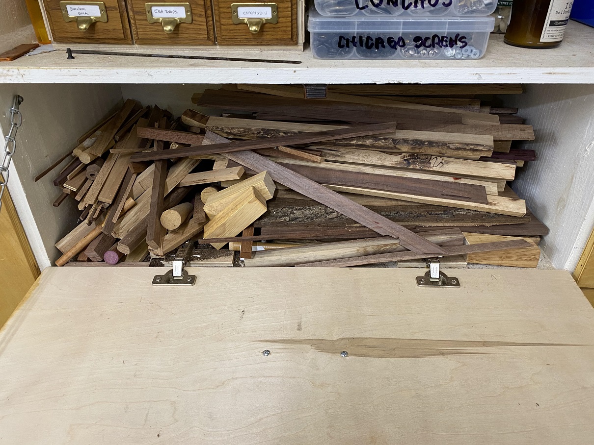

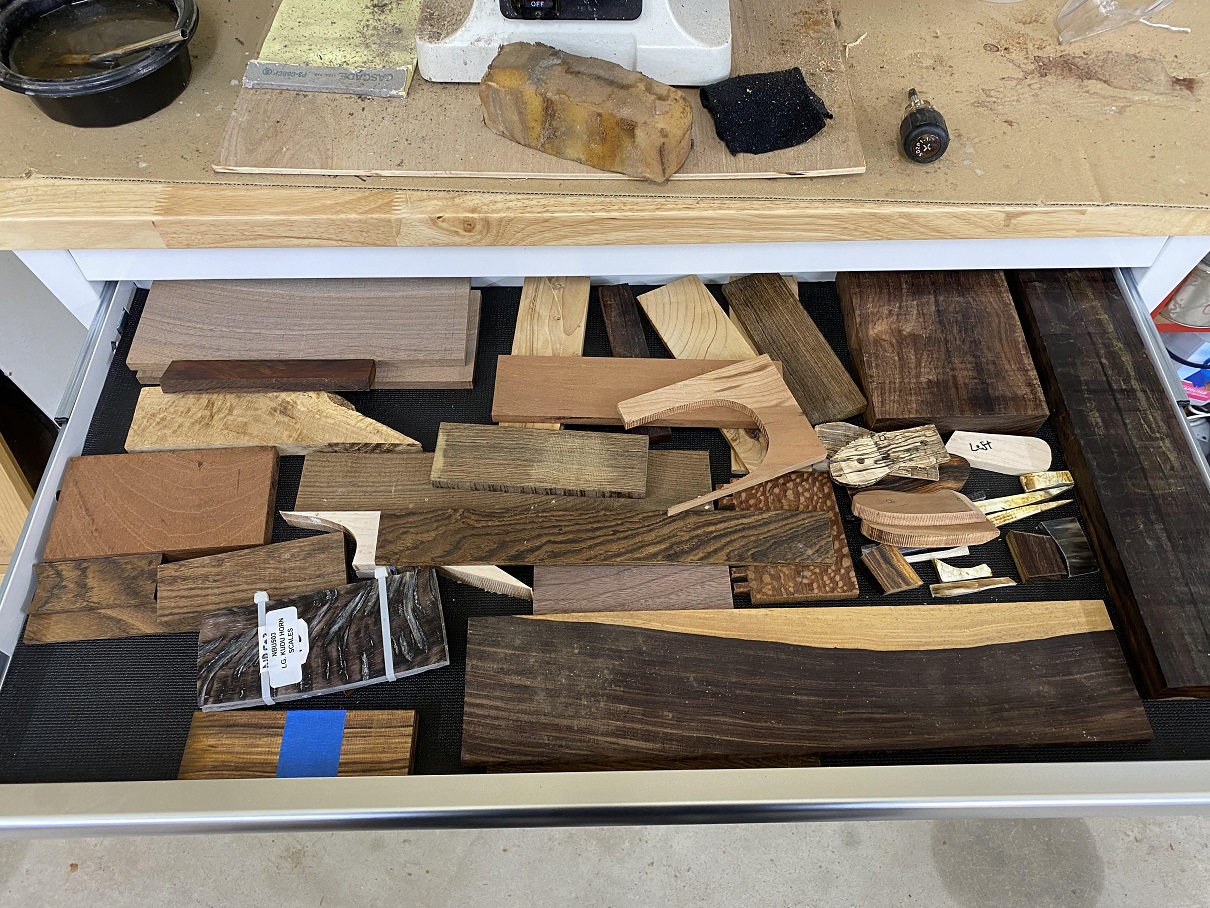

Last but not least is my scrap cubby. These are the scraps too good to toss. I can't tell you how many times I have used scraps from this bin to repair major pieces, make trip, or create inlays, keys, or accent strips. I don't keep every little piece like I did when I started, but the good ones...
11 too good scraps.jpg (440.34 KiB) Viewed 743 times

Got the final polishing done on the brass with the Black, Red and Blue rouge. Looked Good, so I waxed the bone and Maple and let it dry while I worked on the sheath, then buffed it out. I'll likely put one more coat of wax on it.
15 brass buffed and scales waxed.jpg (497.24 KiB) Viewed 722 times

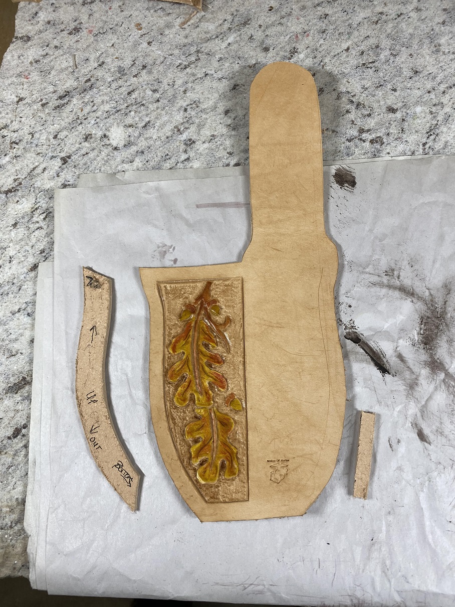

On the sheath I did the background tooling and dyed the leaves and acorns. Once that dries good, I'll put a coat of resistance finish on it, let it dry then antique it.
16 dyed.jpg (409.06 KiB) Viewed 722 times
A long view of the sheath gives you an idea of the design. The extra pieces are welts that go inside and on the edges. These protect the stitching from the blade and insure the knife sits properly when inserted. They are first glued in place, then stitched.
17 long view.jpg (527.13 KiB) Viewed 722 times
