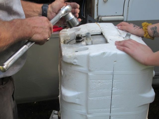

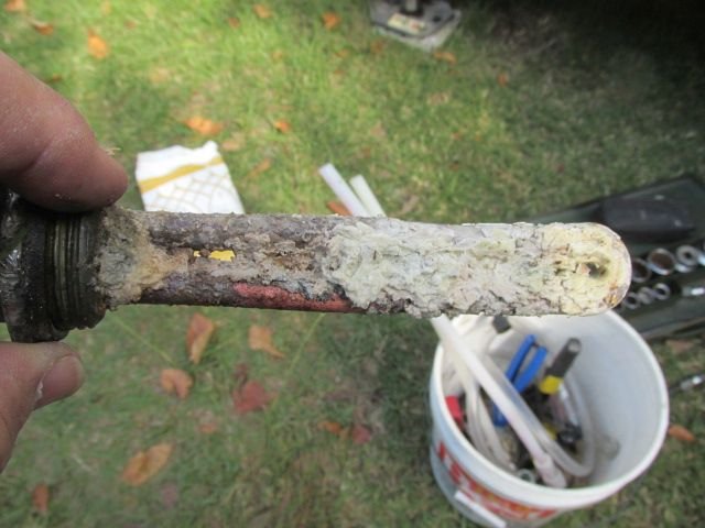

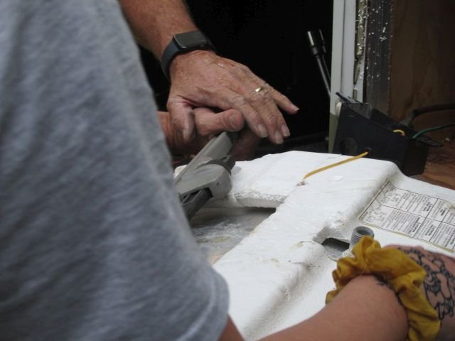

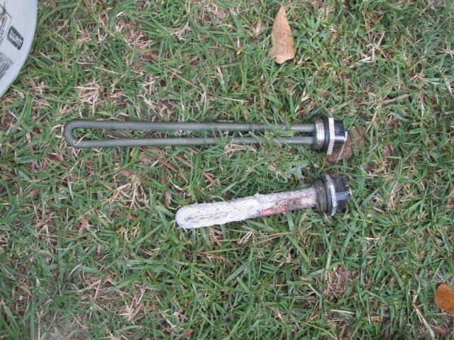

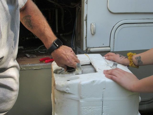

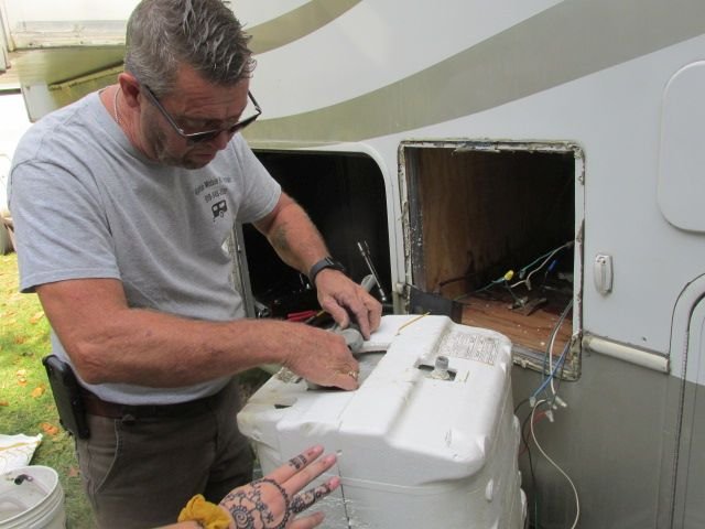

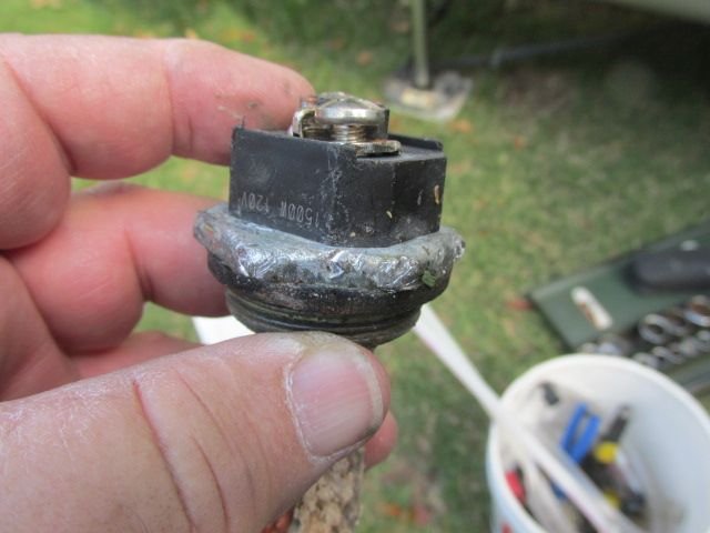

Post by JEBar » Mon Oct 17, 2022 6:38 pm
UPDATE :
the mobile RV Tech mentioned above returned today and completed the repairs on our camper .... it turned out to be a much more difficult job because the mobile Tech we use many years ago in Virginia really messed it up .... bottom line, he installed the wrong element (short corroded one in the picture below instead of the longer one shown ..... what ever that fellow used to install the short element really messed up the shape of the nut used to install it .... no socket would fit and he had to pull the water heater so he could get a pipe wrench in place to remove the old element ....

Too bad you probably can't get any restitution from the 1st tech. Seems like he wasn't at the top of his game at the time.

Post by dave77 » Mon Oct 17, 2022 11:05 pm
I had a similar problem getting a leaking pressure relief valve out on my friends 5th wheel. Lots of PB Blaster and finally broke it loose with a big pipe wrench. It sat in far enough that I had the wrench at a pretty good angle and pretty much destroyed the valve. The new one sticks out a little further and I can get a big open end wrench on it so it should be easier to get out if needed.

that work was done 5 or 6 years ago .... the water heater was once again able to work on electric .... hence, its taken this long to figure out the work was done poorly .... I'm somewhat relieved and pretty dang happy that the system is good to go for what could be as long as we will probably be able t use our camper
