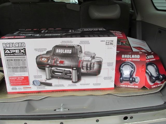

well ... its here .. :D
220208 001 She's Home 001.jpg (78.42 KiB) Viewed 1031 times
220208 002 She's Home 001.jpg (73.28 KiB) Viewed 1031 times
220208 003 Specs 001.jpg (73.21 KiB) Viewed 1031 times

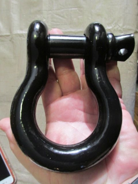

Post by JEBar » Wed Feb 09, 2022 10:08 am

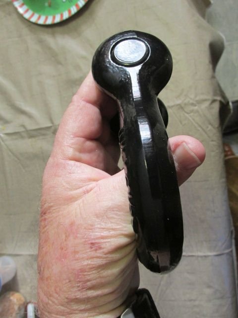

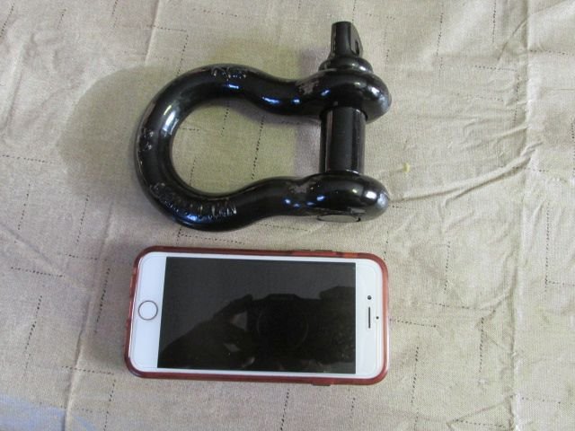

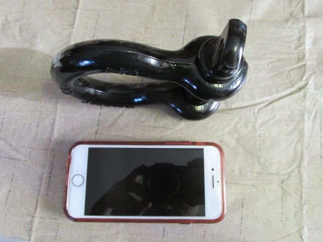

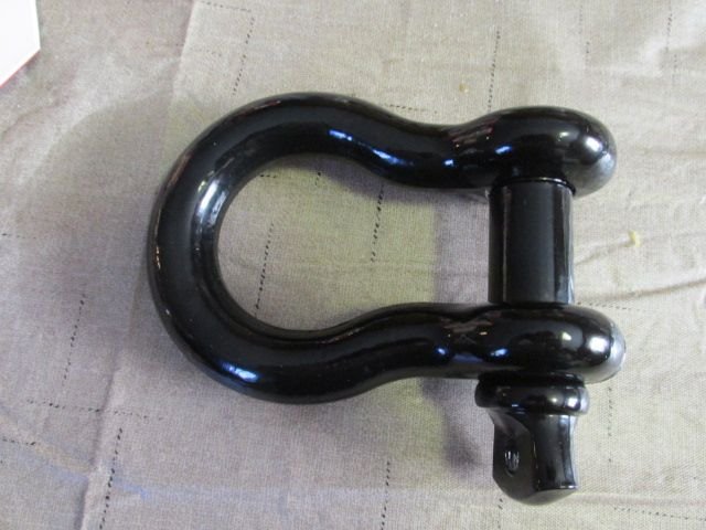

the accessories designed for use with a powerful winch like the Badlands Apex 12000 are the most impressive that I've ever seen .... as but one example : the 7/8 in. D-Ring Shackle shown below .... it weighs about 3.5 lbs .... it is 5 3/4" X 4 1/32'.... the locking bolt is 7/8" .... has a Maximum Working load of 13,000 lbs .... its is shown below in comparison to an I-phone and my hand .... there are untold numbers of videos which address the life threatening impact that can result from a winch cable snapping under load .... link to one such (long) video with graphic demonstrations, for folks who aren't interested in preparation details, skip to the 3:22 mark ===> https://www.youtube.com/watch?v=97XqNX3yFTk&t=190s ....
220209 001 D-Ring 001.jpg (69.21 KiB) Viewed 1025 times
220209 001 D-Ring 002.jpg (64.54 KiB) Viewed 1025 times
220209 001 D-Ring 003.jpg (73.68 KiB) Viewed 1025 times
220209 001 D-Ring 004.jpg (55.78 KiB) Viewed 1025 times
220209 001 D-Ring 005.jpg (58.51 KiB) Viewed 1025 times
220209 001 D-Ring 006.jpg (60.11 KiB) Viewed 1025 times
220209 002 D-Ring 002.jpg (68.36 KiB) Viewed 1025 times

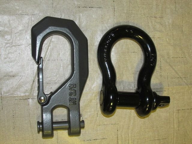

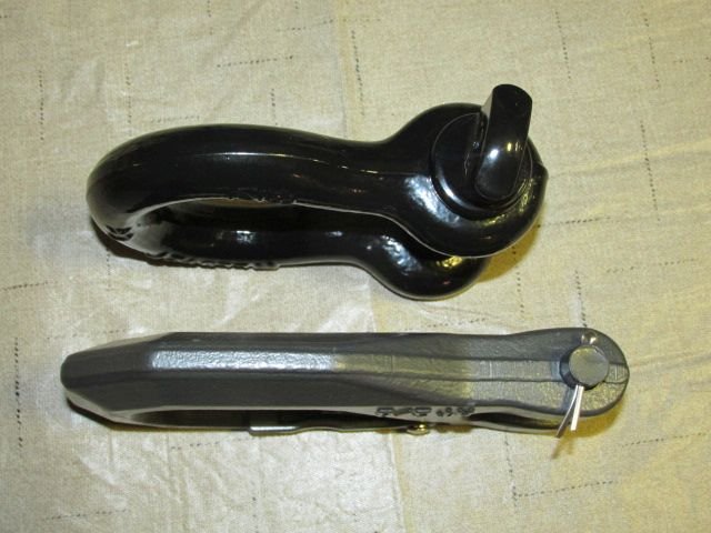

Post by JEBar » Wed Feb 09, 2022 6:52 pm

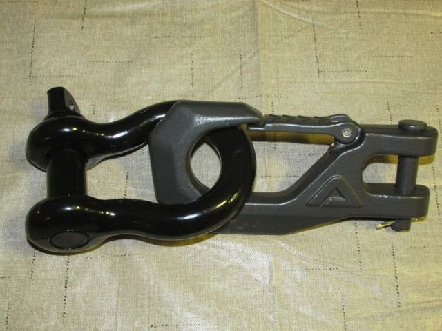

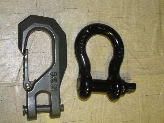

another heavy duty accessory for the Badland Winch .... its called a 12,000 lb. Forged Alloy Steel Winch Hook https://www.harborfreight.com/12000-lb- ... 6413.html .... its just over 7" long and weighs just under 3 lbs .... it is shown in the first 4 pictures below and with the D-Ring Shackle in the last 3 .... they work well together
220209 004 D-Ring and Winch Hook 001.jpg (80.91 KiB) Viewed 1018 times
220209 004 D-Ring and Winch Hook 001a.jpg (86.01 KiB) Viewed 1018 times
220209 004 D-Ring and Winch Hook 002.jpg (72.22 KiB) Viewed 1018 times
220209 004 D-Ring and Winch Hook 003a.jpg (79.01 KiB) Viewed 1018 times

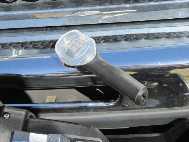

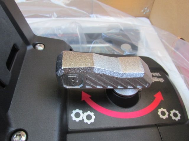

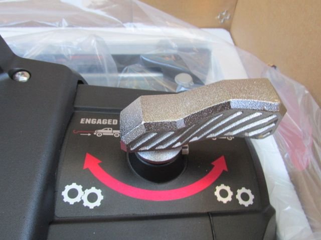

learned something today .... I was looking at the Badland winch and decided to turn the lever (shown below) that throws the winch in and out of gear .... one of the selling points of their Apex line of winches is very smooth lever operation ....I turned the lever throwing it in gear .... when I tried to turn it back, it was locked in place and could not be moved ..Image... reread the manual a few times and couldn't find anything .... got on their website and reread everything I could find, no help .... figured I must have gotten a bad one so I drove something over a half hour to take it back .... walked in, paperwork in hand, and found the manager .... she had it brought in from the Trailblazer .... I told her I wanted her to try turning it but she said it wasn't necessary .... I insisted, she tried and couldn't budge it .... she had a replacement brought to the checkout counter and redid all of the paperwork .... I told her that I wanted to try the lever on the replacement before leaving the store .... unpacked the winch to where I could reach the lever .... turned it and just like the one I had just returned, it locked in place ..Image .. the store manager was even more shocked than I was .... she said that in the just under 4 years she has worked for Harbor Freight, she has never had a Badland Winch of any type returned due to any problem whatsoever .... they pulled yet another out of stock and before doing anything else, tested the lever .... it locked just the same as the others .... at that point she called two fellows and told them to take the winch in the back and figure out what was going on .... it took them about 30 minutes to do so .... during that time they checked every bit of info they have and found nothing .... finally one of them cut the wire tie that was holding the cable tightly on its spool.... after cutting it, he pulled the cable out an inch or so and BINGO .... the lever released and operated as it should .... talk about relief ..Image.. .... lesson learned for them and for me
220210 001 lock-unlock 001.jpg (60.63 KiB) Viewed 1008 times
220210 001 lock-unlock 002.jpg (60.87 KiB) Viewed 1008 times

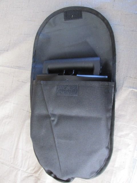

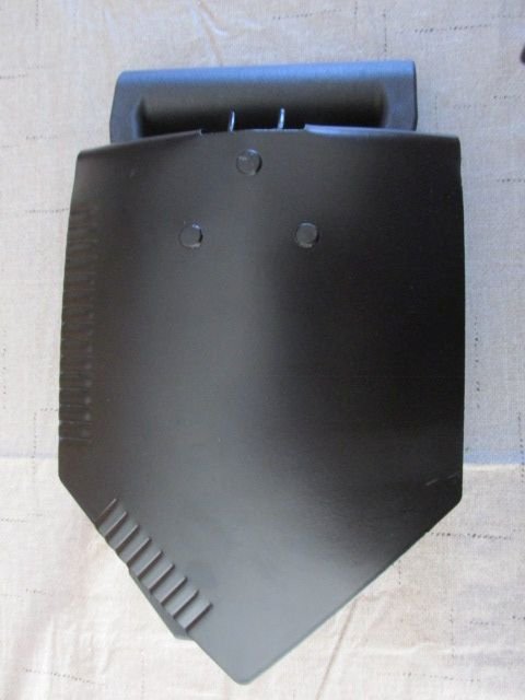

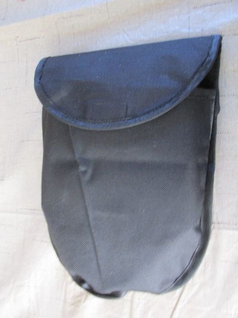

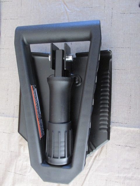

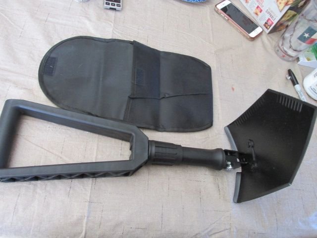

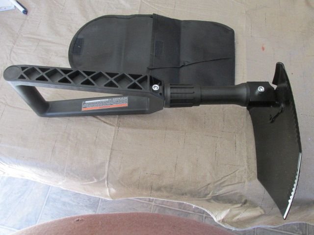

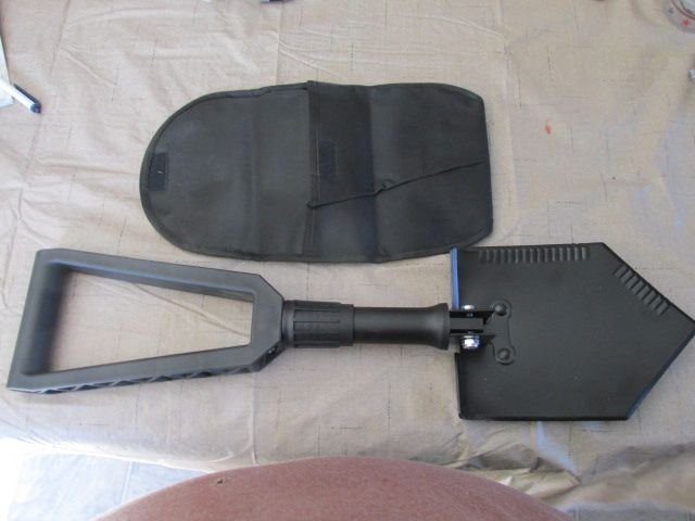

yesterday while wandering around Harbor Freight as they were trying to figure out what was going on with their Apex winches (see above post) I happened to see their Badland Foldable Utility Shovel ===> https://www.harborfreight.com/foldable- ... 57703.html .... they had it on sale for $11.99 and after handling one, I brought it home .... it has the feel of a heavy duty piece of equipment .... its one of those things that will be packed in our truck with the winch accessories that I sincerely hope will never be needed ... 8-)
220210 002 utility shovel 001.jpg (57.09 KiB) Viewed 998 times
220210 002 utility shovel 002.jpg (55.21 KiB) Viewed 998 times
220210 002 utility shovel 003.jpg (59.86 KiB) Viewed 998 times
220210 002 utility shovel 004a.jpg (60.9 KiB) Viewed 998 times
220210 002 utility shovel 005.jpg (52.16 KiB) Viewed 998 times
220210 002 utility shovel 006.jpg (68.42 KiB) Viewed 998 times
220210 002 utility shovel 007.jpg (68.12 KiB) Viewed 998 times
220210 002 utility shovel 008.jpg (59.51 KiB) Viewed 998 times

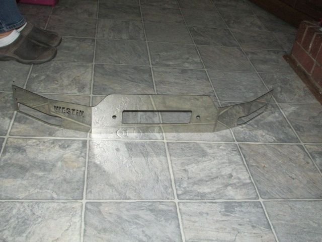

the first of the 5 parts of the Westin Winch Mounting Plate arrived today ... a Mounting plate with a the stainless Faceplate is shown in the the first picture below .... the second shows a picture of our stainless faceplate that arrived today
220211 001 Faceplate 001.jpg (69.52 KiB) Viewed 1021 times

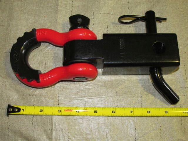

yesterday the Shackle Hitch Receiver ====> https://www.amazon.com/gp/product/B082X ... =UTF8&th=1 we ordered to use with our Badland winch .... I didn't know one existed until I started watching videos of winches being used to move vehicles .... talk about solid, it is an 8lb brute .... its designed to provide a solid connection point for vehicles with a 2" receiver .... as noted, I've used winches mounted on trucks for a long time and I continue to be somewhat surprised at how far winching accessories have come .... for the most part the concept remains pretty much the same but the technology has evolved in directions I'd never have considered
22023 001 receiver shackle 001.jpg (85.63 KiB) Viewed 985 times

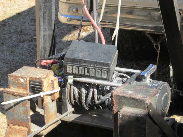

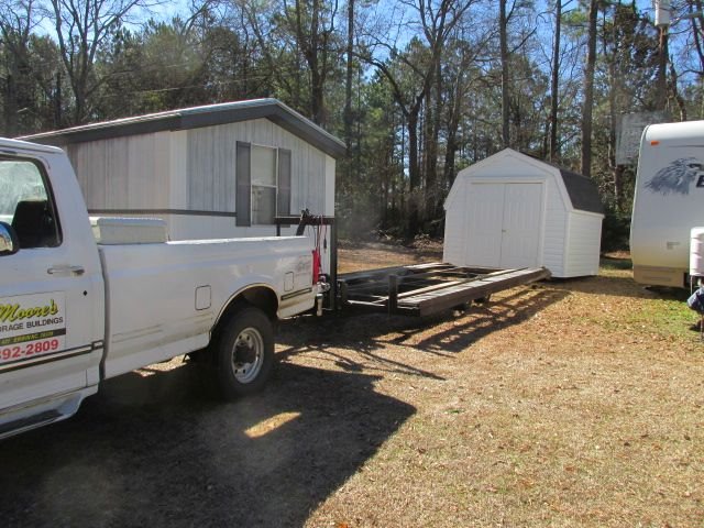

earlier today an out building was delivered to our daughter's place .... I couldn't help but notice that they had an older model Badland 12000 winch mounted on they trailer they use to haul their buildings .... the fellow told me his company has three of them that have been in almost daily heavy use for over 5 years .... he said they have never had to be repaired or serviced .... the largest outbuildings they sell are just over 20' long and the winches handle them with ease .... hearing this reinforced my research while looking for a winch that indicates Badland winches are well made and made to last
220228 001 delivered out building 001.jpg (88.35 KiB) Viewed 938 times
220228 001 delivered out building 003.jpg (101.44 KiB) Viewed 945 times
Oldbrass
Posts: 1018
Re: Yelm got a Harbor freight
Post by Oldbrass » Mon Feb 28, 2022 1:33 pm
Three winches in daily use for 5 years is most impressive, seems the take away here is to use them so they keep working, like many things electrical/mechanical the worse thing is to let them sit..

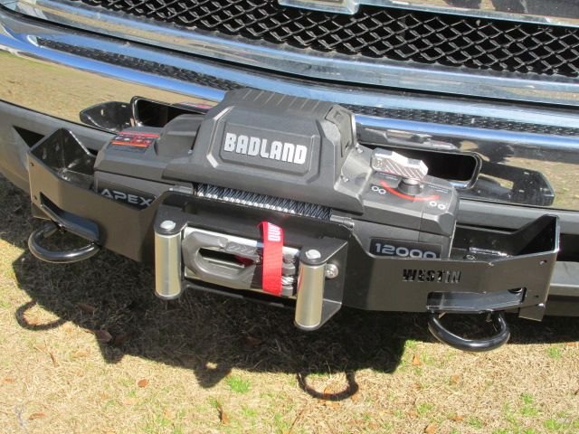

Post by JEBar » Wed Mar 02, 2022 2:37 pm

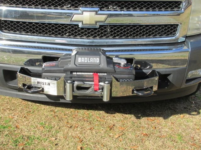

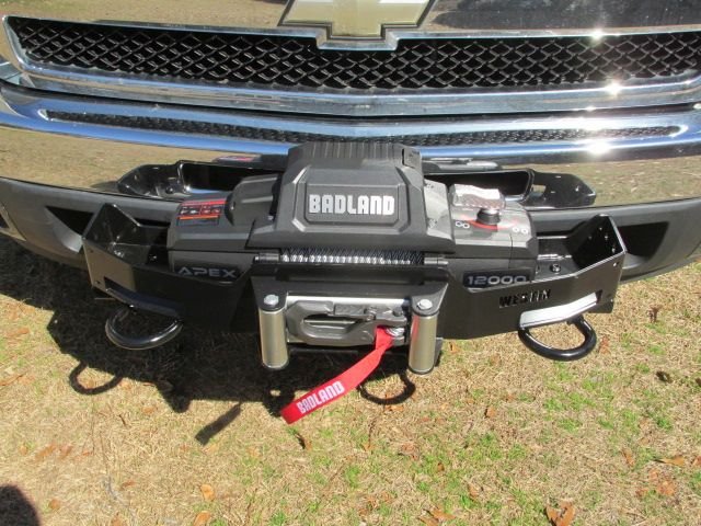

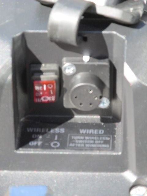

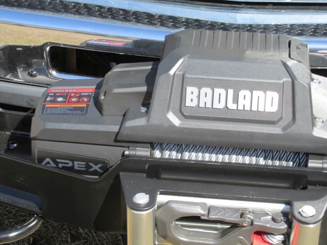

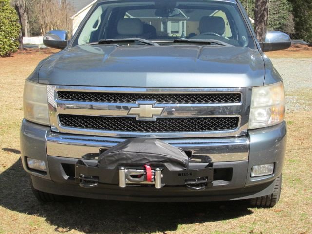

well, she's installed and fully functional but the install isn't complete .... the stainless trim panel that goes completely across the front of the Westin Mount bumper didn't fit .... it as been returned and a replacement should be here Friday .... it requires removing the front rollers (2 bolts), reinstalling it over the trim plate and installing 4 more bolts .... will add pictures after it is installed .... I'm impressed by the the Westin' mounting plate which is very heavy duty .... its powder coated finish is very nice the wireless remote shown below has a magnet that allows you to attach it to help free up a hand .... all switches and what they control have been tested and all work as they should .... so far, so good
220228 001 Pre Mount 001.jpg (95.92 KiB) Viewed 929 times

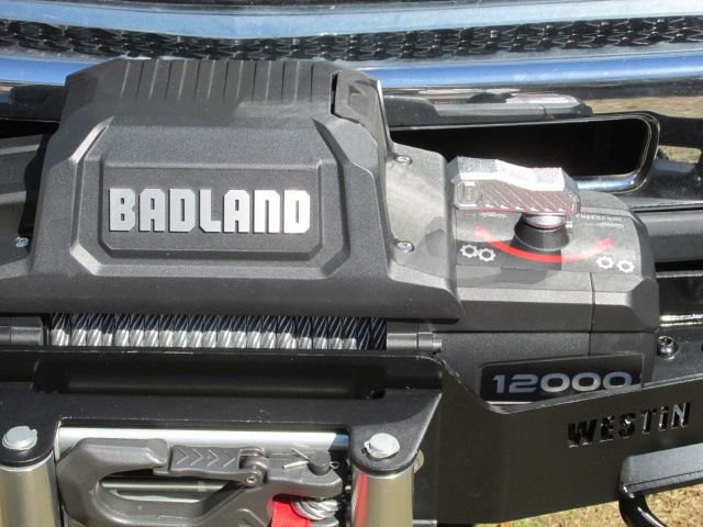

220301 001 mounted with cover 001.jpg (90.58 KiB) Viewed 929 times
220301 003 close up 001.jpg (101.93 KiB) Viewed 929 times
220301 004 close up 001.jpg (75.83 KiB) Viewed 929 times
220301 004 close up 002.jpg (79.92 KiB) Viewed 929 times

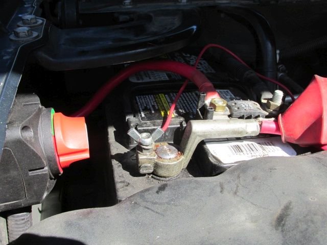

220301 005 shutoff and positive connection 001.jpg (69.85 KiB) Viewed 929 times
220301 006 remote 001.jpg (75.95 KiB) Viewed 929 times
220301 007 remote and wired remote connection 001.jpg (50.67 KiB) Viewed 929 times

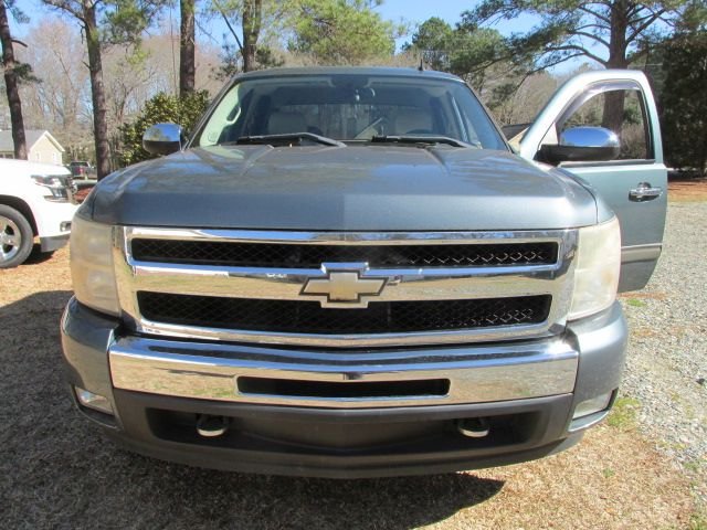

the Westin Faceplate ordered for our Badland winch install has arrived and been mounted .... pictures below show the pre and post install .... the third picture shows the chrome Westin Bull bar that is still on backorder .... once it arrives LED lights will be ordered to be mounted on it
