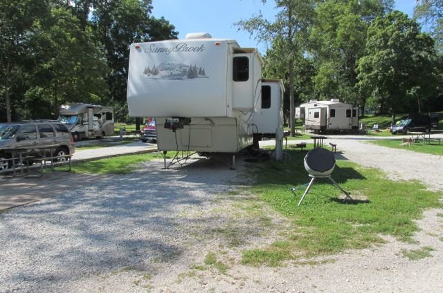

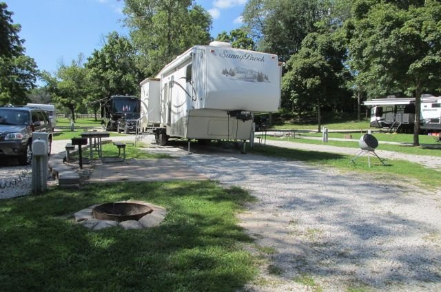

today we are parked in the West St Louis KOA .... after getting setup we turned on our roof mounted Carryout G2 .... it can only lock onto Dish's Western Arc satellites and trees blocked the signal ..... as cab be seen below, we then connected our new Pathway and set it to search for Dish's Eastern Arc satellites .... it quickly locked onto strong signals from all 3 of them .... sites like our current one are the reason we purchased the Pathway and we are happy with the way it is working

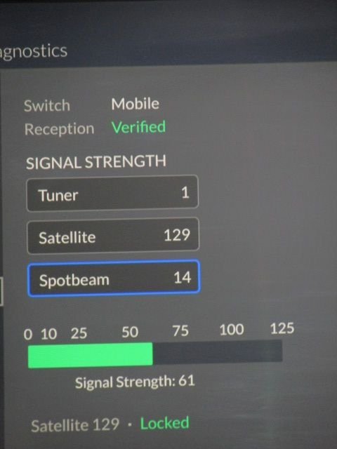

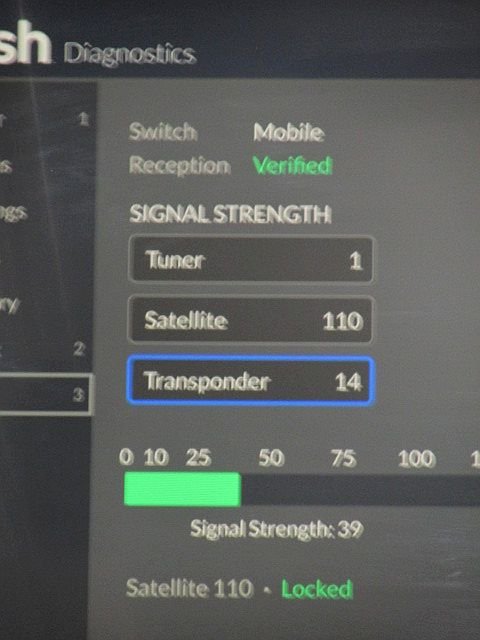

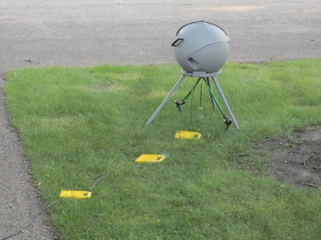

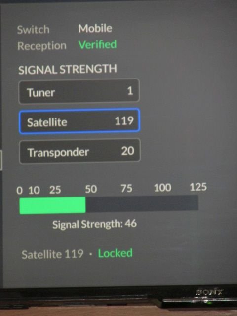

we are once again setup on the same site in Estelline and our Pathway X2 has been in use for a month .... sadly, it hasn't gone smoothly .... lets just say that getting through to a Dish Rep who knows enough to not have to read from a script ain't easy .... for the first three weeks, all was good .... for the last week its been 180 degrees the other way .... as noted earlier in this thread, we were told to keep the coax to 25' or less .... we use the yellow levelers to keep down folks tripping over the Coax .... kids visiting our site like to hop on them and we've learned the hard way the raised lip damage the Coax .... bottom line, calling Dish resulted in making adjustments that didn't need to be made and actually made things worse .... yesterday I had reached the point of searching for different satellite dish .... if I hadn't of spoken with a lady from Minnesota during my last call to Dish, I'd probably had a replacement on order .... that lady helped me to understand the cause of the problem ... I've also learned that they Winegard offers power booster which fits the Pathway and makes it much easier/faster to get locked on .... one of those boosters is on order .... the last three pictures show that all three Dish Western Arc satellites are locked in and we have strong signals
