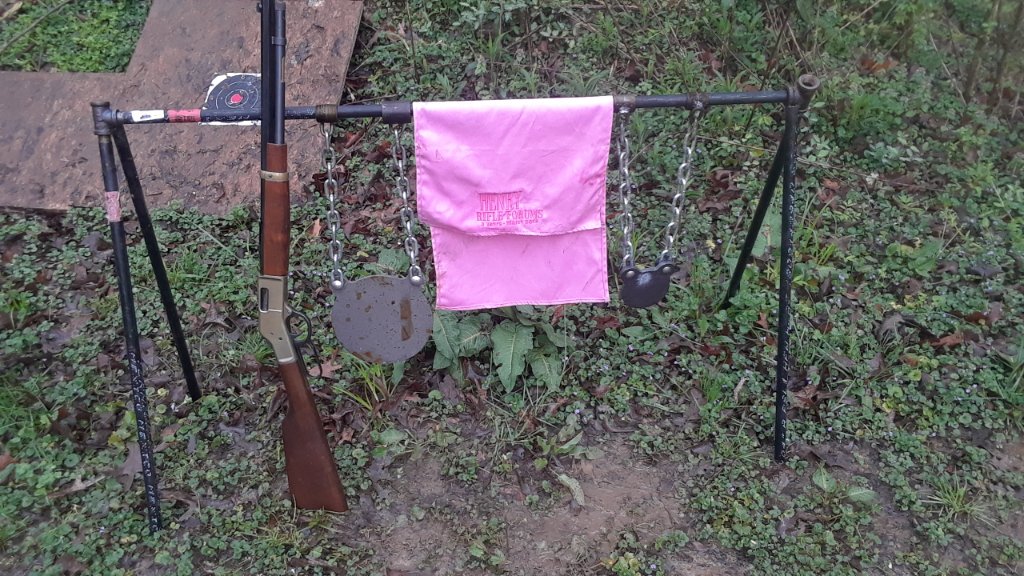

Post by Vaquero » Sun Apr 07, 2019 9:00 am
The idea I borrowed from a friend, half in h gas pipe, a couple tees and some 1 inch nipples.

Nice and an easy setup! What distance to you shoot those targets from?

fortyshooter wrote:Nice and an easy setup! What distance to you shoot those targets from?
Generally 40-100 yards, but now I will be able to easily move them out farther.
I have places on the farm I hunt to easily get 300-400 yds.

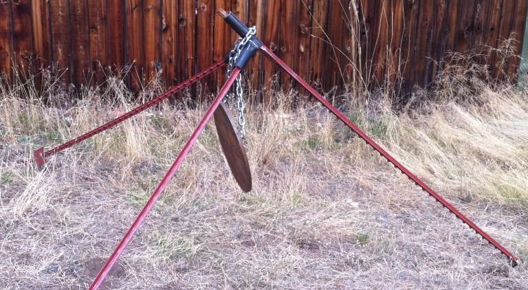

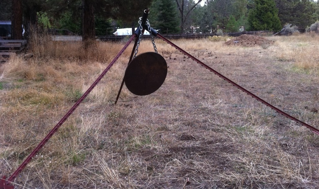

If I may, another portable target stand, farm and ranch related:
3 T-posts with at least 1 with the flat plate. The ~2" 4-way can be PVC, available from Amazon for about $6. Use the T-post with the flat plate as the rear post with the flat plate end on top. The flat plate keeps the 4-way from sliding down the T-post. Attach the chain to the target plate 1/3 down from the top so the plate cants/tilts toward the ground.

Wingnut, the down angle is a great idea to semi-control where the bullets go after impact.
Got an update on the distance.
Not sure if it was that the large target was off to mostly one side, but
at roughly 45 yds. just guessing, shootin from the back porch yesterday morn.
i rung it a few times with the 41, no problem but when I grabbed the ole Marlin 30-30.
Well that overturned the apple cart/shootin stand. :lol:

Posts: 12151
Re: Portable shooting stand
Post by Vaquero » Tue Apr 09, 2019 8:04 am
Redthies wrote:Wingnut, the down angle is a great idea to semi-control where the bullets go after impact.
Red kinda hard to tell by the pics., but those targets have a slight angle also.
And the bullets that were hitting the targets were impacting the ground right under the targets.
