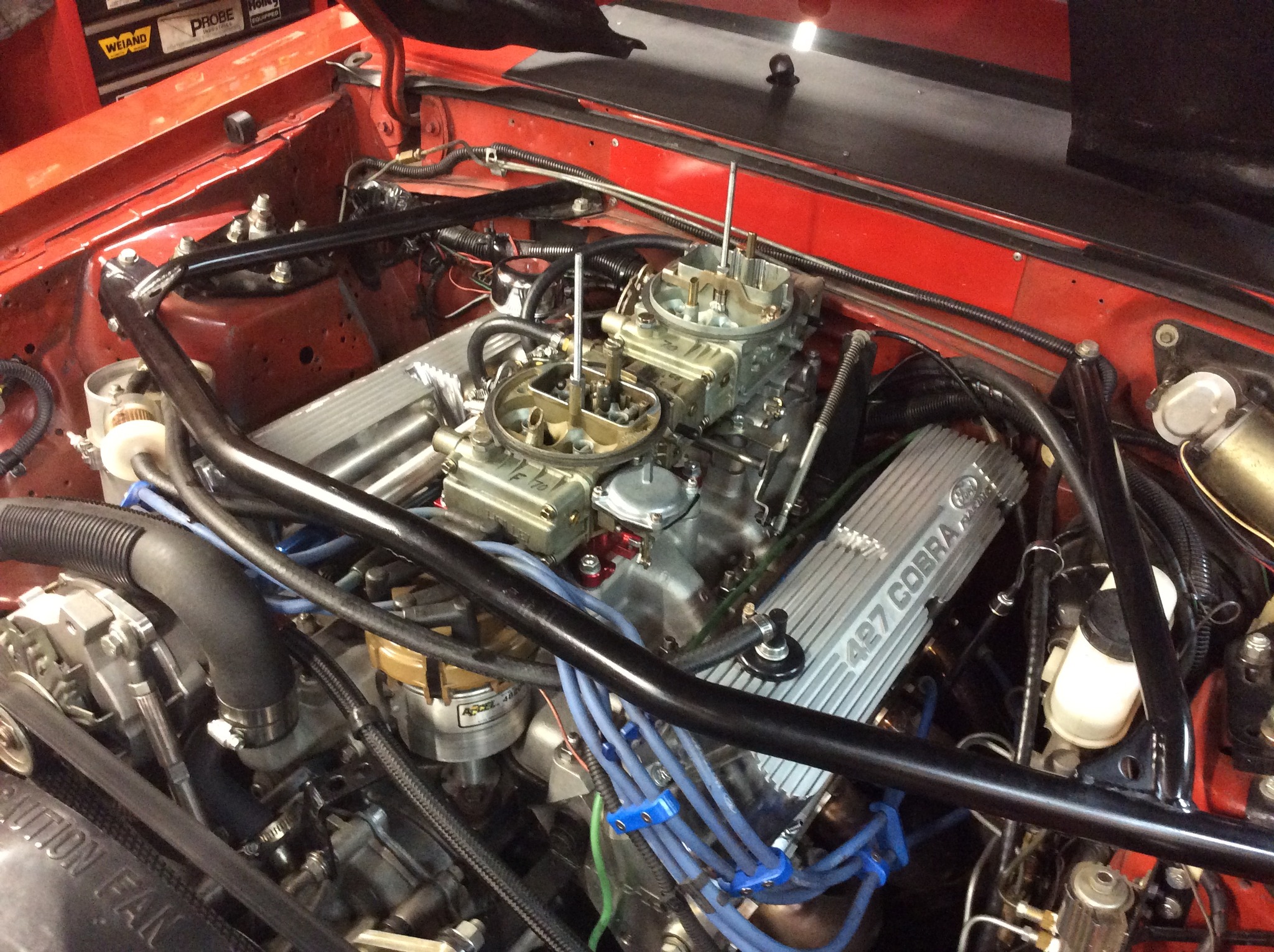

Best way to build a Ford Windsor type stroker is to start with 427 cubes based off the aftermarket Dart block. Comes with the 4.125 bore and you add a Scat or better 4.00 stroke crank. With the large splayed 4 bolt main caps no worry of anything moving around on the bottom end.
Add a good set of heads....aftermarket of course and a correct looking for a Ford 427 intake manifold and perfect for a Cobra or poor man's Cobra a relatively light 80's Mustang LX with chassis stiffening of course. The bore/stroke is the same within a few thousandths as the Ford FE 428/ 428 Cobra Jet.
new look with the 427 Ford Cobra valve covers.jpg (873.25 KiB) Viewed 410 times
