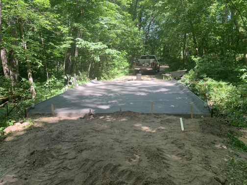

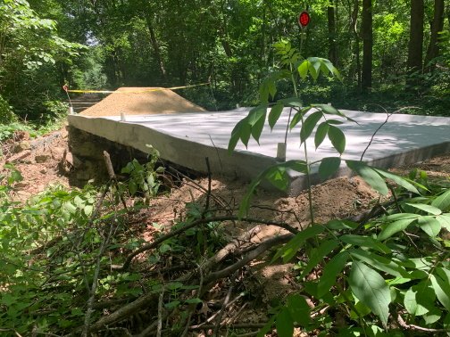

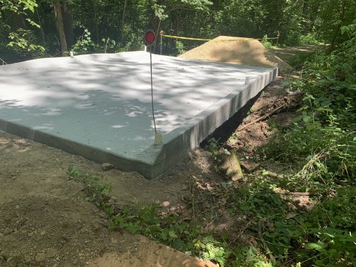

We got it poured yesterday and now it needs four days to cure prior to driving on it.
It replace an old wooden bridge made out of creosoted timbers that had been in place for almost
forty years. The gas delivery kid, (a new driver), refused to cross it so we decided to get it replaced
now. We had been contemplating it for a while anyway.
What we did was lay treated plywood right over the old bridge, after removing the treads, and poured
concrete right over it.
It's about twenty ft wide and twenty five foot long and is heavily reinforced with rerod.
The creek is dry at the present time.

Well, the cement cured for four days as the contractor recommended and this morning I opened
the driveway and brought the vehicles home. All is good.

Wow! Really?
Four days is what the contractor recommended as it was a special quick setting concrete.
The old footings are still solid and the bridge overlaps each of them by four feet.
I didn't have a rail on the old bridge but plan one on this one. We embedded plastic pipe in the concrete
to set them in.
I've had reflectors on the bridge since 35 years ago.
It cost around $7000.00 complete.
