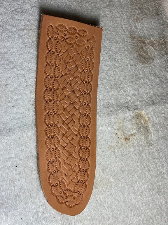

Miss T picked me up a book at Hobby Lobby with some cool techniques in it for using non-border tools for borders on the leather. Plus, I have the new Cowboy 3200 sewing machine in the shop that I hadn't gotten a chance to use yet, so since it had rained for two days, I thought I'd go out in the shop, since I couldn't work on the berm wall.
I re-read the pages on the creative borders, and gave that a shot, and it turned out okay. I didn't get the spacing exactly right and the curve at the bottom of the "sheath" blank wasn't perfect, but it was a practice piece. I wasn't actually going to make a real sheath, right? ;)
(My usual rule is to ALWAYS work as if the piece will be fully finished, but it was raining and arthur was working on me.)
Okay, I had the border done and had the blank center... Basketweave practice. THAT went well.
220602 sheath.jpg (140.73 KiB) Viewed 807 times

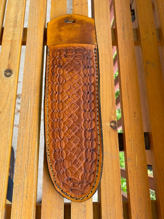

So, went back out and applied the various finishes. I dyed the back and edges black, then burnished the edges. The front panel was dyed golden, then antiqued. The entire sheath was treated with Mink Oil to keep it supple. Dye will make the sheath stiffen up.
It's done.jpg (138.19 KiB) Viewed 807 times

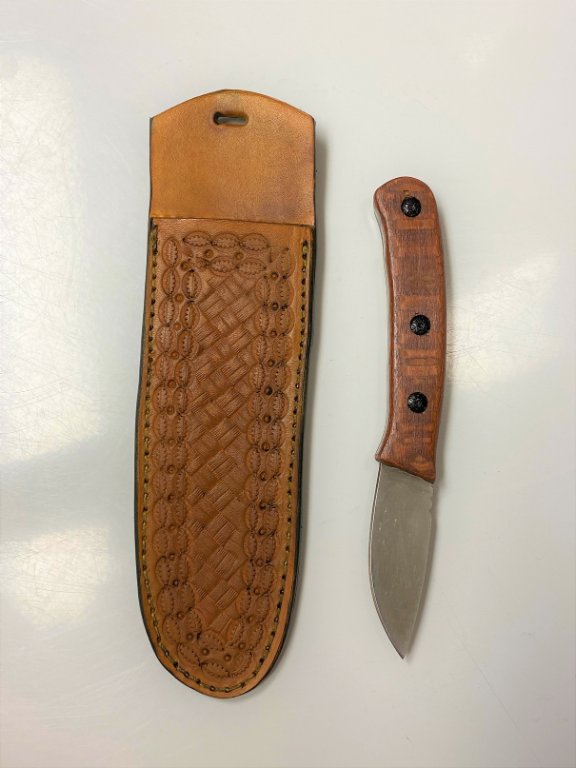

Here is the sheath after the colors evened up a few hours later, pictured with the knife I made Miss T a few years ago. Curly Cherry Scales.
sheath and Curly Cherry Knife.jpg (72.5 KiB) Viewed 803 times
