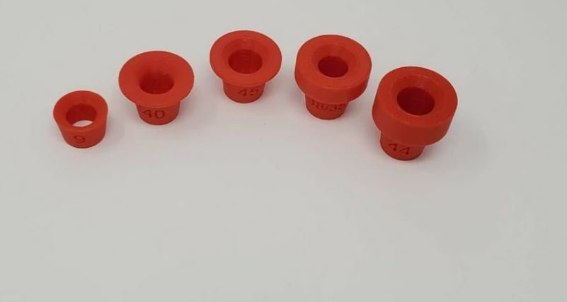

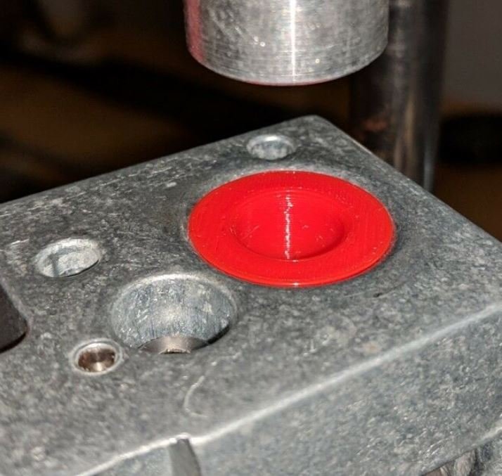

My Hornady has an auto case feeder that has continually been problematic, especially with .38/.357 and 9mm cases. It will feed six or so just fine, the all of a sudden it starts feeding two or three cases stacked on top of each other, or jams.
I have tried every trick, tweak, tune up that I could find on the internet and YouTube. Some improvement but still getting double feeds.
On YouTube, I ran across 3d Design who makes caliber specific bushings for the Hornady case feeder. I was skeptical as a set cost only $11.00.
I thought "Nothing to lose" and jumped in. Customer service (Daniel the owner) was first class, shipping was quick. The set includes 40, 45, 38/357, 9mm, 380 bushings.
As soon as I got them, I threw in the .38 bushing and ran 200 cases through the feeder without a single double feed or mishap. PROBLEM SOLVED.
So, if you have a Hornady case feeder, you may want to check them out:
