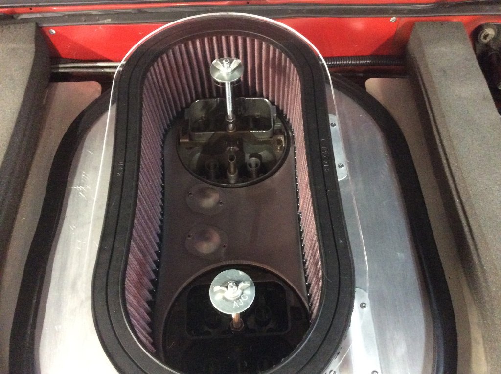

Yep the hot and humid all this week with "feel like" temps around 100 so not much range time this week. But another project that needs to be done...
like making up 2 air cleaner wing nuts similar to an OEM unit. Before I was using a common wing nut and washer but wanted a one piece unit.
Ha....try finding the basic automotive carb wing nut nowdays around town!!!
So it started with a piece of steel in the lathe and then on into the mill. Got to have a pair of them....dual 4 bbls. you know!

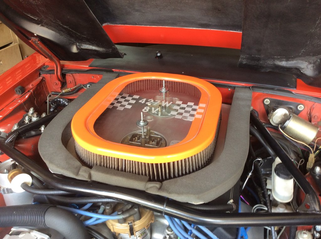

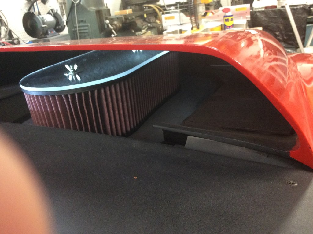

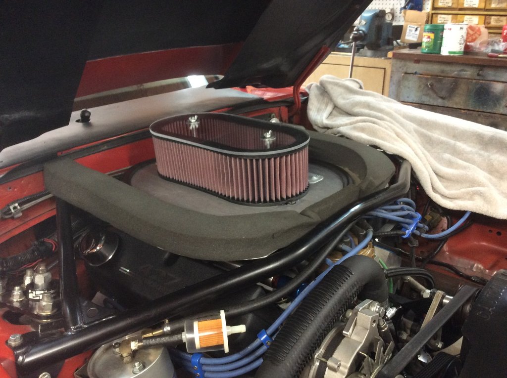

Those air cleaner nuts for a new filter setup I'm working on. The other deal was a larger but shorter oval air filter and the new one is 4 inch tall and not as wide. Still has 10 sq. inch more filter area and the added height smooths out the airflow into the carbs. Last pic is the filter setup from before.

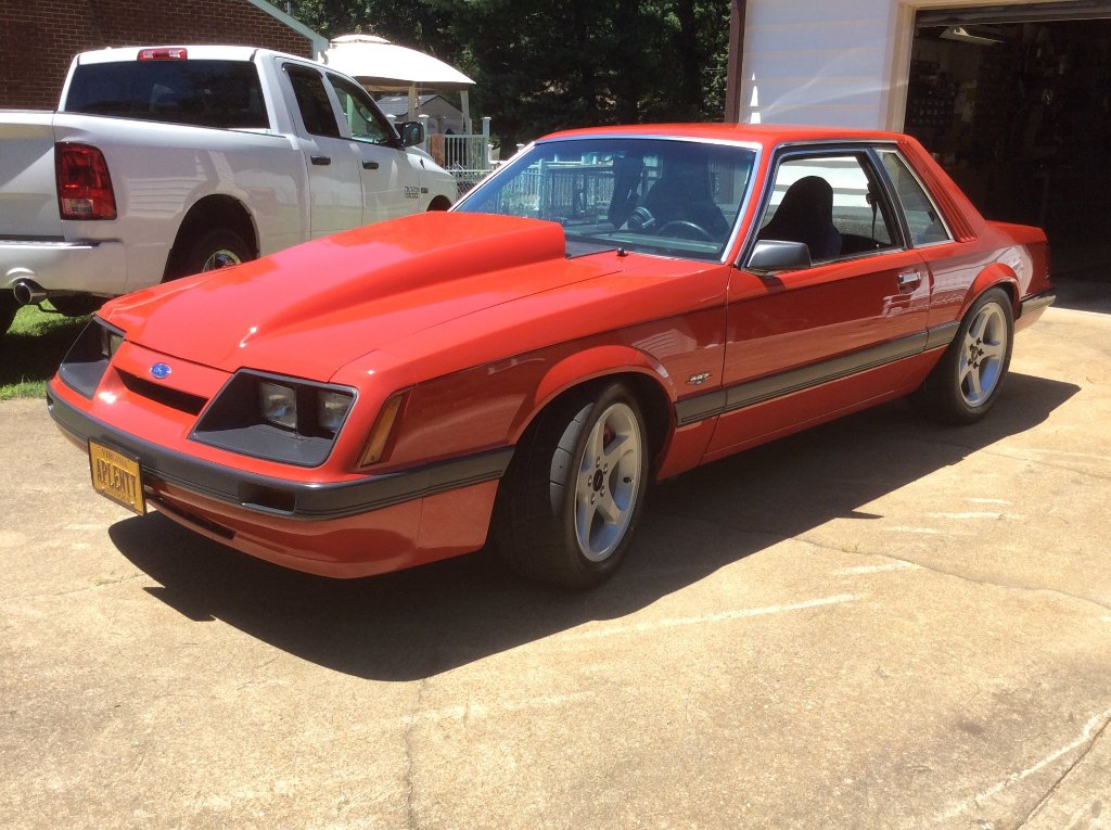

The car is my 1985 Mustang LX which I have been wrenching on for 36 yrs. Built the 427 Windsor for it 11 years ago.
Yeah I make a few guns parts for myself if I can.

Yep a fun little ride!

Oh yeah... The main mission of it was to grudge race my buddy's 1970 Hemi Challenger...a clone he built up with a 511 Hemi.
I did run a 10.90 @ 131 just foolin around with it. Very soft launch with the 3.50 rear gear with the TKO-5 speed. This about 8 yrs. ago before I added the dual 660's. He later sold his Challenger. We would run right close to the same with him running at 4000 lbs. and me at 2960. His Hemi right around 650-675 HP and me 550-570 HP.
