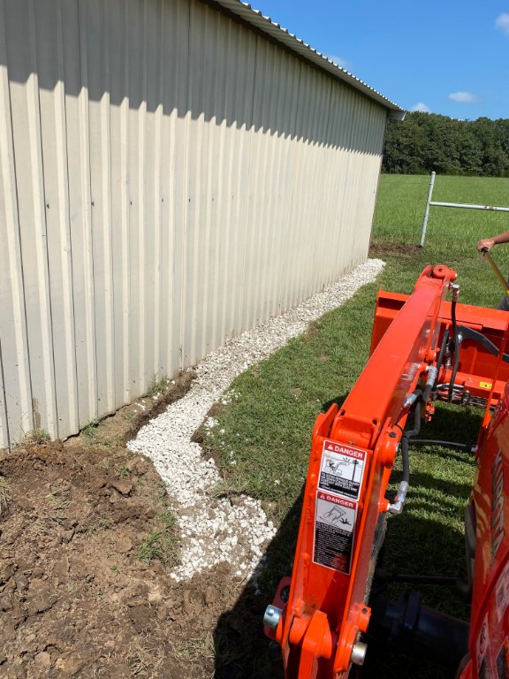

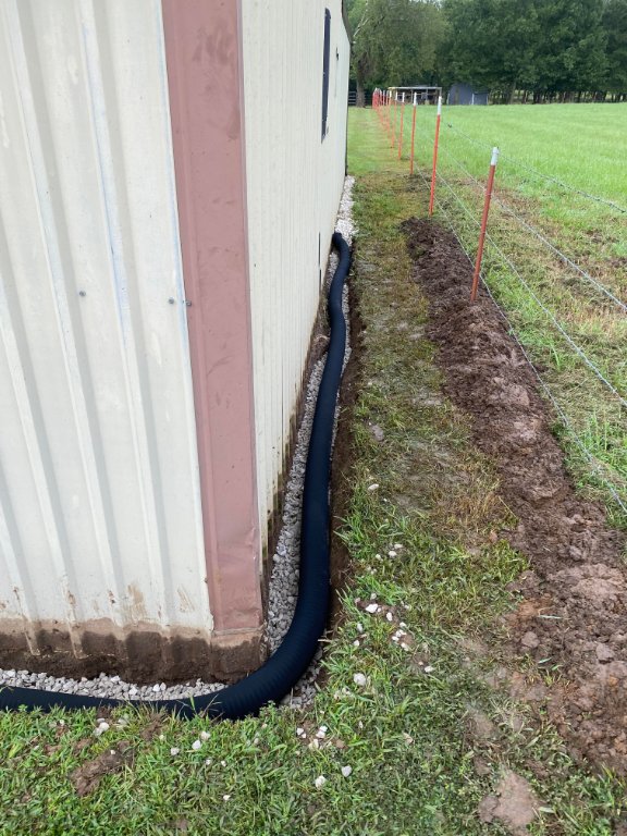

Don't know if I posted the French Drain here from the flood last September.

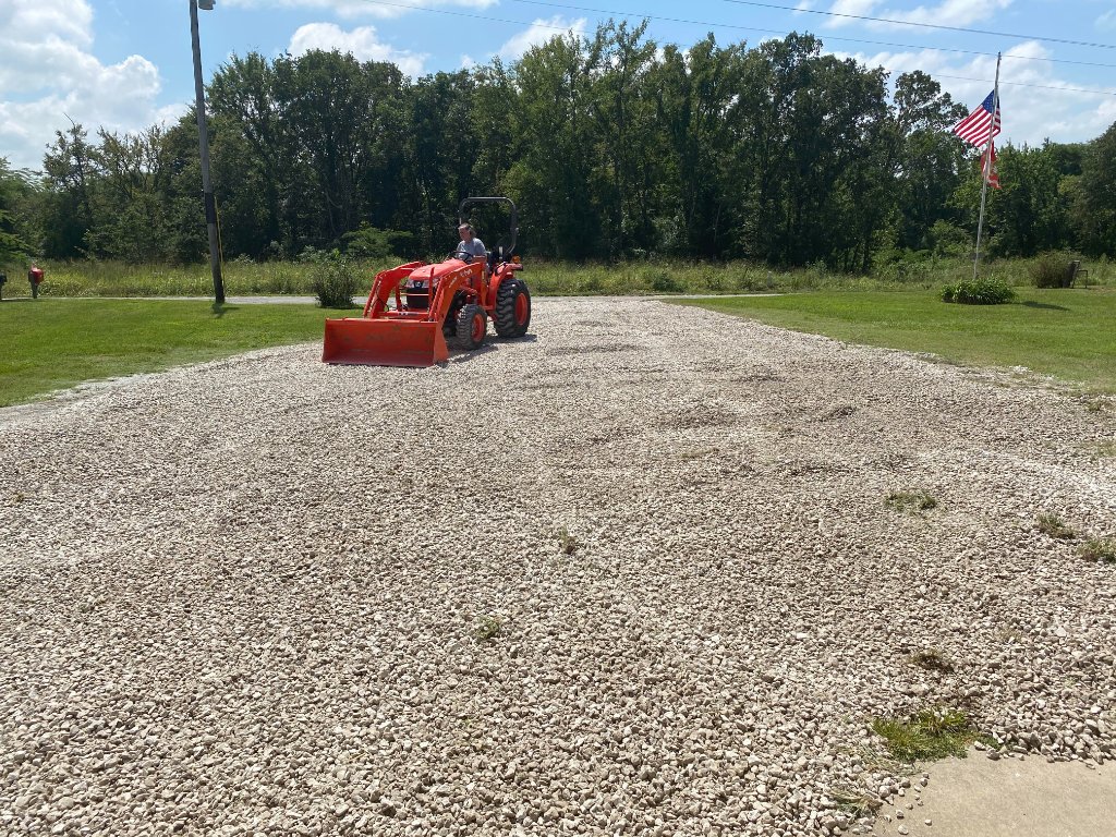

We dug a long trench across the back and down one side and put 100 feet of that pipe in, covered in and resting on gravel to carry the water away. 13 tons were delivered. Some was used on the drain, the rest was spread on the drive. That drain worked very well thru winter snows and hard rains until this Flood, unlike any they have seen since the 90s.

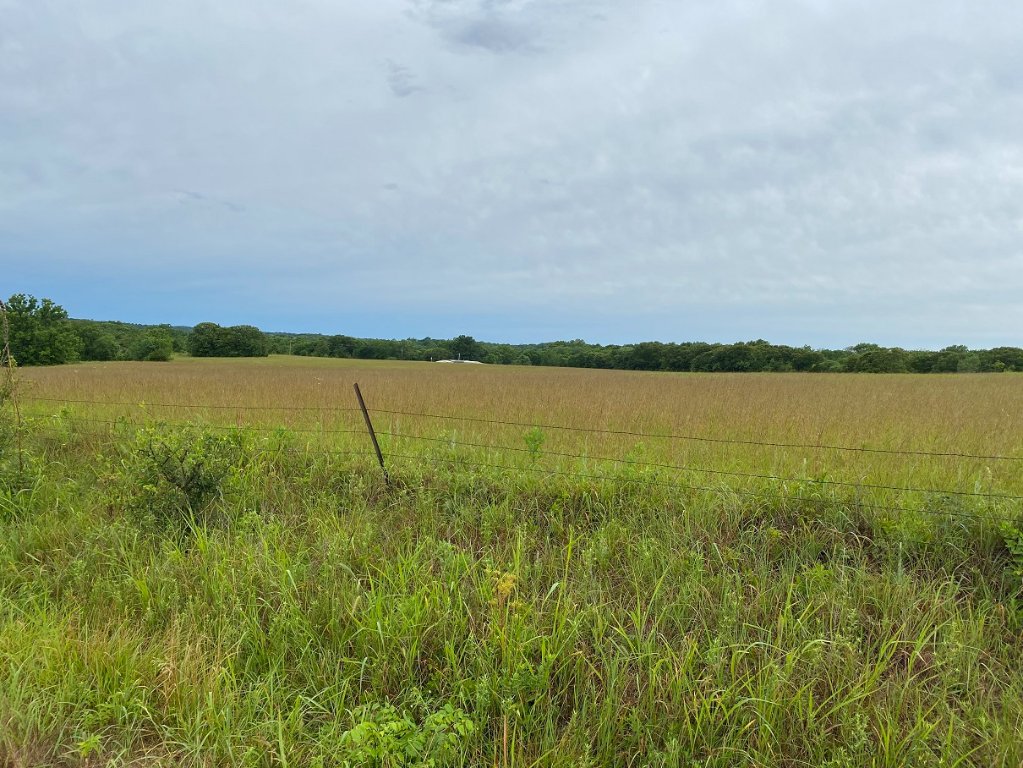

I have talked several times with the original owner of the house, the one who built it in the 80s. HE had a deep ditch dug along side the property line corner, about three feet wide and two feet deep he maintained with the tractor. The workshop nor the fence was here. HE put the ditch in to protect the house. :)
In the picture below, you are looking across a portion of the 60 acre hay field, and you can see the roof of the house and the woodshop just peeking over the hay. That 60 acres drains down toward the house. :roll: Not surprising that we have some drainage issues when we get heavy rains.

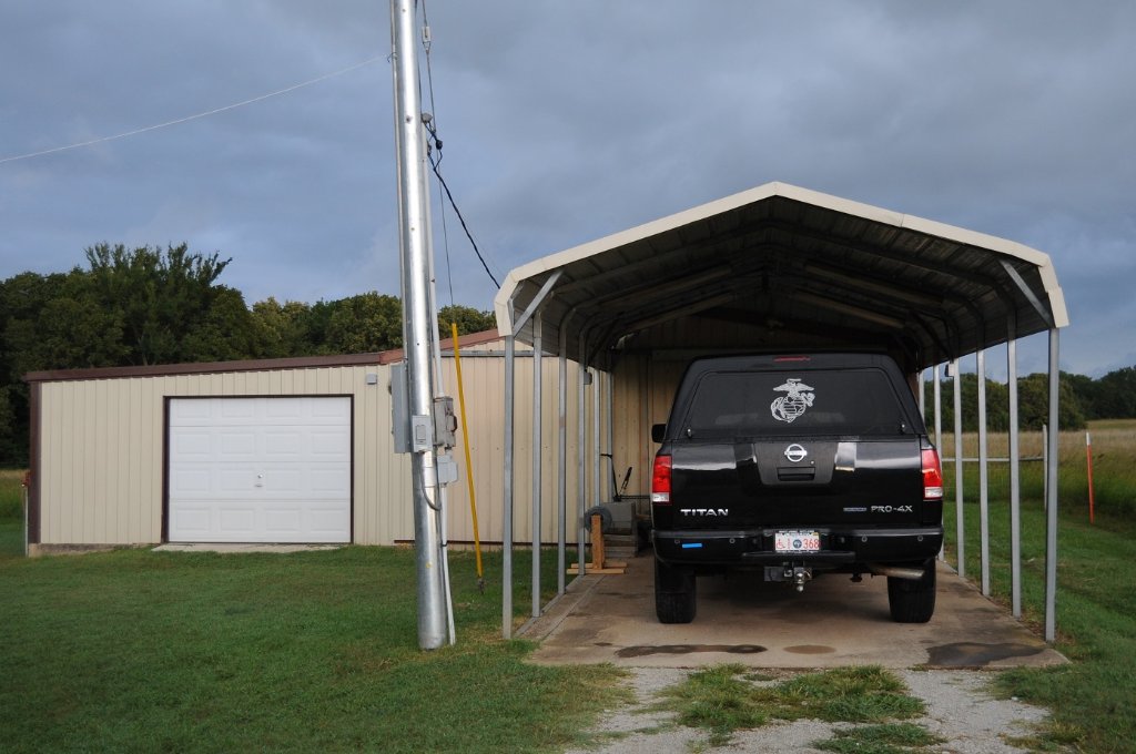

In this pic of the front of the woodshop, you can see the hay field directly behind and above the shop.
front of woodshop.jpg (145.47 KiB) Viewed 661 times
If we decided to build up a slope of dirt behind the woodshop to keep the water from flowing in, you see the problem. They put the shop right on the property line. I'm sure the owner of the hay field would allow us to access the field after he cut the hay in July, as long as it hadn't rained, but we would have to take down, then reinstall the fence after we finished. (It's our fence.) Build up a sloped bank of dirt a foot or so high against the back wall to force water to flow away from the building to either side. Might work.
