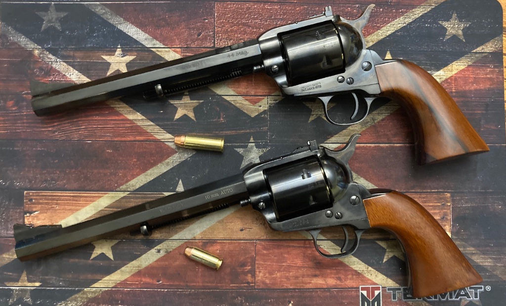

Well, I got em. They are identical too. Finish is excellent. Fitment is excellent. Timing is sweet. Cylinder stop pops up right before the cylinder notch, so no cylinder rings. I love that! Action is smooth as a baby’s bottom.
The only thing I see wrong is one small smudge in the bluing where maybe it wasn’t sanded perfectly before it was blued. Not bad just a small dull spot. Grips could be fit a little better but they aren’t bad. I’ve had worse from Ruger.
Out of the box, the sights aren’t bad. I was shooting 60 yards into the dirt just to get a feel for ole girl and they were impacting where I was aiming. Target sights for fine tuning.
When I checked the timing, I usually use a intense light between the cylinder and frame. No light was coming through on the 44. I had to shine it down the barrel.
The 10mm I could see the light but the cylinder had no noticeable play front to back. It was a difference in cut in the rear of the cylinder that allowed the light to pass through.
I fired 3rds of each and my oldest fired the last two from each. 180gr S&B 10mm that were pushing 600ft lbs from this gun were nice to shoot. With my usual loose grip, my knuckle did contact the trigger guard but it wasn’t a bang on it, just a light touch.
240gr 44 magnum HP hand loads were heavier in recoil but not unpleasant, pushing 800ft lbs from this gun. No knuckle busting! I don’t shoot 44 with a loose grip though. My grip is a bit firmer and more positively engaged, but I ain’t choking it to death. Those 1860 Army grip frames have my vote. It was comfortable one hand shooting.
I’d highly recommend these based on what I experienced in the first shots, that is, if a Frankenstein single action is on your list.

Agreed. I have this same conversation from time to time with folks. I don’t really consider the 10mm to be a magnum cartridge. More an intermediate cartridge. If you compare it with other 40 cal magnums, it’s pretty far behind the curve. Not to say it isn’t a powerful cartridge, there is just a big difference between a 180gr @ 750ft lbs and a 240 @1500ft lbs. The cartridge I tested was loaded for my 44 mag Henry, which is pushing incredible speeds from that gun. Had I loaded them for handguns, the gap would have been huge. The last average factory load I tested was from a Redhawk 7.5” 44, pushin 971ft lbs, still pretty mild. Even the 41 magnum can push a 210gr to around 1100ft lbs.
