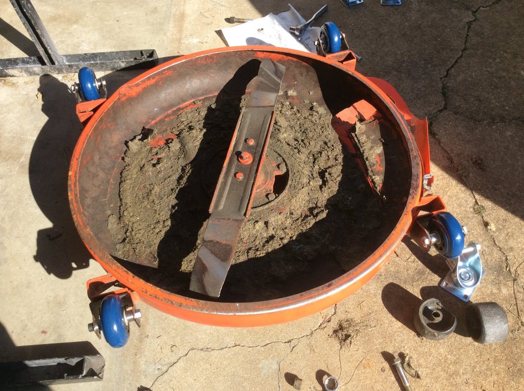

Bought a old but great running 10 HP 28 inch cut Airens rider from a neighbor back in the Fall for 100 bucks.
Engine runs great and a new carb and battery had been put on by dealer. I bought it to keep down at my range for towing around small utility trailer
and to cut grass.
Now the mower deck needed a new belt plus replacement roller wheels. After looking around at several places for same size wheels nobody had any that would work. Checked online and found the O.E. wheels for 18-20 bucks per wheel!!! These are just a plastic wheel with no bearing.
Not to spend 80 bucks I went over the Harbor Freight and found 4 casters with tough urethane wheels with bearings for less than 5 bucks per with discount! All I had to do was crank up the lathe and make up stepped spacers which locate in 1/2 inch hole in deck bracket for a 3/8ths bolt and also
take up the space for narrower wheel. Will see how they last and if needed replacements easy to get for a set less than 20 bucks!!
Note the old black wheel with the worn flat!! Would think he would have noticed something not rolling!

Replacing mower deck wheels....
- replacing mower deck wheels.jpg (216.9 KiB) Viewed 2784 times
