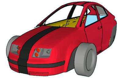

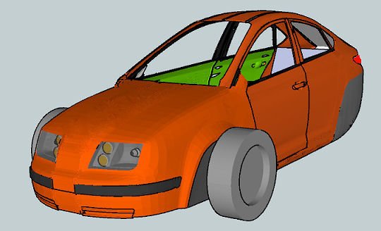

Per Mark BEX ....
Over the next week or 2, I am going to try a narrowed VW Bora/Jetta nose for size.
This doesn't mean that's what I am using, it's just that I have a Bora going to waste in the factory, so I can try it out, and get practice in for narrowing a nose, rather than buying new panels and doing it wrong.
The Bora is actually one of my favorite car noses, and the nose panels are highly sort after by VW Mk4 Golf owners as they bolt straight on. They then call them "Bolfs" by the way, Google it if you don't believe me
Added red one with racing stripes for the rev-heads ...

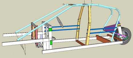

Post by JEBar » Fri May 20, 2022 7:06 am
So most of the week I have been measuring and inputting into a new chassis for the Honda engine.
Most of the 3/4s of the rear is the same, although different, and the front 1/4 is completely revamped to make a simpler to produce, but stronger frame.
The biggest thing those interested might notice is the roll cage going all the way forward to meet and triangulate the front main rails.
Just about ready to start making it, and it won't take very long, and I will be using all the rear parts from the current frame.

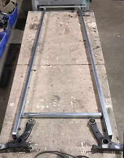

Made a start to laying new steel.
Will build a whole new frame as I want to keep the other car intact and drivable, don't worry, won't take long as I have the complete design, just making some dimensional changes as I go, some improvements I had considered, and now have the chance to implement them.
Should make them to be faster to build.

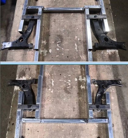

when asked about the size and comfort level to be offered in the rear seat area, Mark responded :
the last thing I want is for the Boss to be a sardine.
Comfort is a must, lots of cubby holes for the Bosses' handbag and never ending knicknacks, plenty of leg room, ability to snooze on long trips, etc, but most important, I believe, is their own door, for elegant ingress and egress.
As mentioned, I am knocking together a new frame, I want to keep the other car intact and drivable, and already going smoothly.
Will be fast because it's only a modified version of the other car, mostly copying everything over, and not much in the way of any scratch designing, or finding headaches along the way .

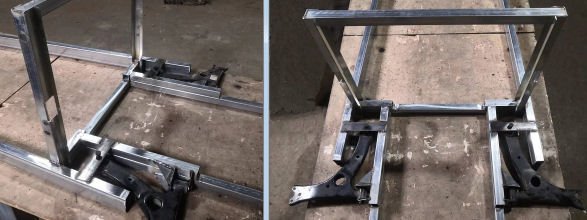

About the biggest change is I am eliminating the OEM crossmember because I don't need it for the steering rack mounts or anti-roll bar, so it's just a lot of weight and wasted money. The lower control arms will hang directly off the frame instead.
220524 001 new frame 002.jpg (48.94 KiB) Viewed 1127 times

Finally the A pillars were laser cut today after a few issues with some re-arrangement of staff at the laser shop, got them folded as well, and the lower control arm front brackets also cut, so the lower control arms are now mounted.
220527 001 new frame 001.jpg (32.24 KiB) Viewed 1106 times

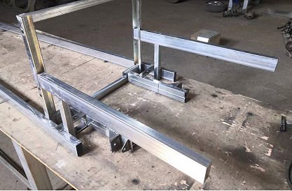

Post by JEBar » Sat May 28, 2022 11:23 am
The main engine rails are in and lined up.
Going together well.
