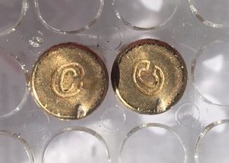

2 Misfires were with CCI Mini Mag 40gr CPRN and occurred during the rapid fire serials. I lost one round when it was ejected. The other looked like a good strike from the firing pin and fired when tried again. The other 3 Misfires were with CCI AR Tactical 40gr CPRN and might have been light strikes. Photo is a fired cartridge case on the left and misfired cartridge on the right.
