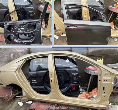

Re: Elio Type Vehicle Resurection --- AKA the BEX

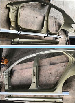

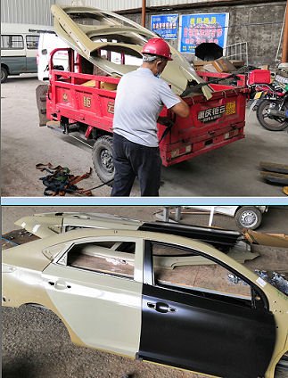

Per Mark BEX :
Parts arrived at the transport depot, got my regular 3 wheeled motorcycle pickup man, and now safely in my factory ...
After my hassles I had with the first sides that were in 4 pieces, boy am I glad I could get these one piece sides
So the fun begins again
- 210818 001 one piece sides 001.jpg (46.12 KiB) Viewed 1695 times

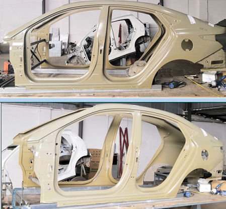

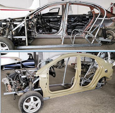

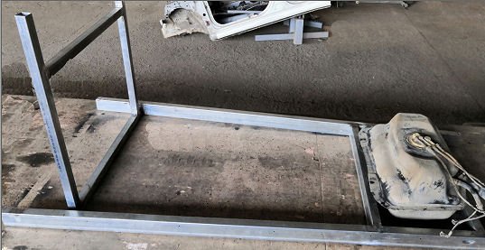

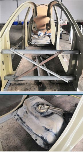

Per Mark BEX :
The comparison here is, it took me weeks to decide and design around how the sides would mount to the chassis, and of course that time included variations and modifications of the chassis design to suit as well ...
This afternoon, took me just a few hours to cut the sills off the new sides, and (temp) rivet the new chassis rails on, simply because I had it all worked out on the prototype, and literally just copied it today, with some minor alterations such as changing to the same size rail tubes as the (potential) Production Partner uses.
Just an example of how much faster this pre-production car will happen, and the weather is finally stating to cool, thank goodness for that ..
I must admit I grimace when I start cutting brand new parts up! first picture
Well she's up on the bench ... second picture
Imagine my surprise when the temporary crossbrace I made up to hold the previous 2 sides together, fitted straight onto these sides! I pulled the fuel tank out of the donor car, you can see it's rear raised in the background, and it's an excellent fit, that's one more thing "off the shelf", and one less headache for me ....third picture
The measurements looks to be 1000 exactly from the bottom front corners of the front doors, and 800 from the bottom front corners of the rear wheel arches, as per the arrows. .... fourth picture
- 210818 001 one piece sides 002.jpg (28.17 KiB) Viewed 1661 times
- 210820 001 on the bench 001.jpg (48.78 KiB) Viewed 1669 times
- 210820 002 brace and fuel tank 001.jpg (39.04 KiB) Viewed 1669 times
- 210820 003 measurements 001.jpg (32.05 KiB) Viewed 1669 times
0 x

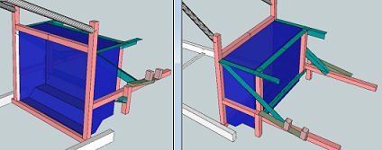

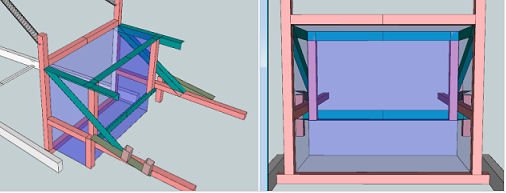

Per Mark BEX :
Sometimes I have big wins that don't look so obvious.
The footwell is the area under the dash where your legs and feet go, of course where the pedals are.
I have been on the computer all afternoon, and moved tubes around to figure out how to make the footwell literally a 5 sided box, that can be built on the bench, and simply slid into place from the driver's area.
It's a real win to make life easier. The theoretical "box" is shown in purple here, though in real life it will need some holes, humps and bumps to mount various components, not least the brake master cylinder.
- 210826 001 5 sided footwell 001.jpg (19.9 KiB) Viewed 1598 times
- 210826 001 5 sided footwell 002.jpg (16.79 KiB) Viewed 1598 times
1 x
